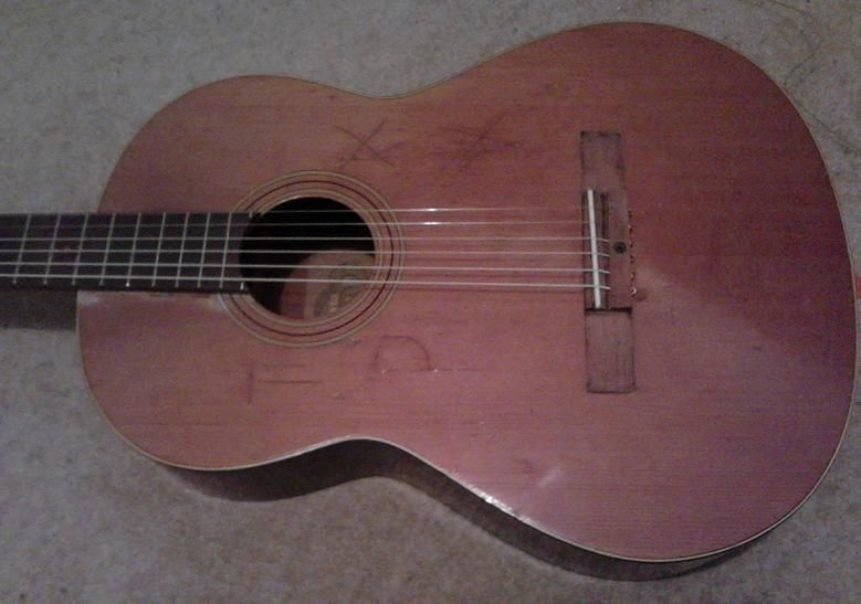

Post by deleted » Sun Dec 22, 2013 12:12 pm
Took forever to set this up. I ended up angling for a steel compensated slot.
The E slot on the nut was worn plus the 11th fret had lifted slightly high, both causing intonation issues which added to the confusion of setting the saddle.
I used a 3 and a bit mm saddle, which still needs some compensation for the B string. I would probably be better off using a thicker saddle but didn't have one at the time.
Don't know what classical strings will be like with this set up - might check that out later.
Here it is:
You can see the scratches in the top. Any idea how I might reduce these?
