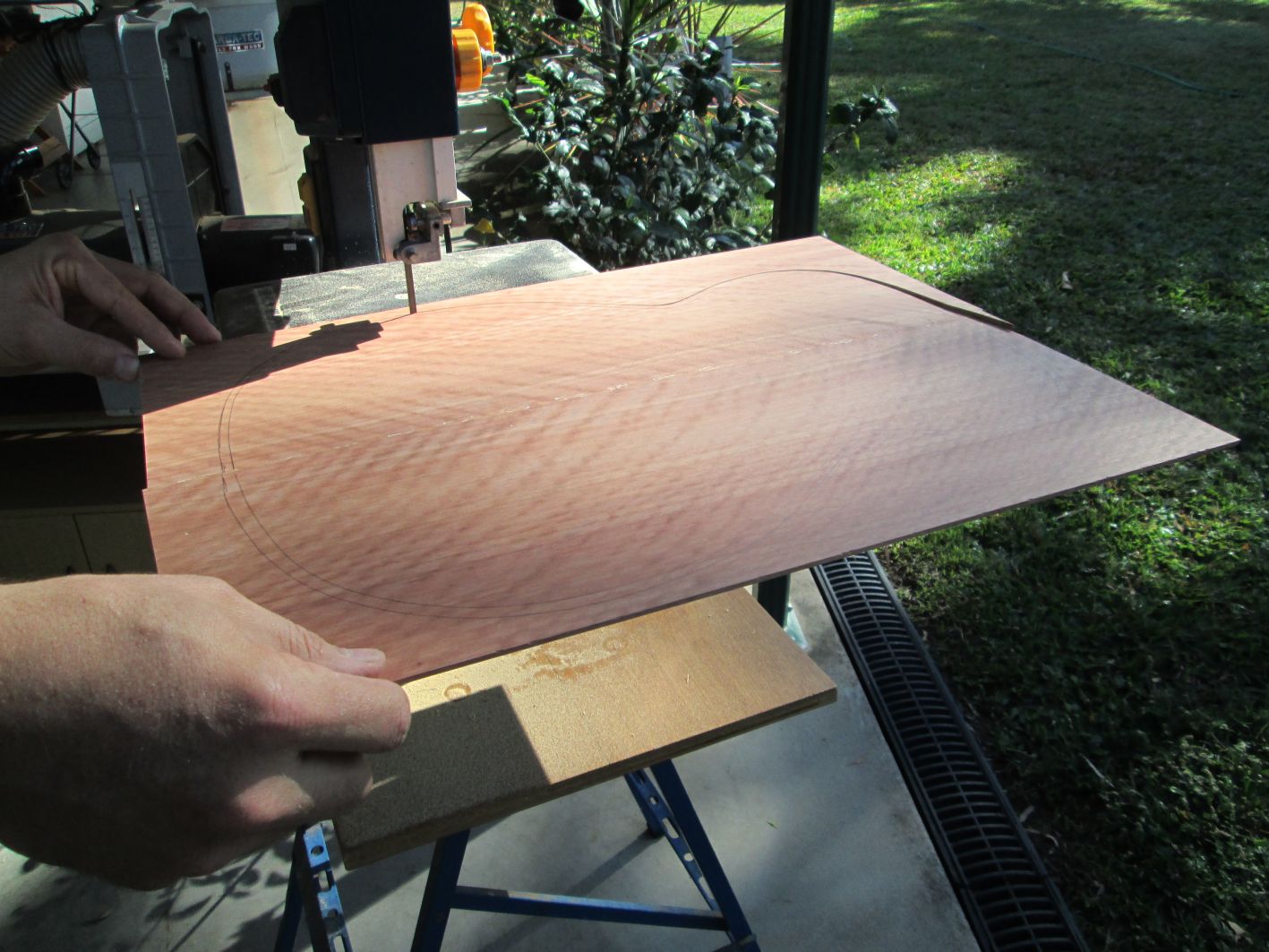

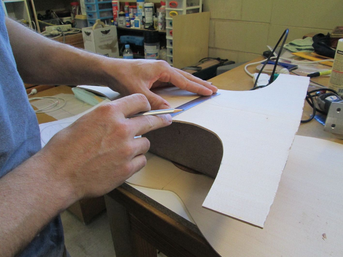

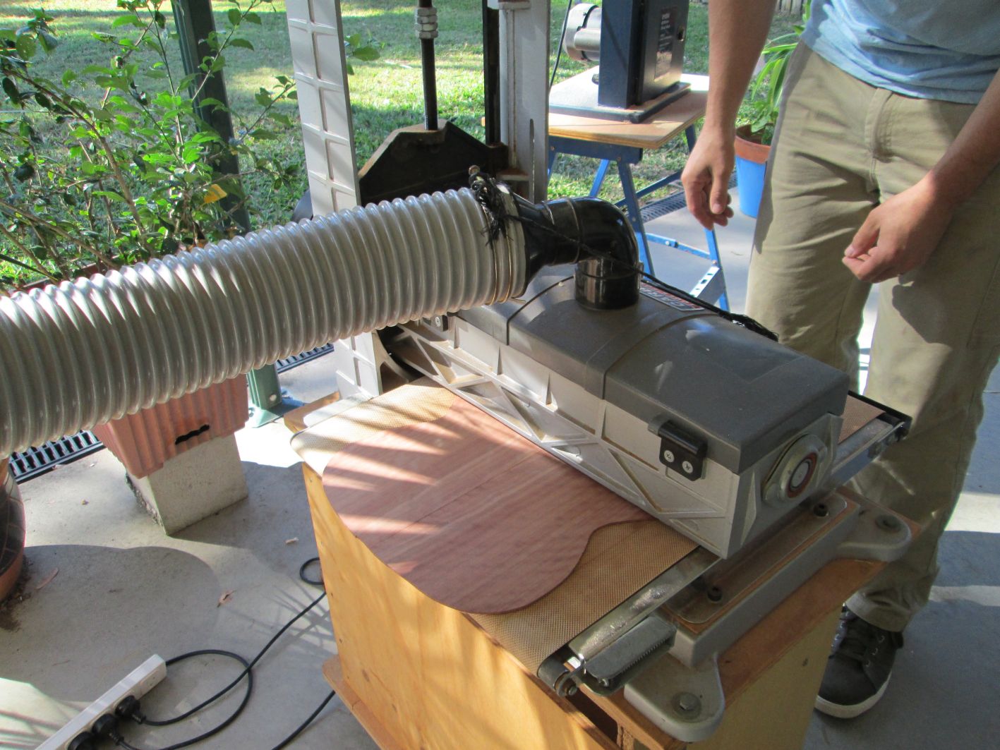

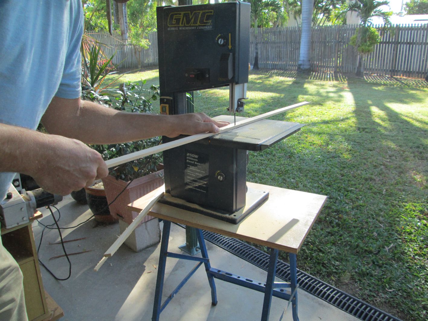

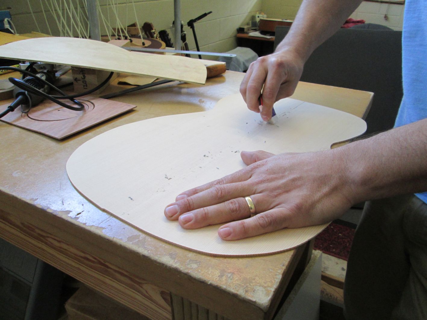

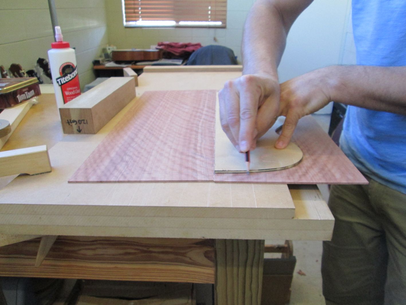

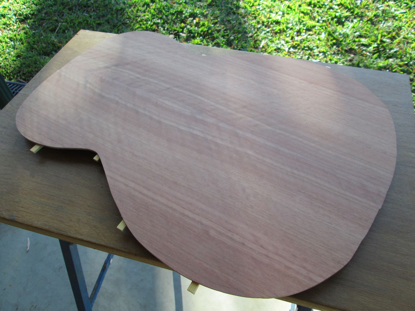

Hi to you all,

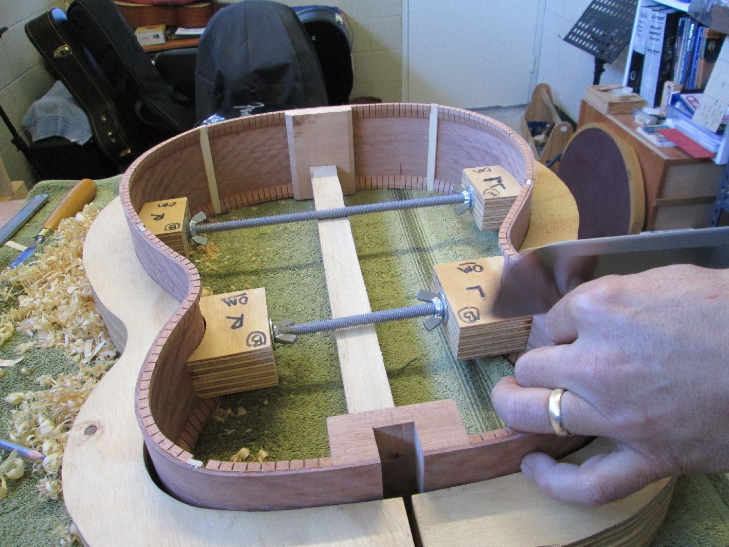

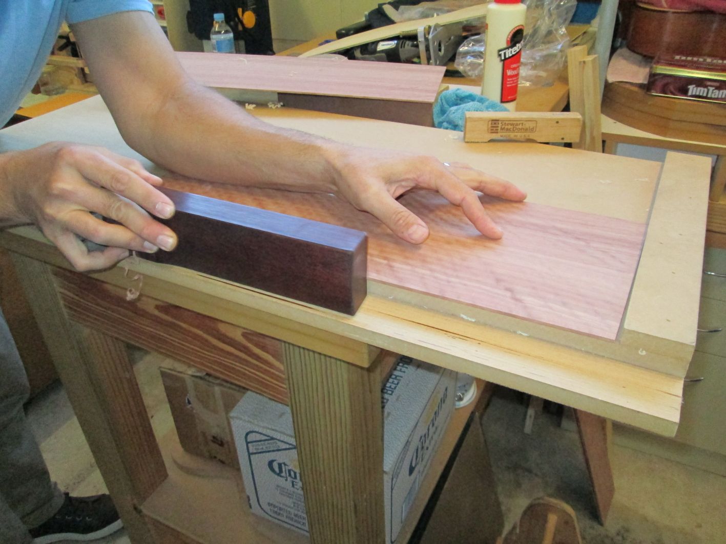

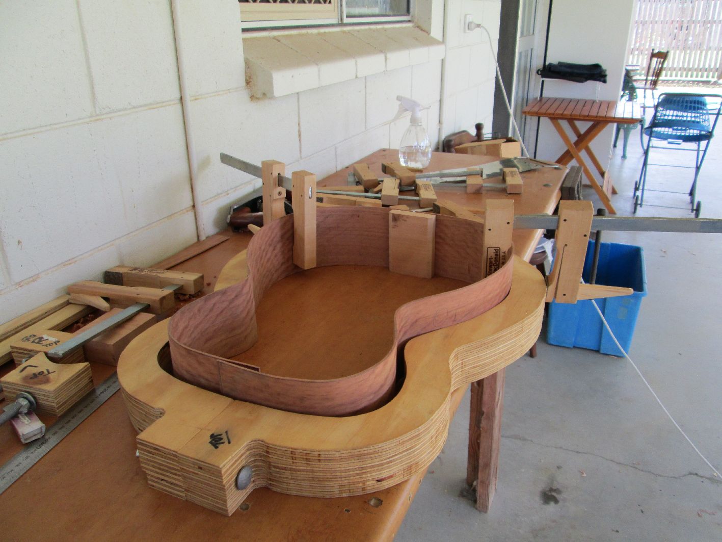

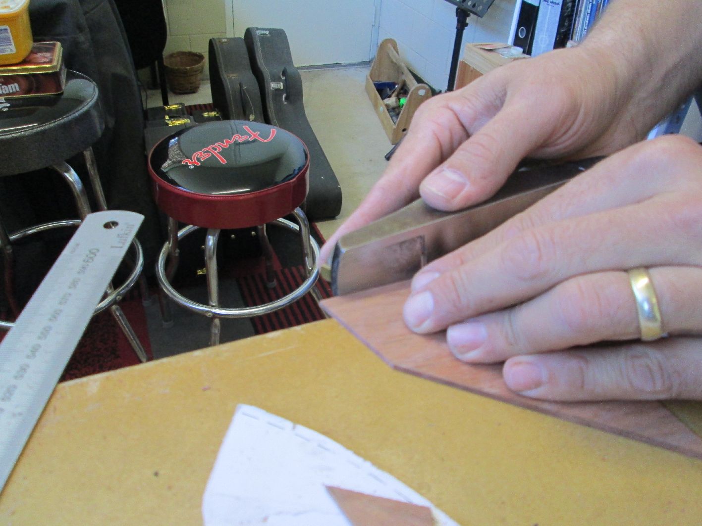

SESSION 1

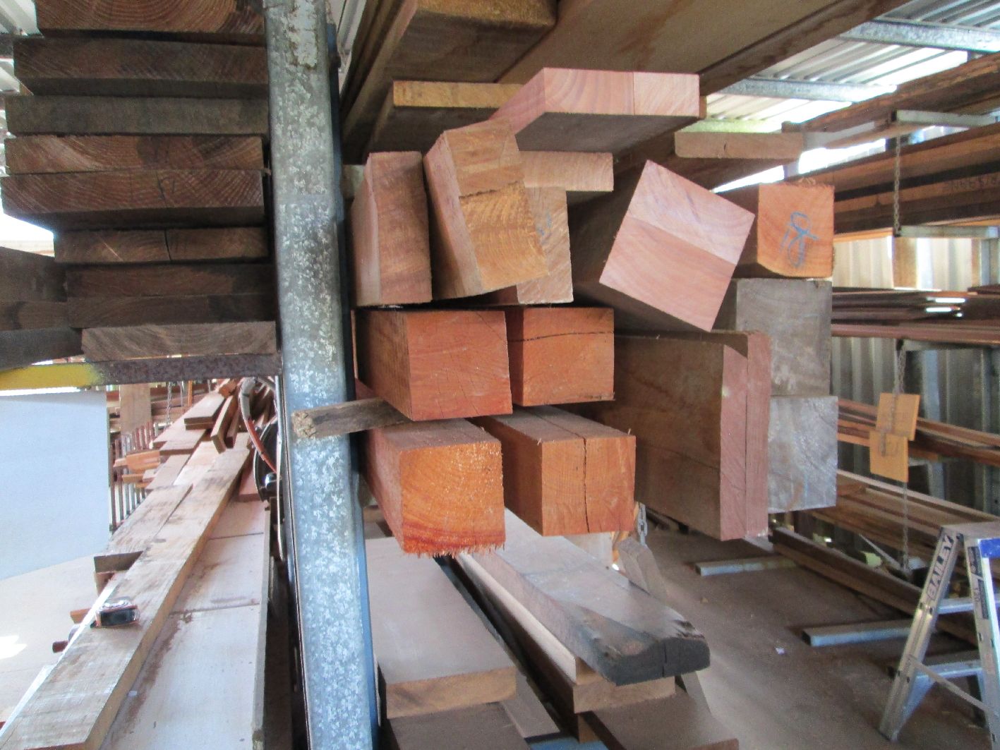

This is a first guitar build thread of my friend and business partner Joel (forum handle timberfreak). Joel build his first Ukulele as built our during our first Ukulele Building Course held here in Townsville recently. Joel sliced up some wood for his first guitar build on Saturday and he sent me an email and said its Melaleuca Al, what do you think? Hmmmmm, I remember back on the dairy farm 40 years ago we planted these trees as fast growing shade and wind breaks for our cattle. Anyway, he arrived last Monday morning with this set of Melaleuca or common name Paperbark. Joel may chip in later with the botanical name.
So I have never used this before and first impression is it feels like Myrtle. It is close grain and will not need pore filling. Tap tone is nothing like Myrtle which can be a bit dead but more lively and nice sustain. It is heavier than Myrtle but not so stiff across the grain. We took its thicknesses down to about 2.8 mm. Bracing is Oregon which will be ok for the back and a first build. We will use spruce bracing for the Sitka top chosen for this build.
The build is an OM non cutaway using the Scott Antes plan but we will modify the bracing thickness a little and use a soundhole patch. Other than those changes pretty much off the plan. The neck is going to be a one piece Queensland Maple bolt on.

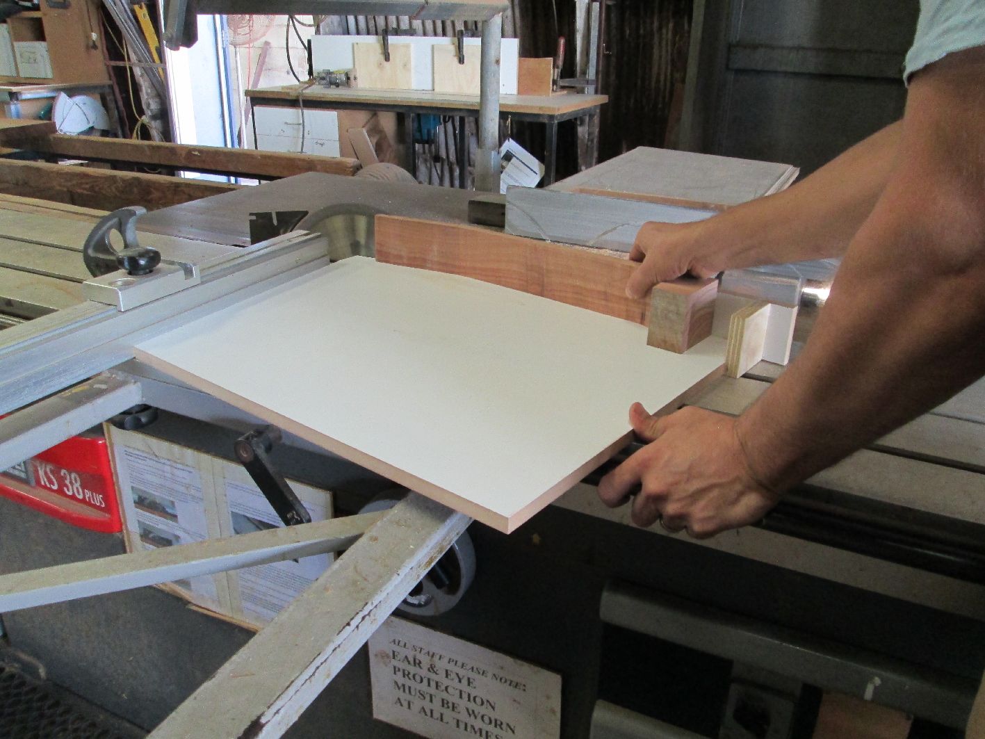

Here are a few pictures of the first four hour session Monday morning:
to be continued.......

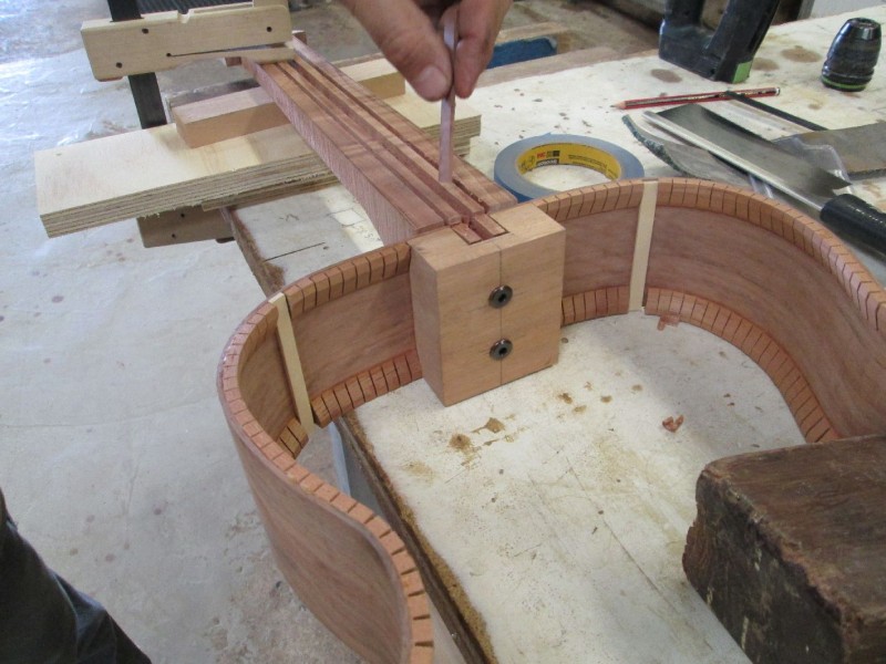

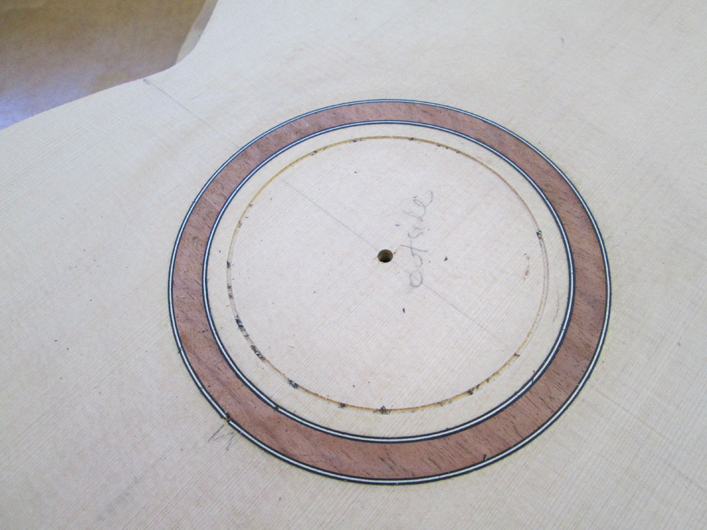

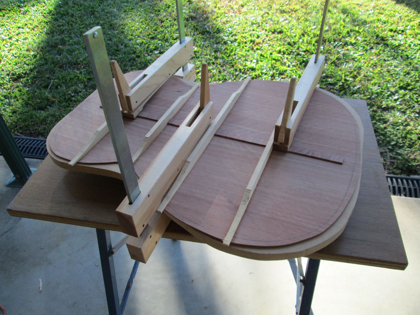

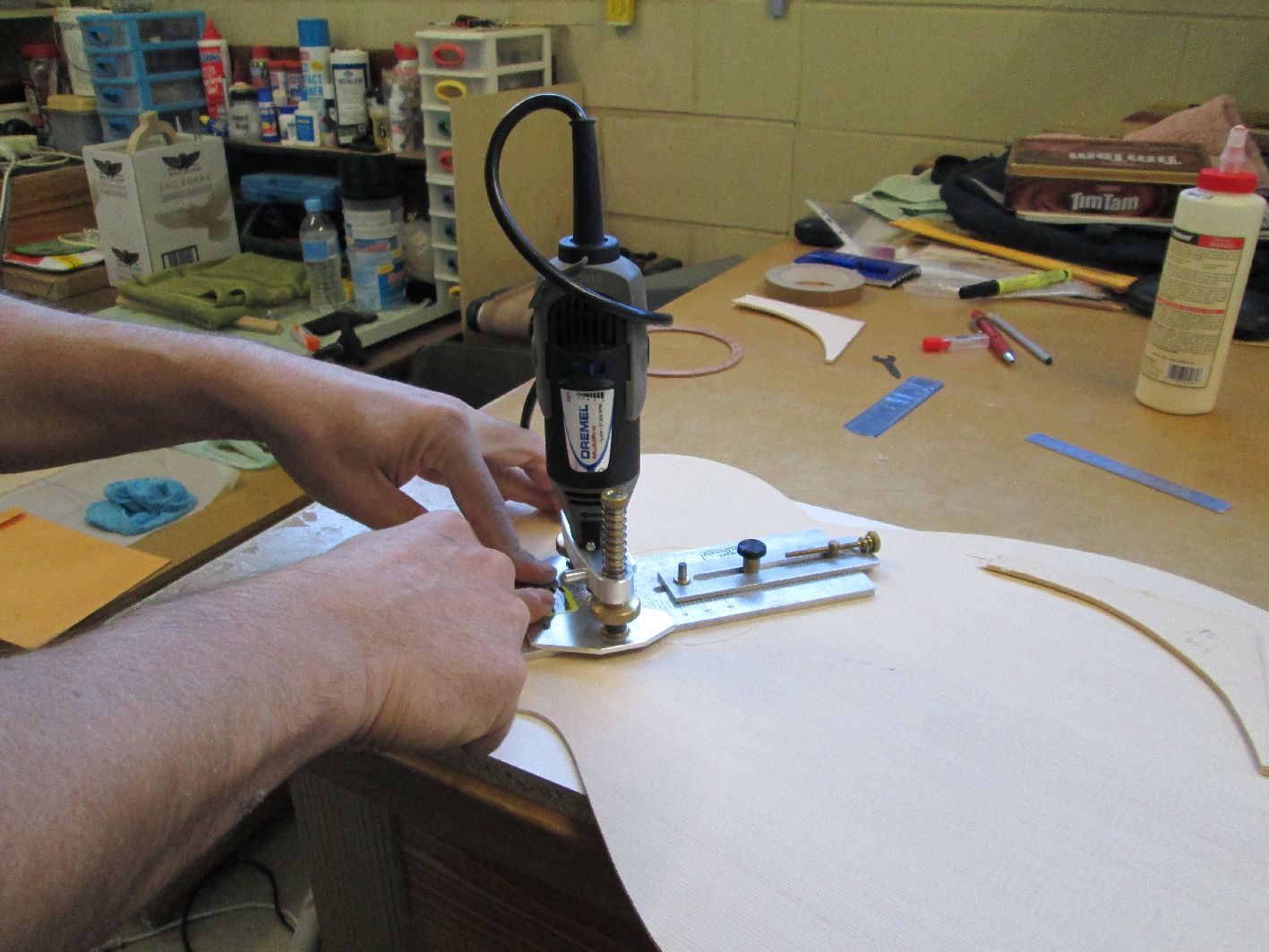

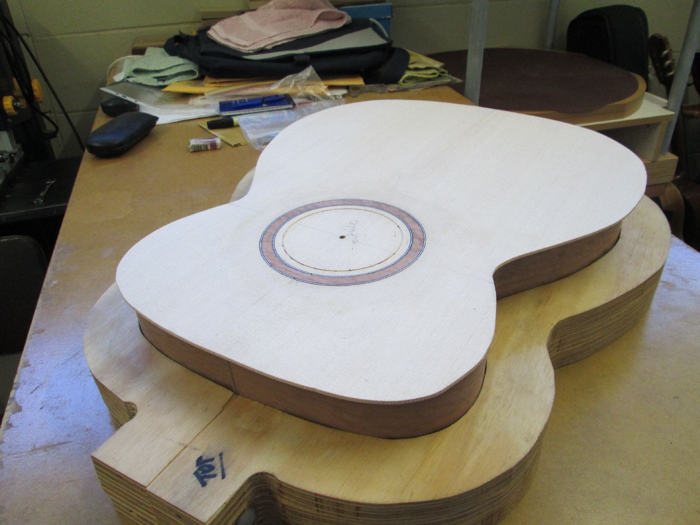

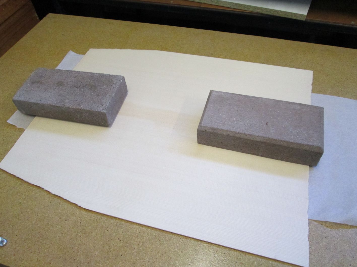

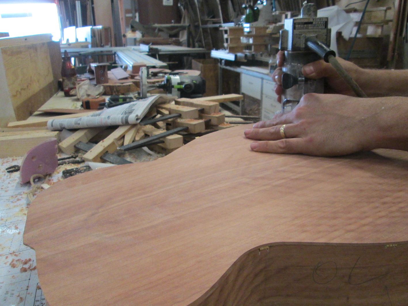

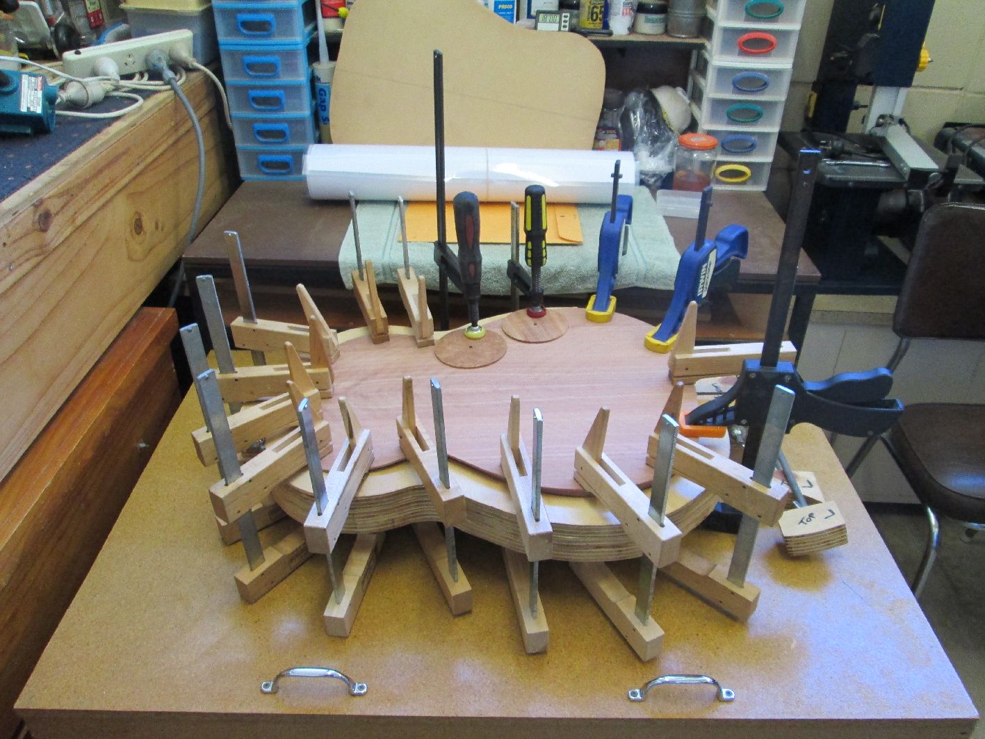

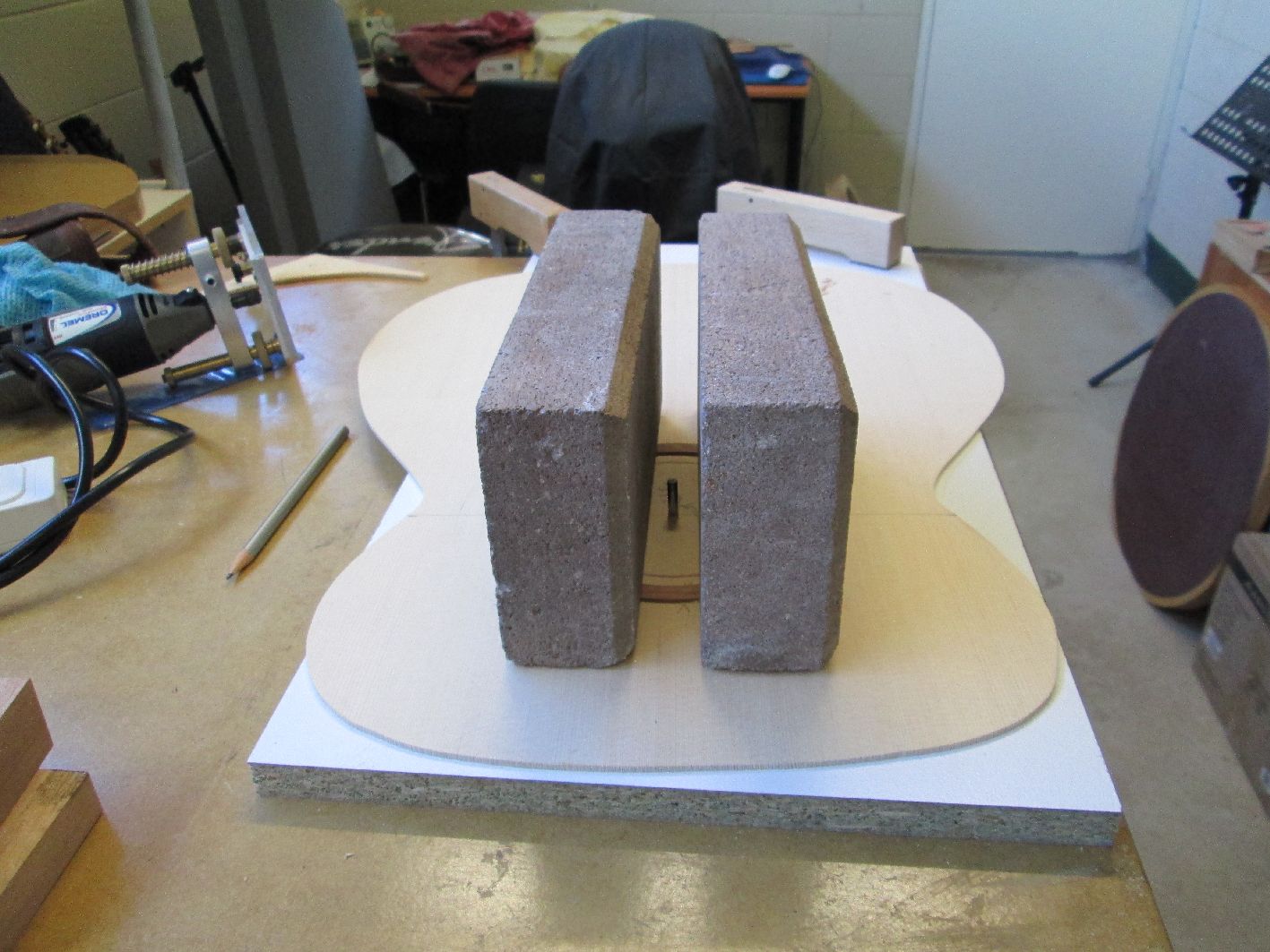

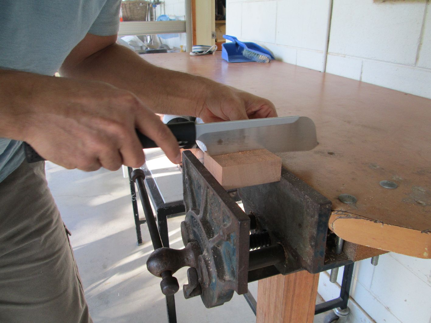

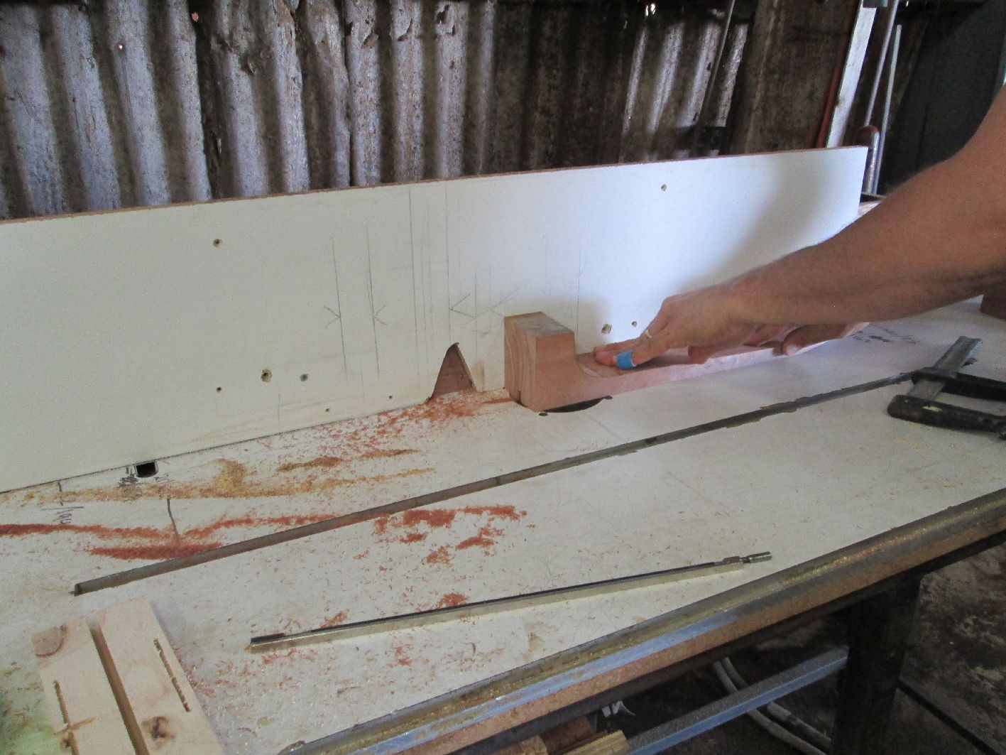

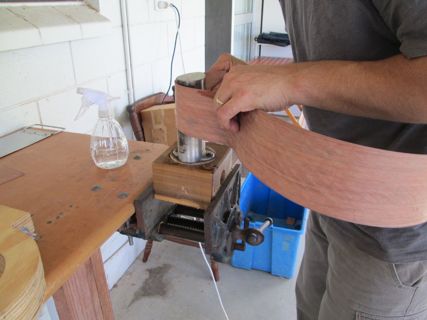

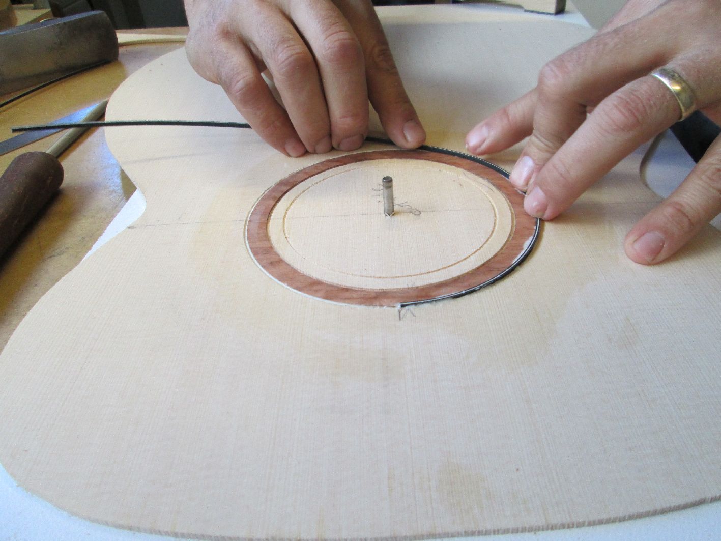

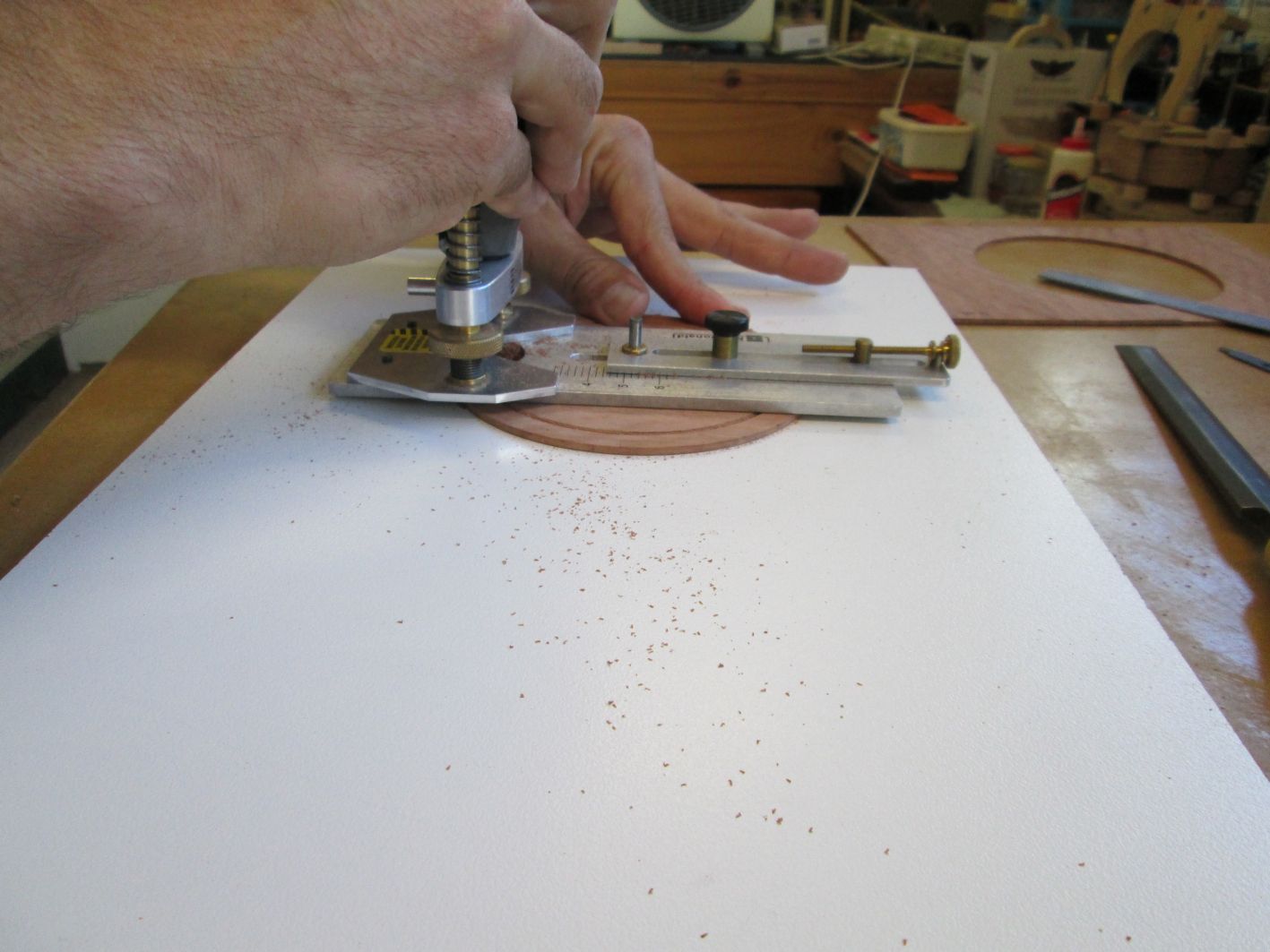

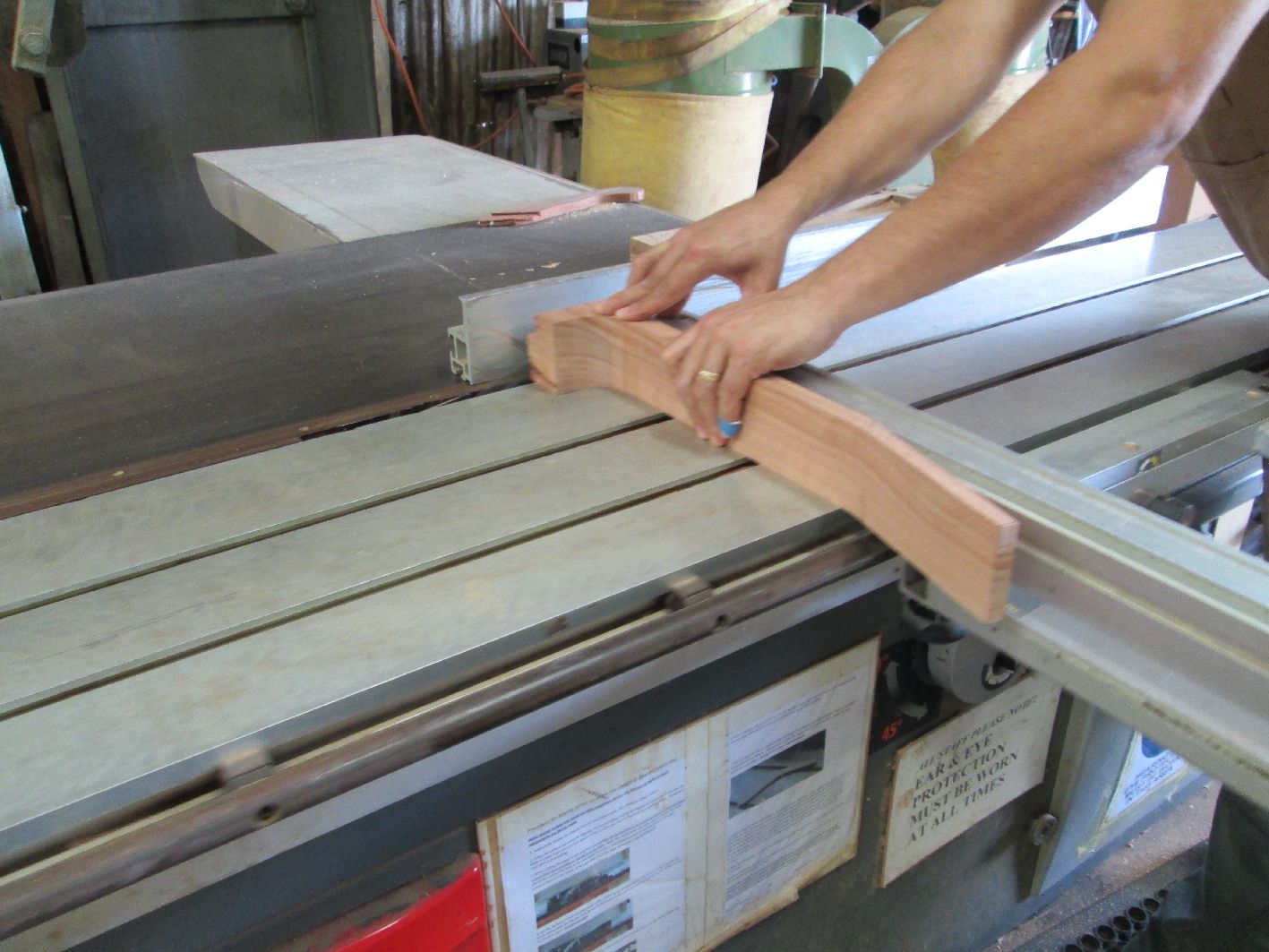

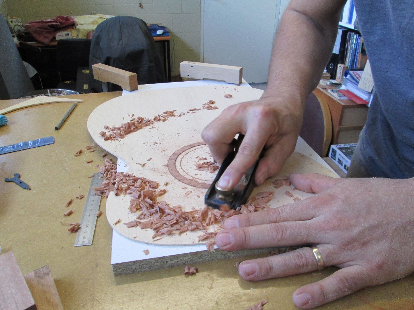

SESSION 2

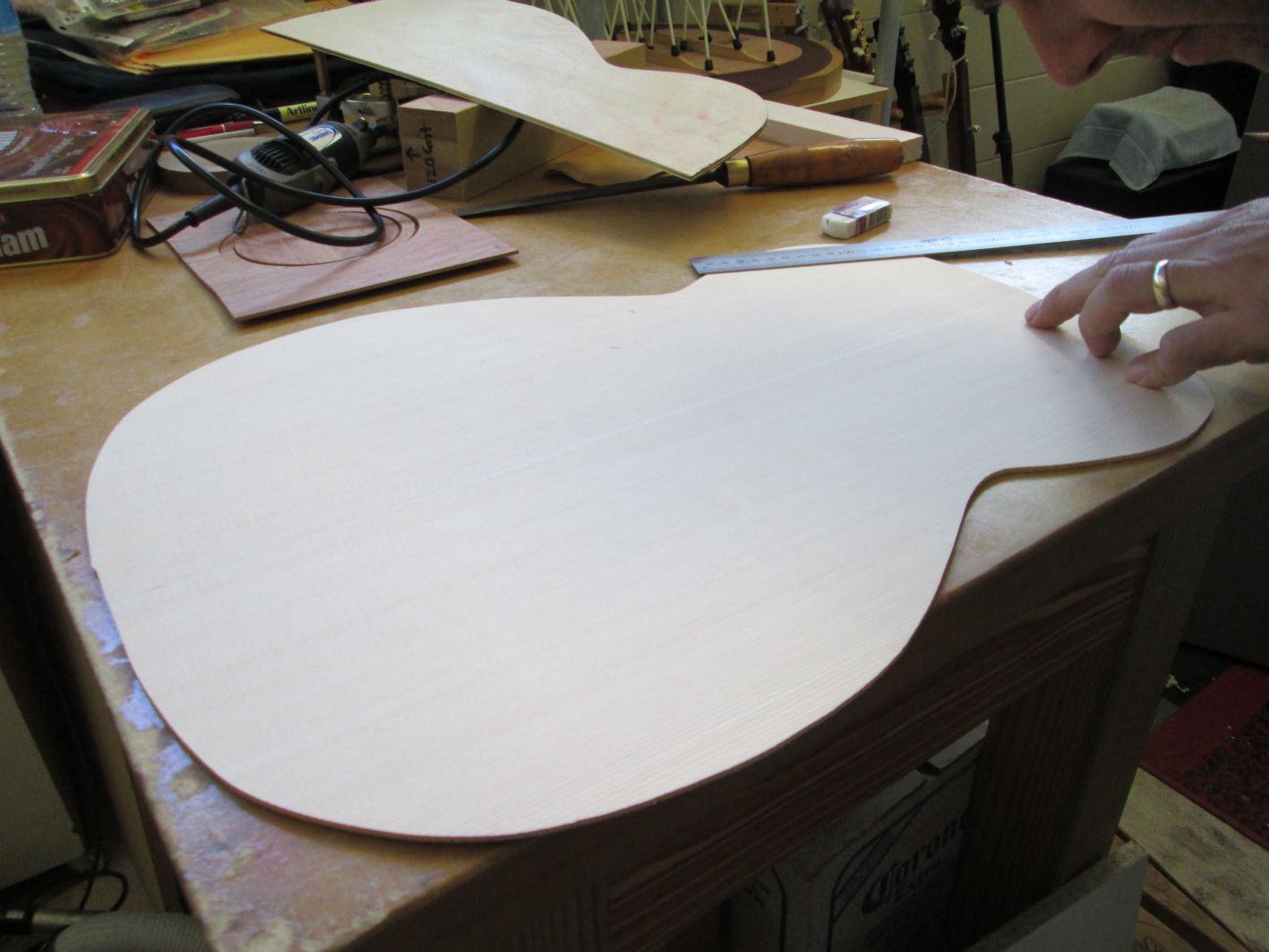

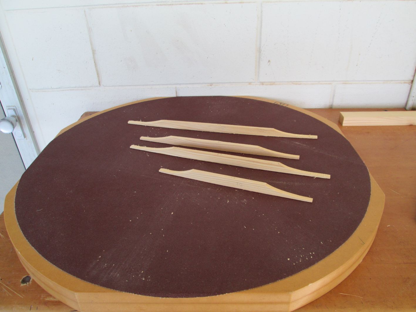

Another four hours this morn spent on the OM. Started out marking the sound hole and cutting channels for a Paperbark rosette Joel made last week. Using some off cuts from the top he joined two pieces for the sound hole patch, glued in the rosette and then cut the channels for the black white black purfling gluing those in a little later. Sliced up some bracewood for the transverse and the x brace from some Sitka spruce. While the rosette dried Joel started on the bending of the sides. The wood bent with ease as expected as it feels so similar to myrtle and sassafrass. Joel squared up the side ends with a new saw he has been dying to try out. Damn him, I gotta have one of them saws now. Joel worked on the rosette with his trusty block plane and leveled it to the top. He then measured out, cut out and drilled a centre hole in sound hole patch. Next job was to cut the lap joint in the x braces. Once that was achieved he then shaped the edges of the soundhole patch with the block plane so they matched the arc of the x brace. The transverse was cut out and scalloped on the bandsaw and the bottom of the brace was sanded dead flat. Next the tail block was glued in and the top was put in the go bar to glue up the soundhole patch and transverse brace. Had to use the aircon this morn as we had a very heavy fog and dew this morning. I will put both the top and sides in the dry box tonight. Another good mornings progress on the Paperbark guitar.
Here are a few pictures:
To be continued:
To be continued:

Thanks Alan and hi all. Must admit I'm finding this guitar building thing a lot of fun. The melaleuca is locally sourced. We milled it from just down the road from a property at Cape Cleveland. The top of the tree was screwed off during cyclone yasi and we managed to get a few nice pieces out of the base. It's actually the first time I've used this timber for anything and I love it. Will definitely use it again if I can get my hands on some more.
Cheers, Joel

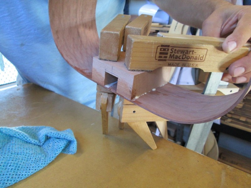

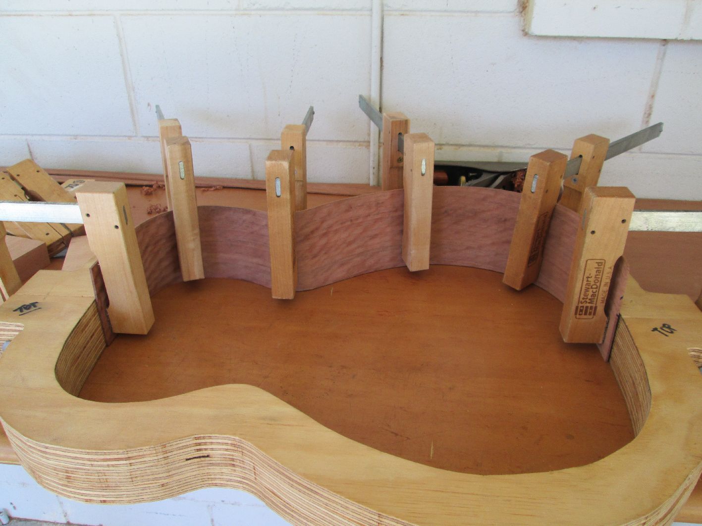

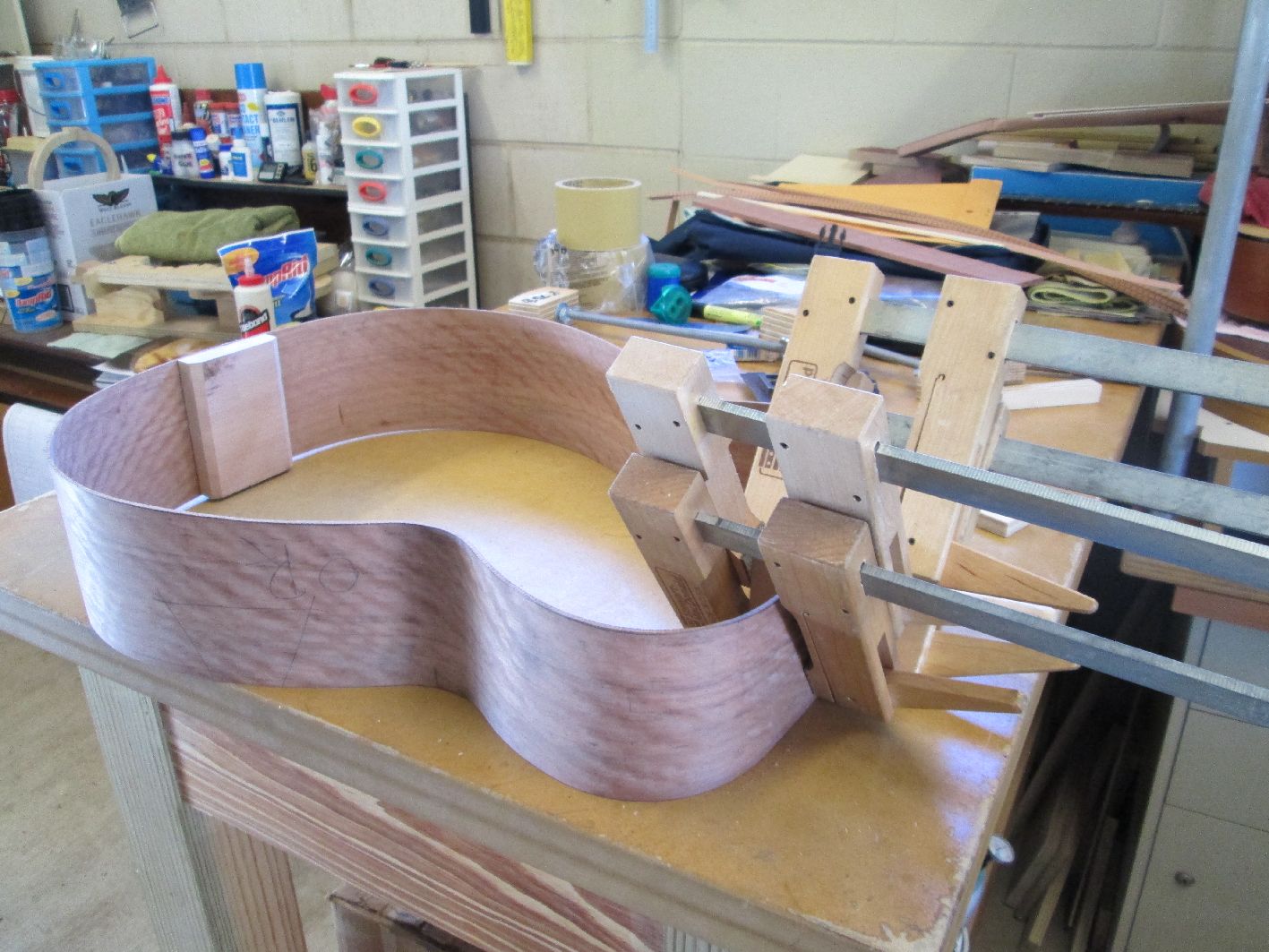

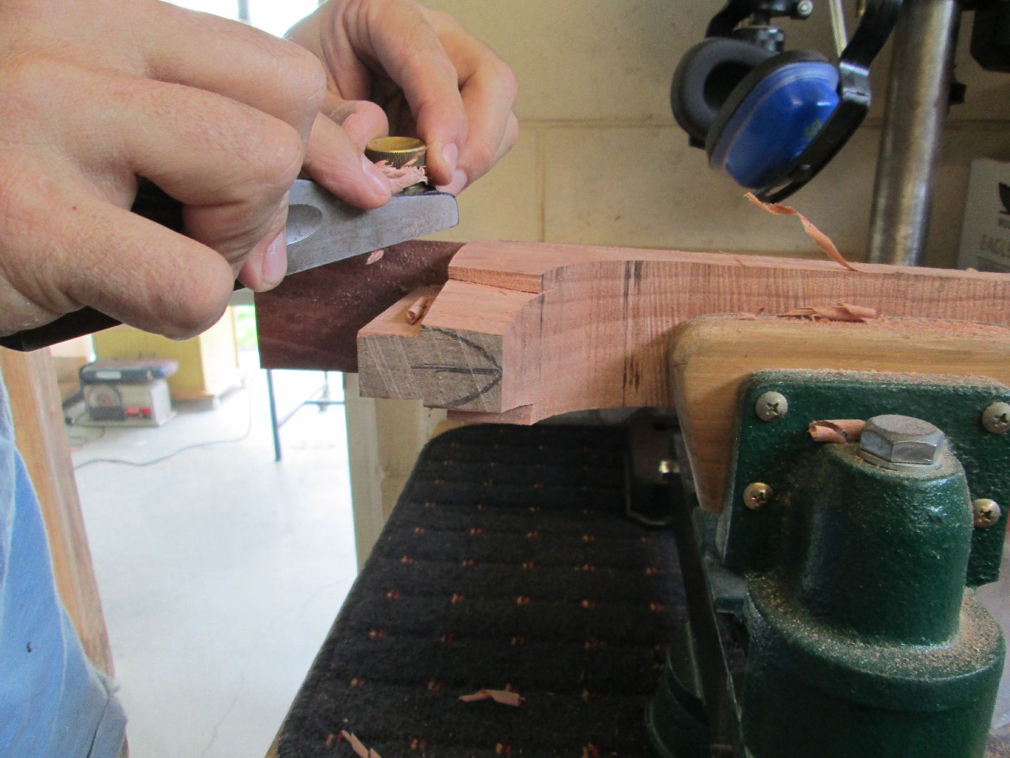

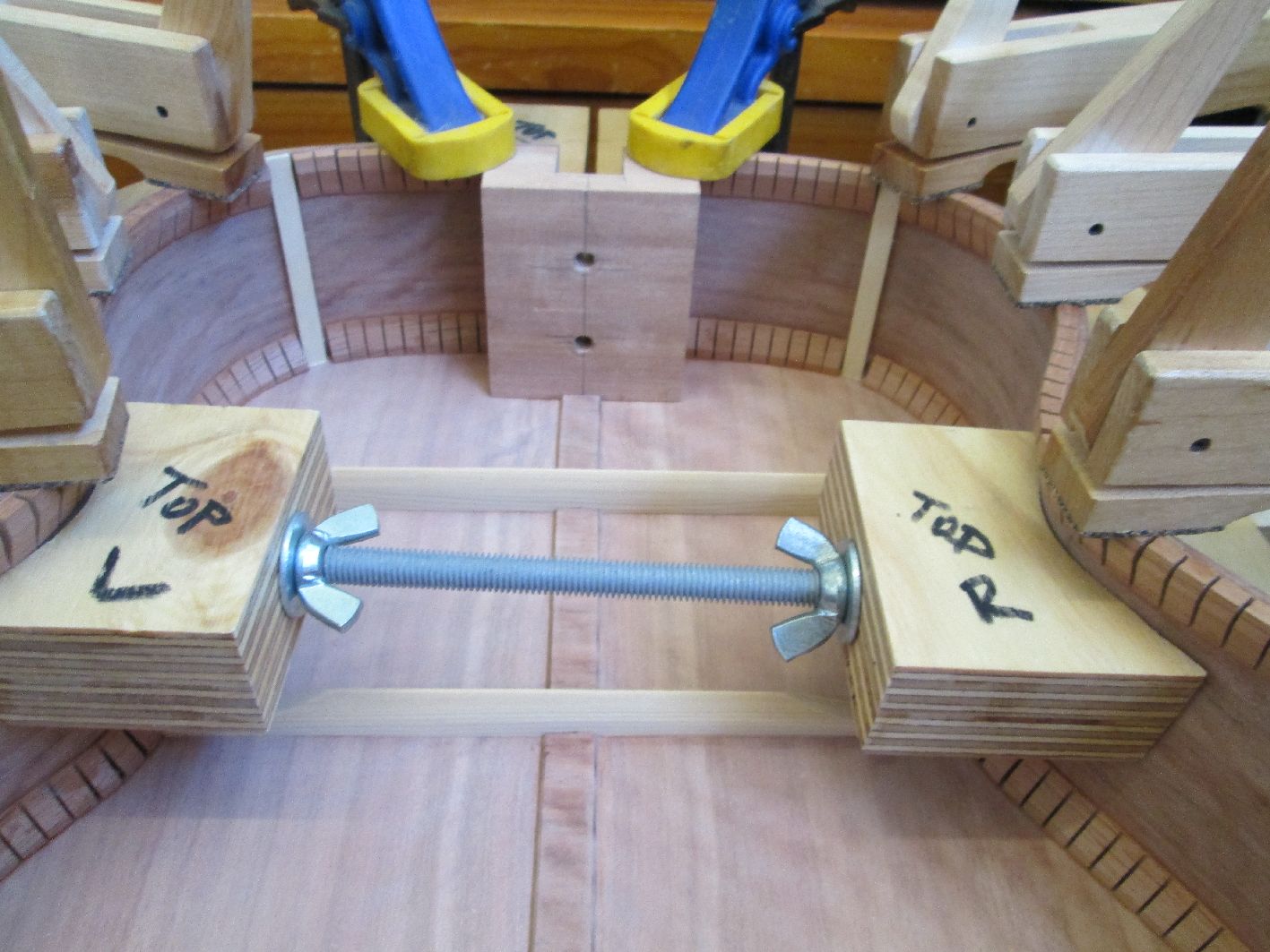

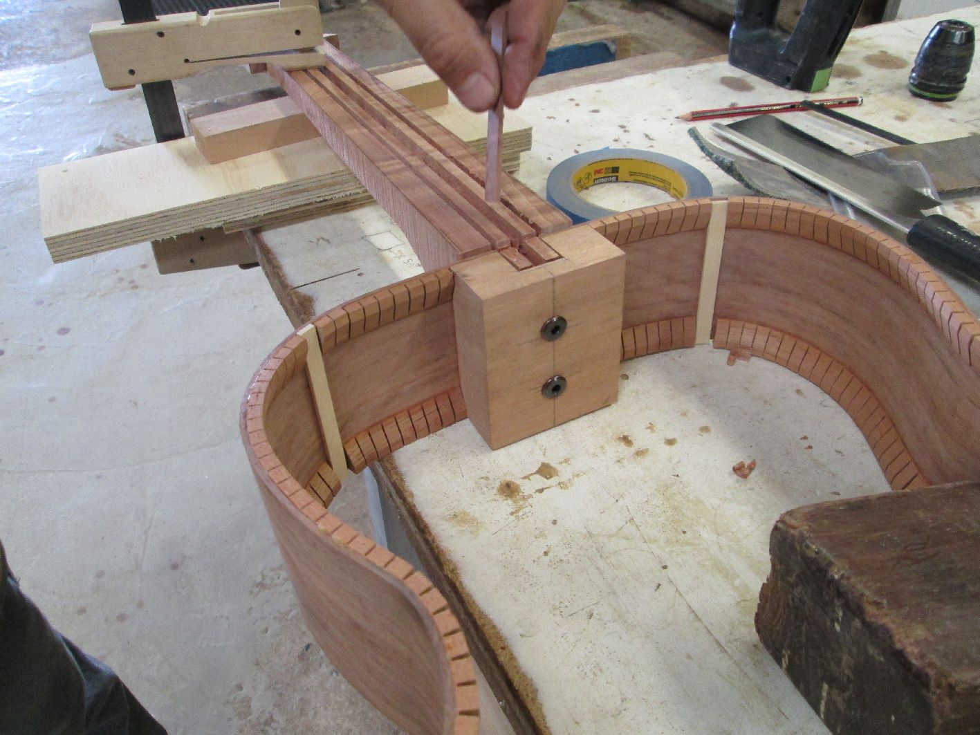

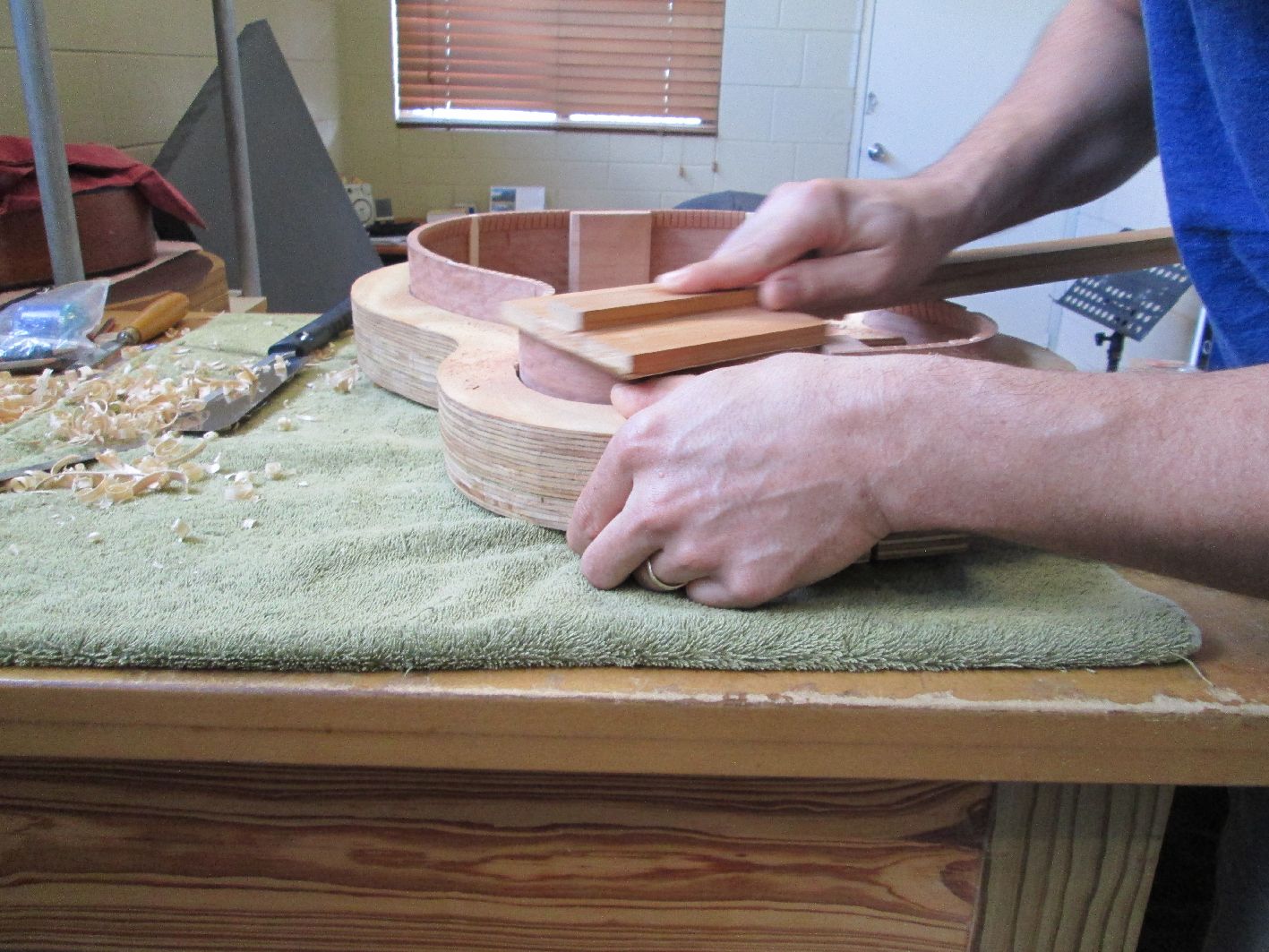

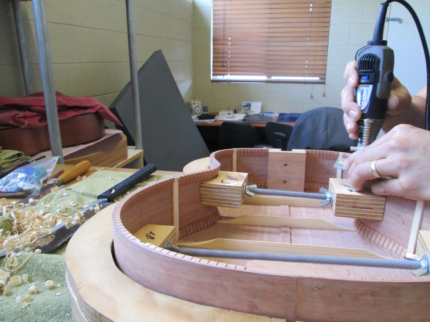

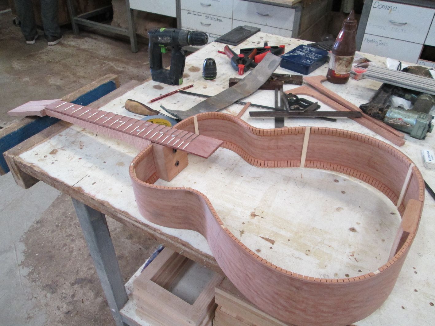

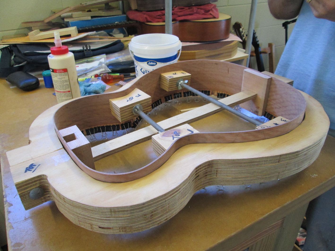

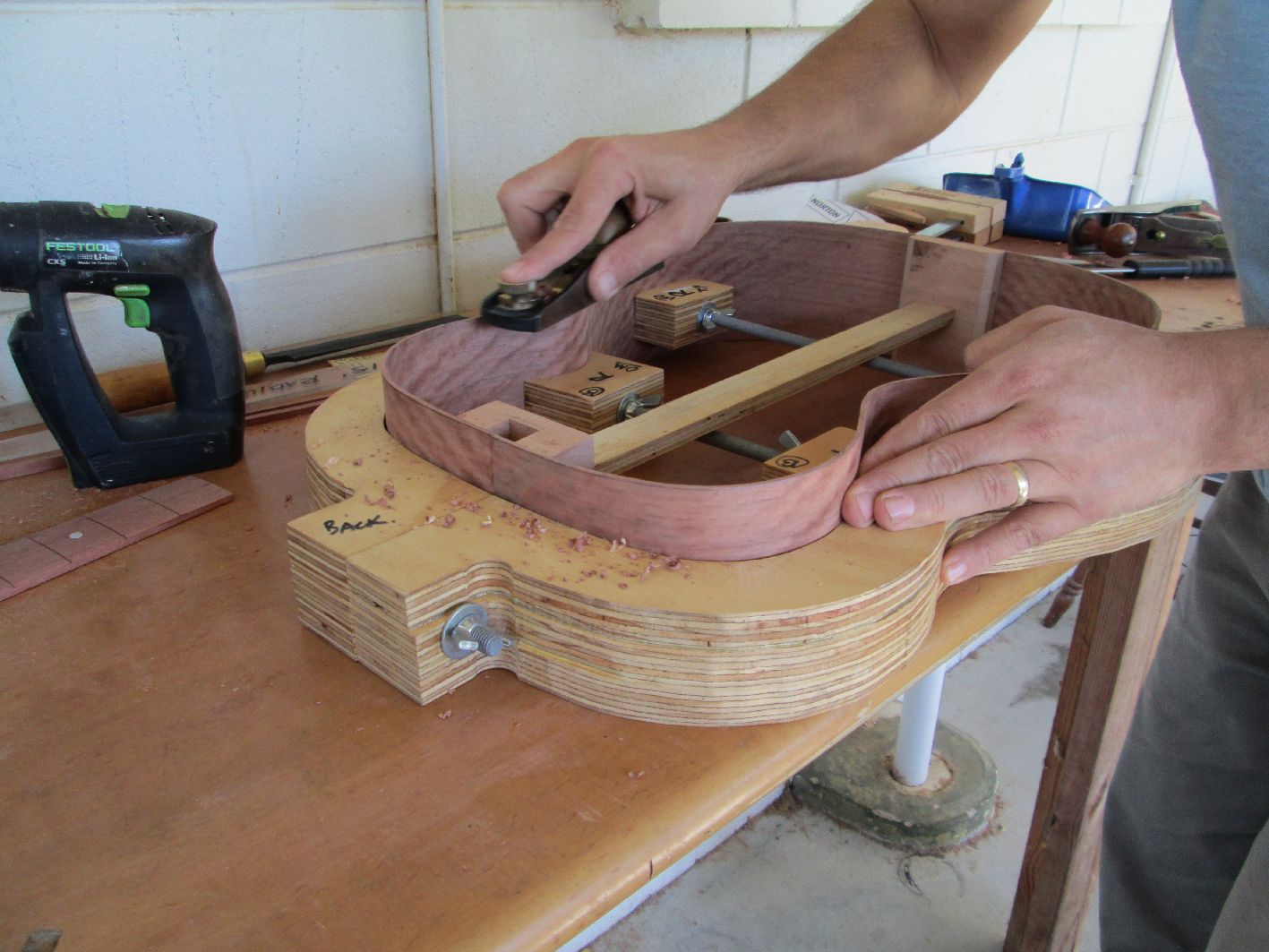

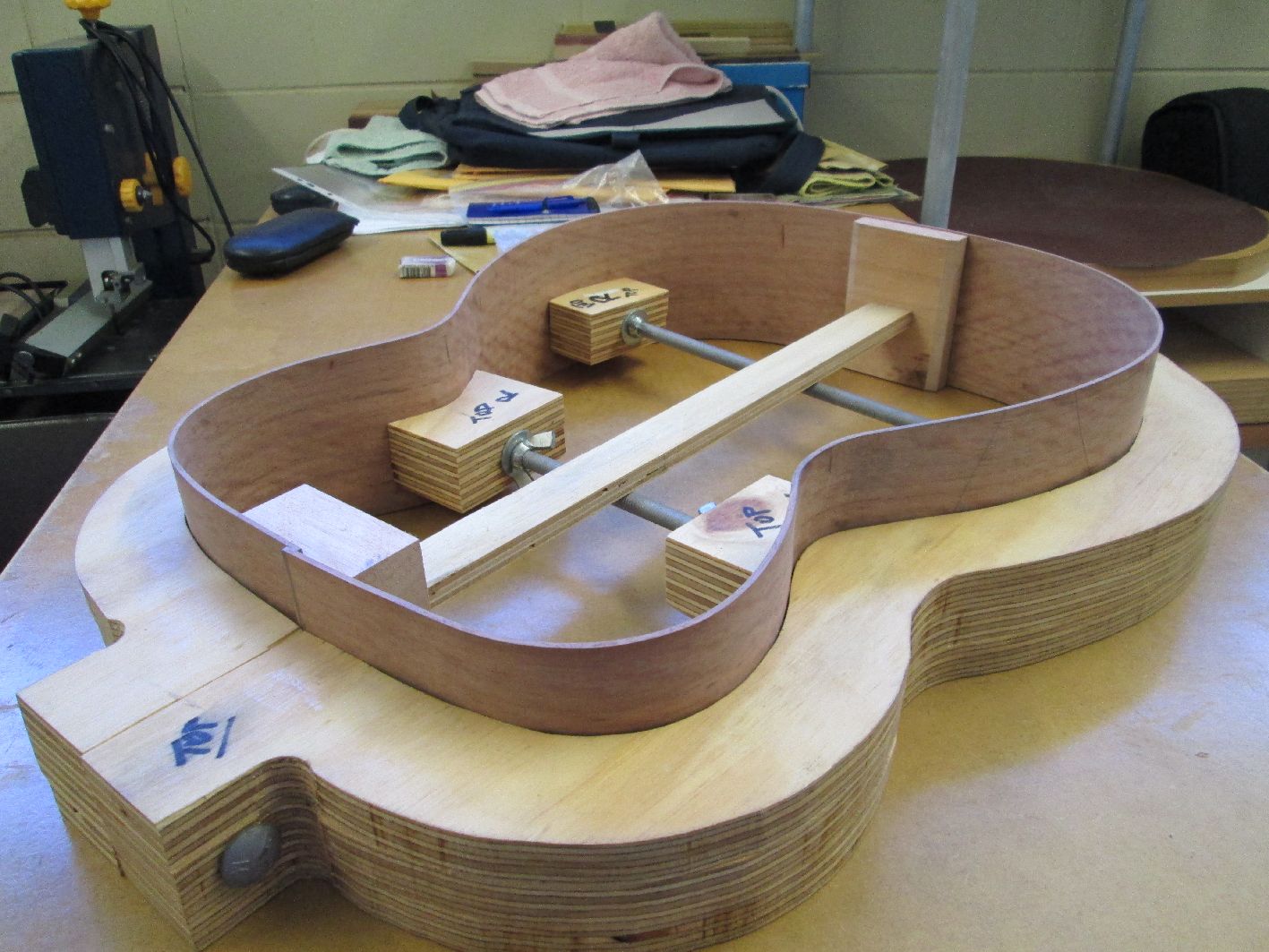

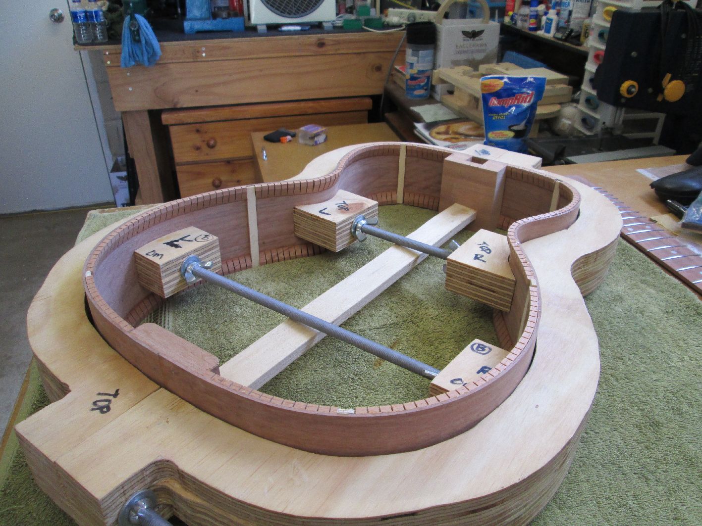

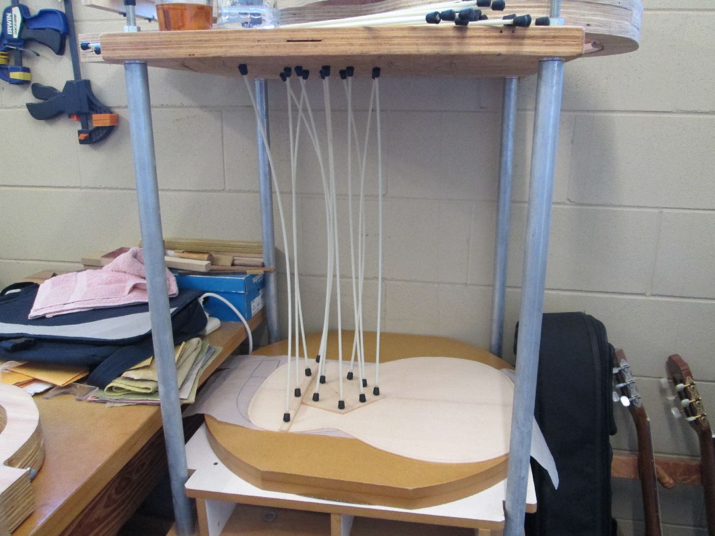

SESSION 3
Good progress again this morning and the humidity is perfect today.

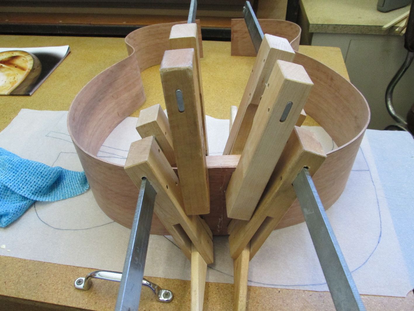

Cut the mortise into the neck block, glued it in for a bolt on neck join, leveled, profiled the sides where the back will join the rim, glued in the linings and side supports. The fingerboard is Bloodwood and it came from the same property as the Paperbark. Nice light figure and red colour about the same weight as some of the Desert hardwoods so it is a little thinner. Joel inlayed the pearl dots, groved the slots, removed all saw dust from the fret slots and pressed in some medium frets.
Some more progress pictures for you:

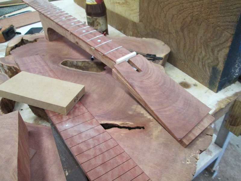

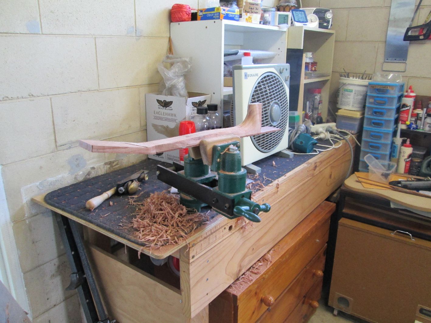

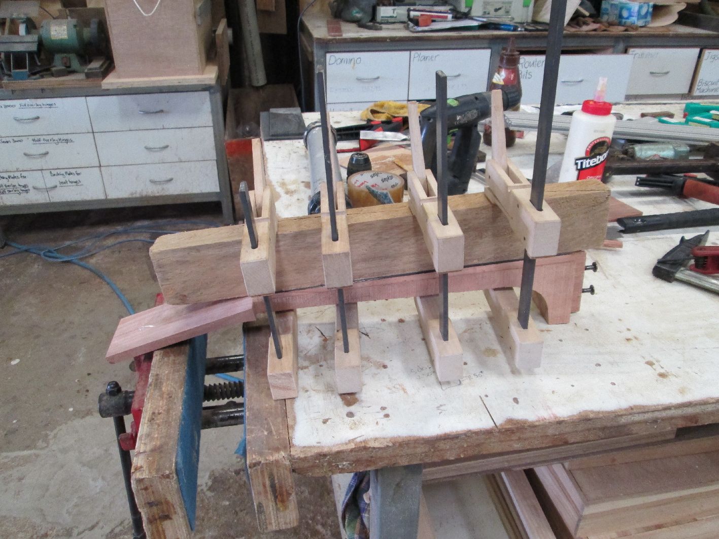

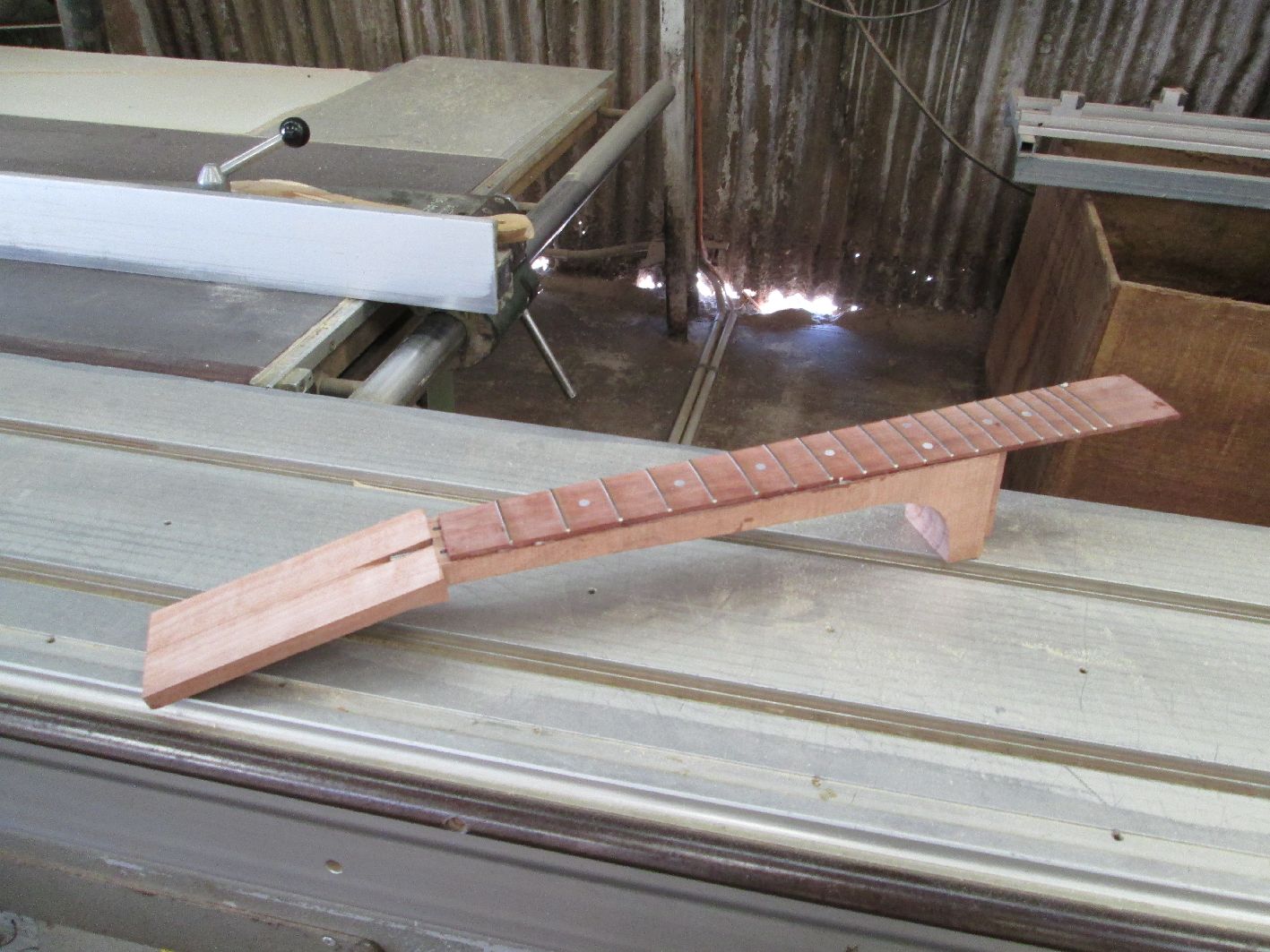

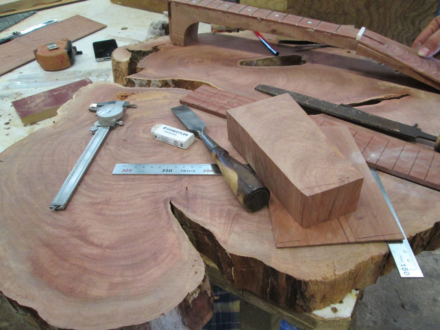

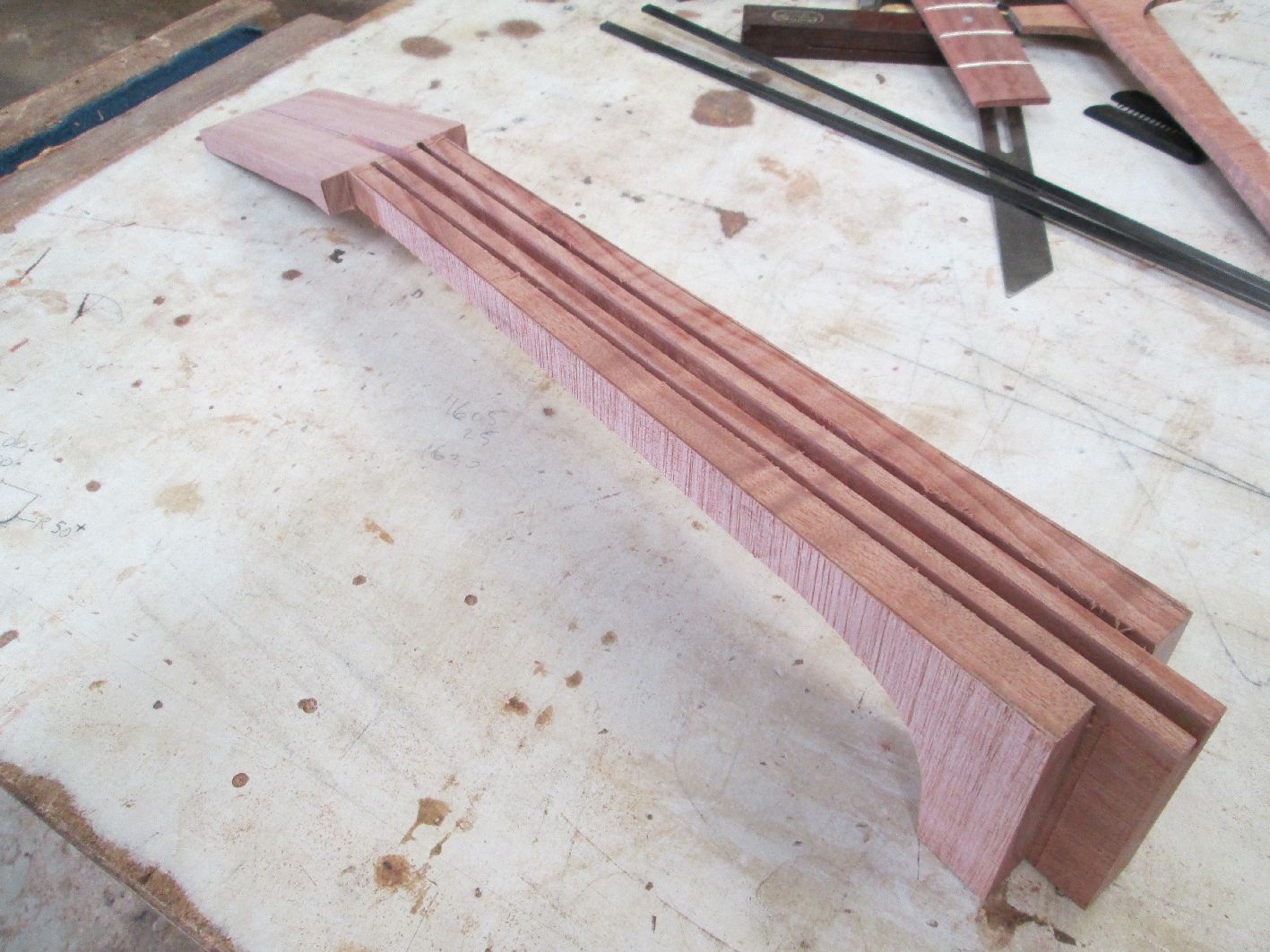

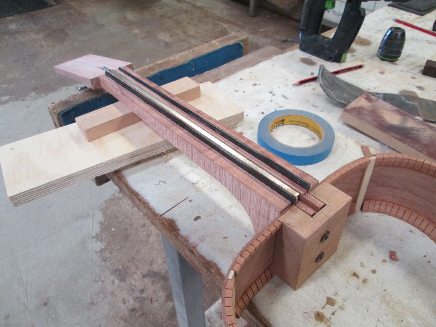

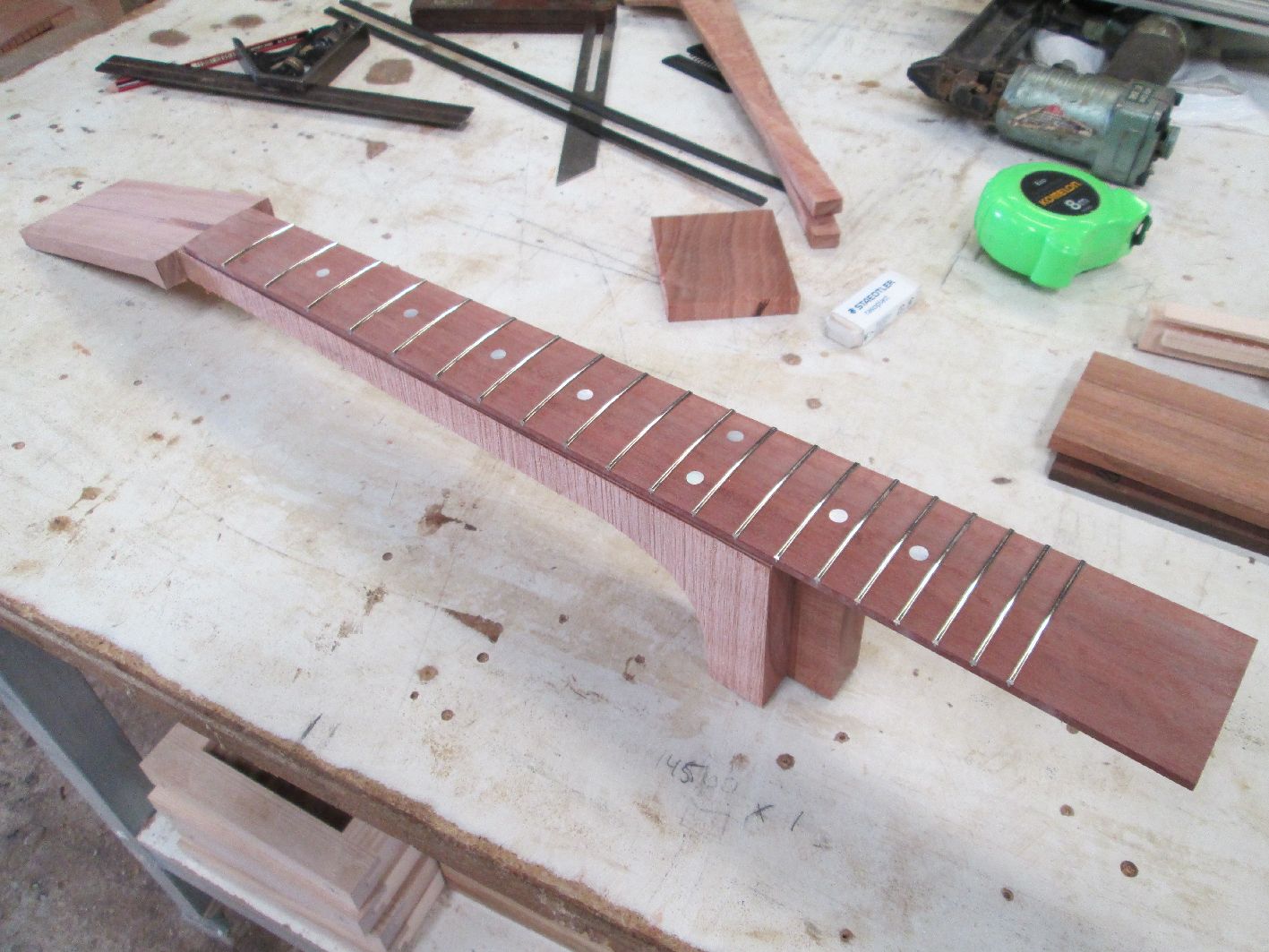

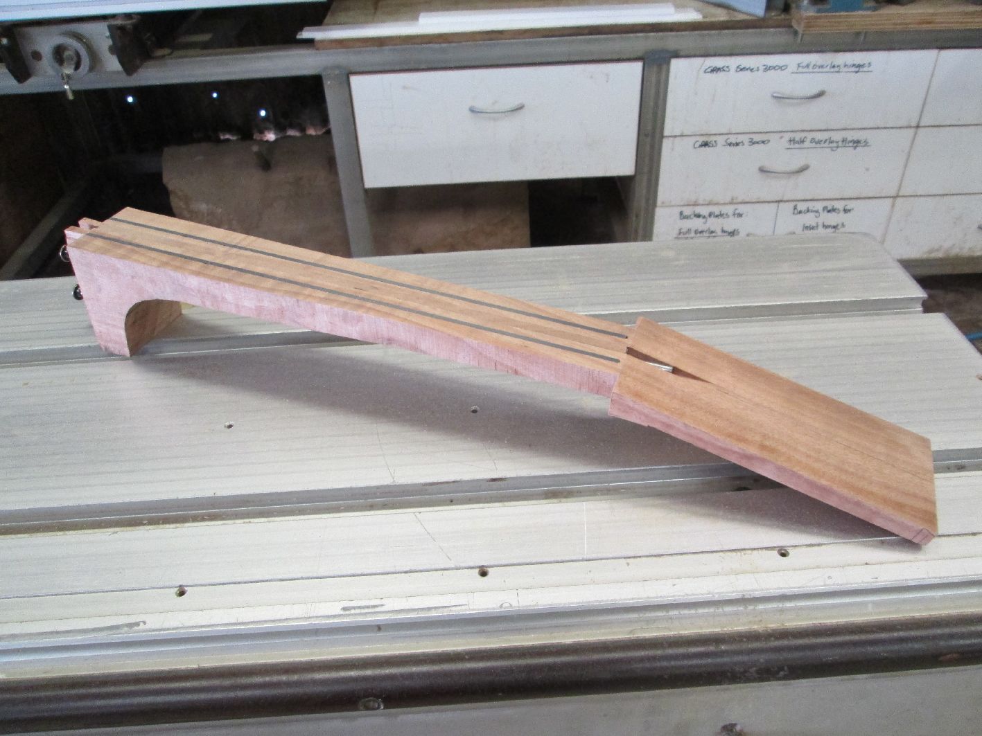

SESSION 4
This morning Joel spent four hours on his build at the Kingfisher workshop. The Silkwood guitar neck blank was cut out last week and today has the truss rod channel cut, neck stiffeners channels cut, head stock face leveled, profile cut out, truss rod carbon fiber stiffeners glued in and a filler cap glued over the truss rod. Joel also cut out the neck tenon, drilled the bolt holes in the neck and neck block and cut out the excess side material covering over the mortise. He also leveled the sides of the frets and filed the bevel on the fret ends.
Beautiful work today and here are a few pictures.

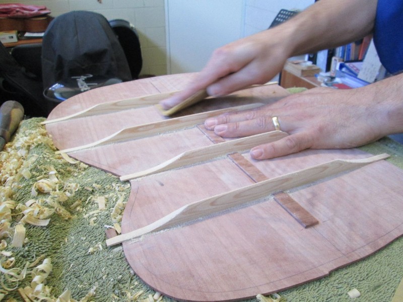

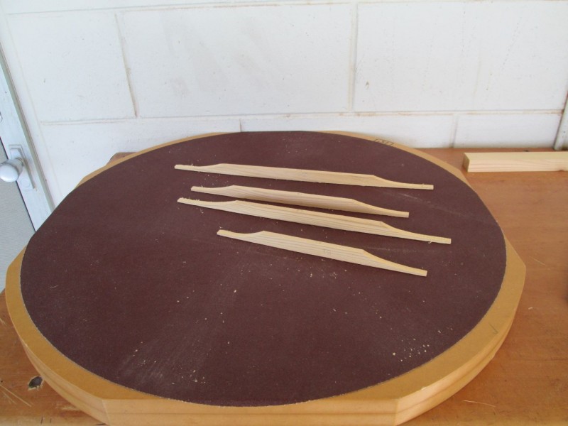

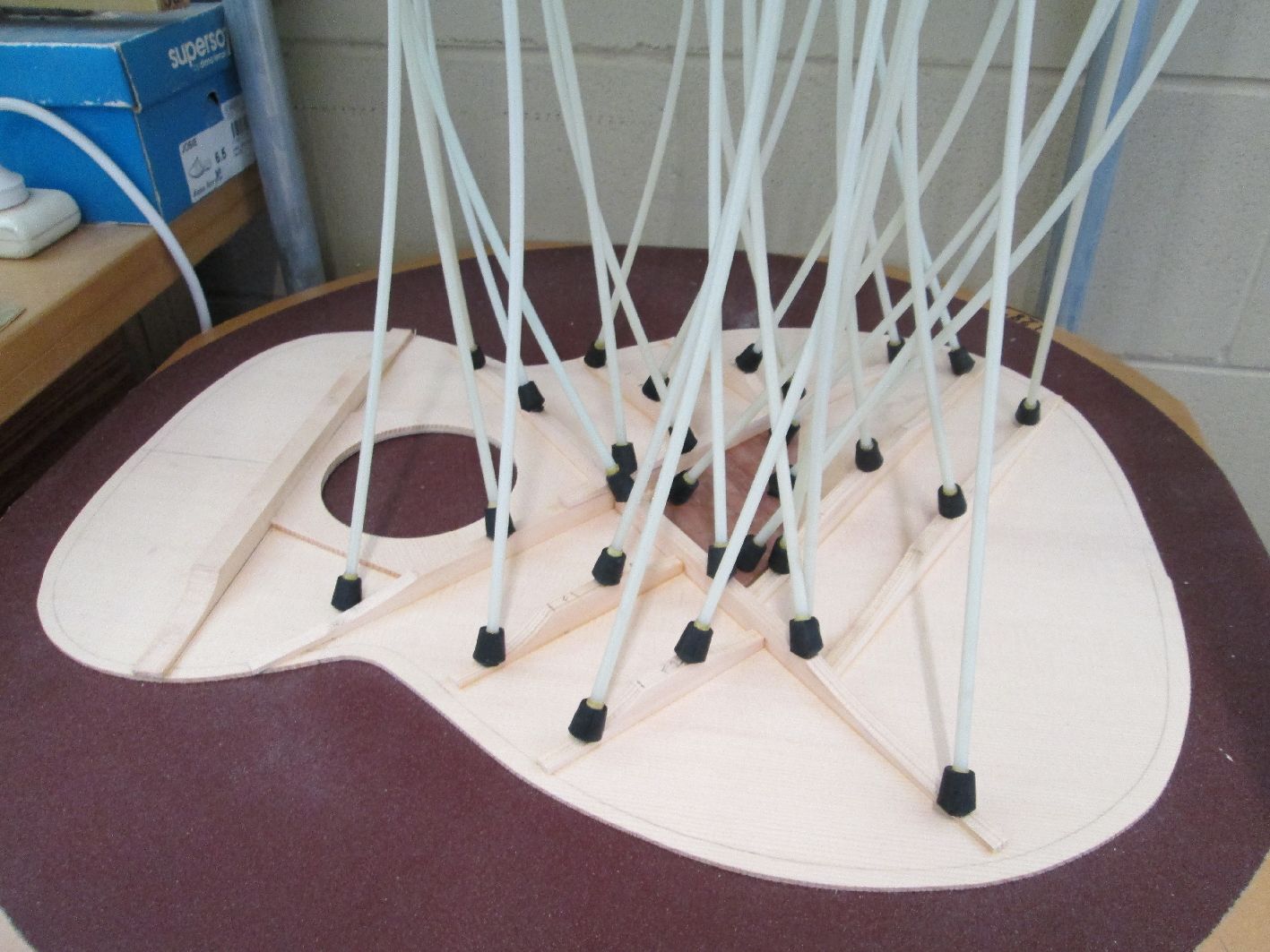

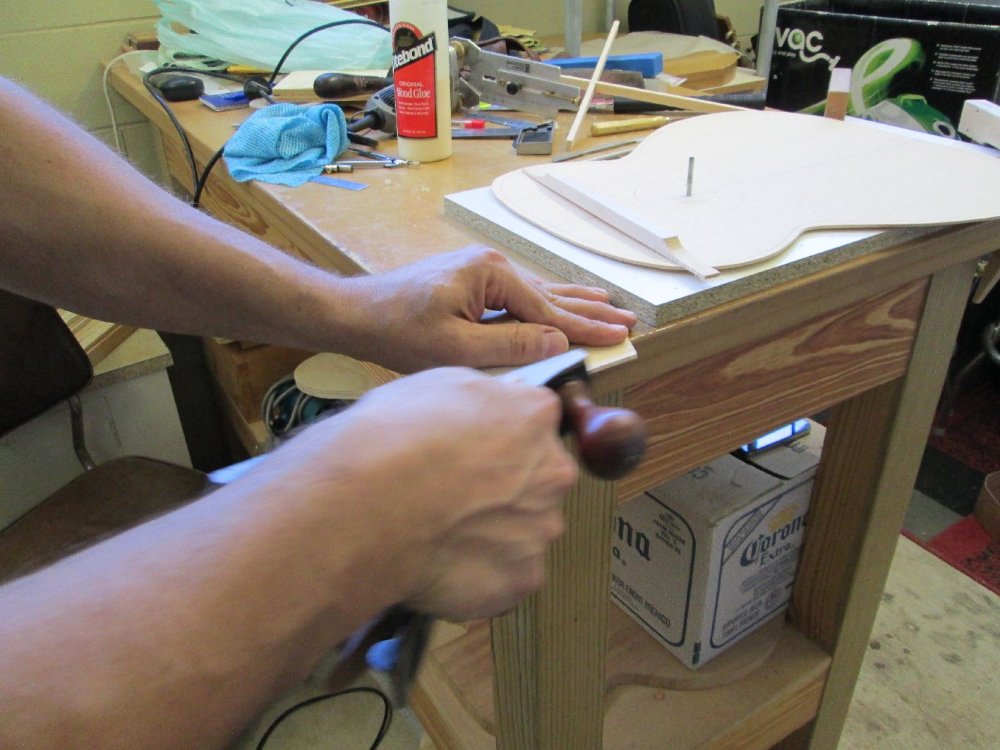

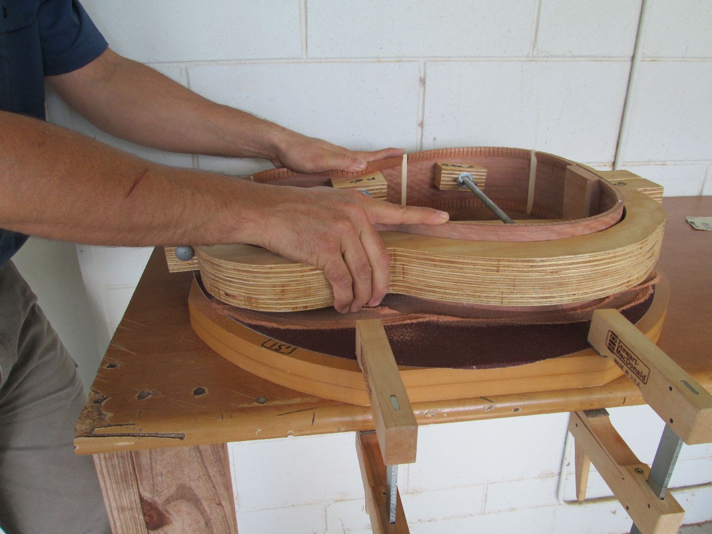

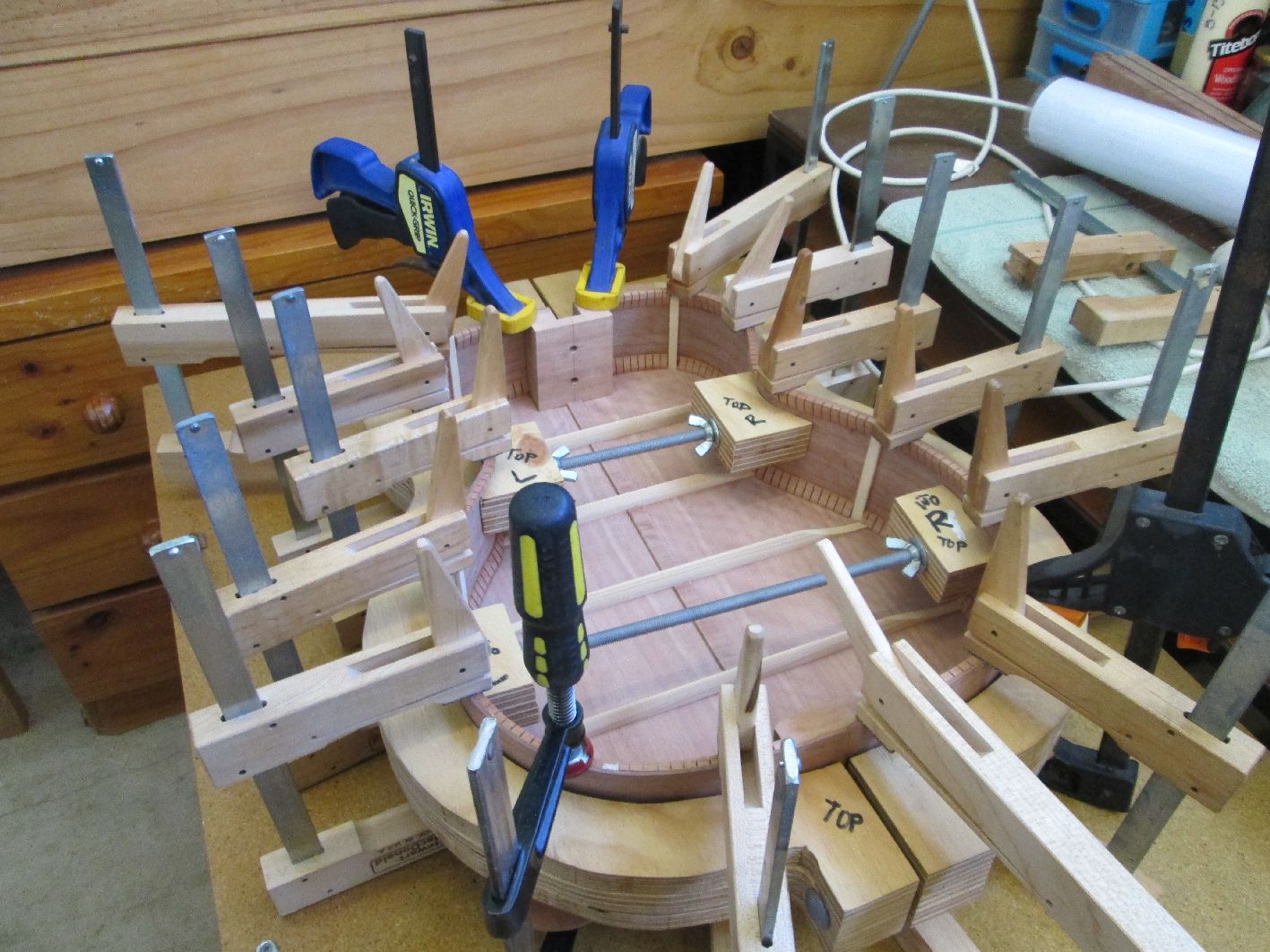

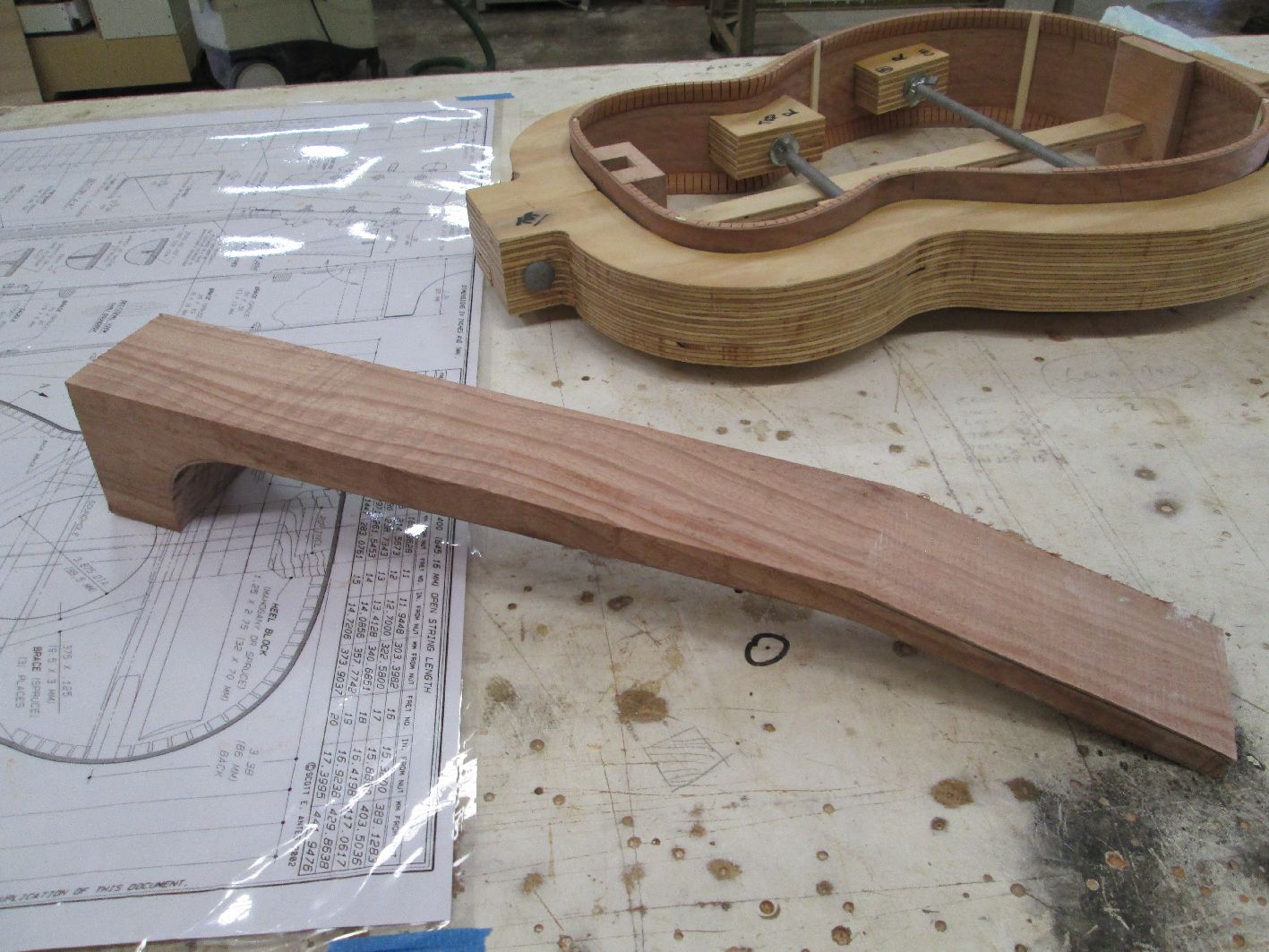

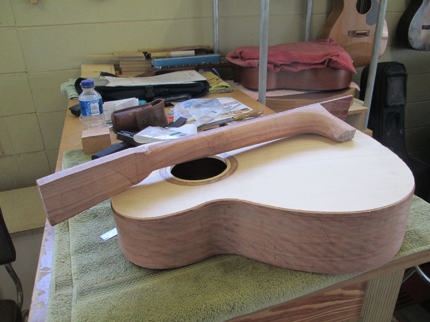

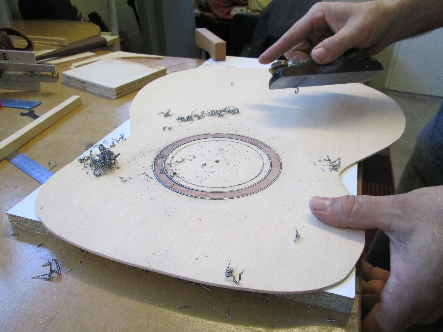

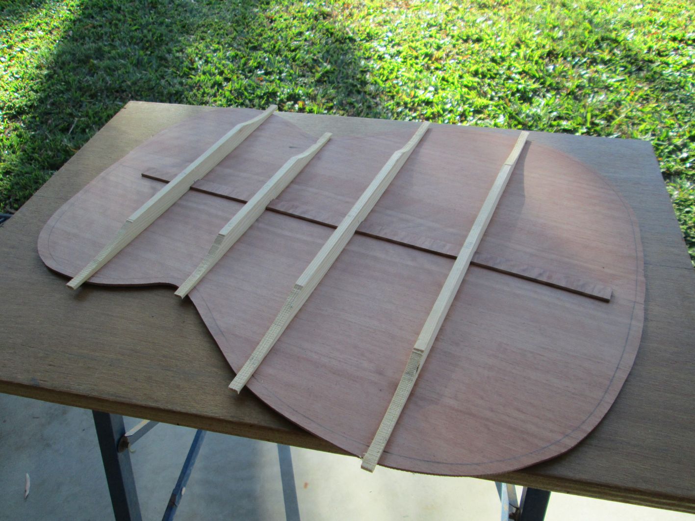

SESSION 5

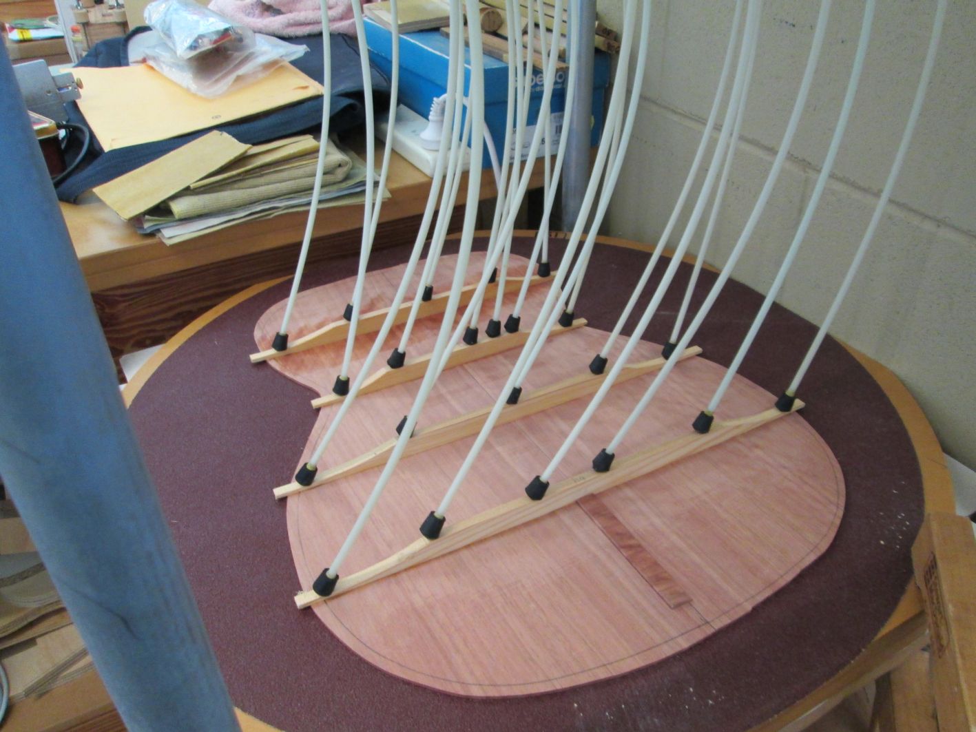

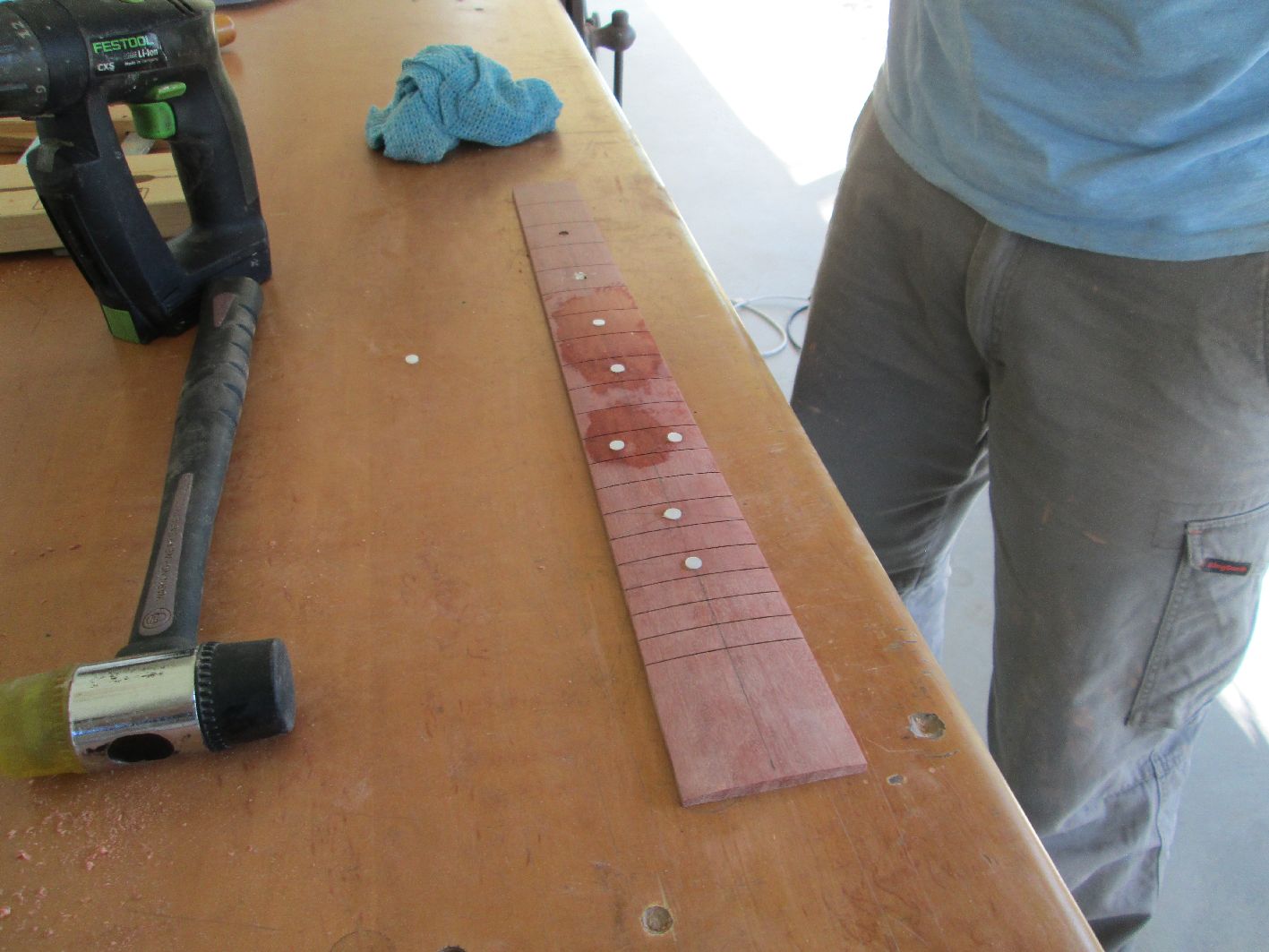

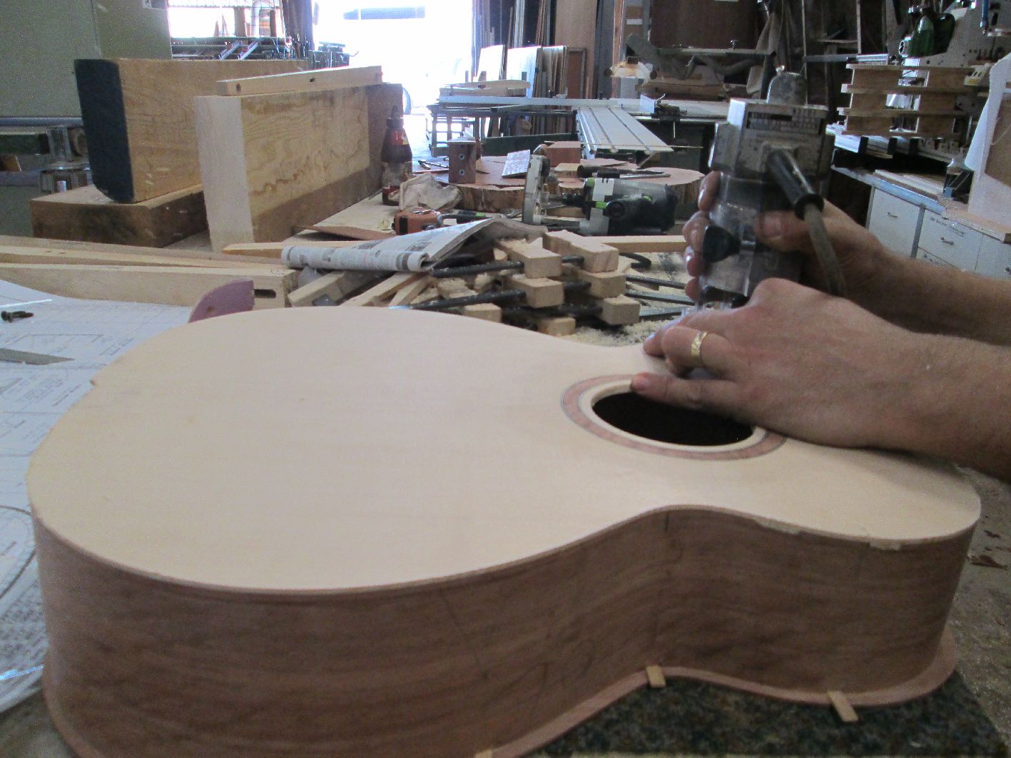

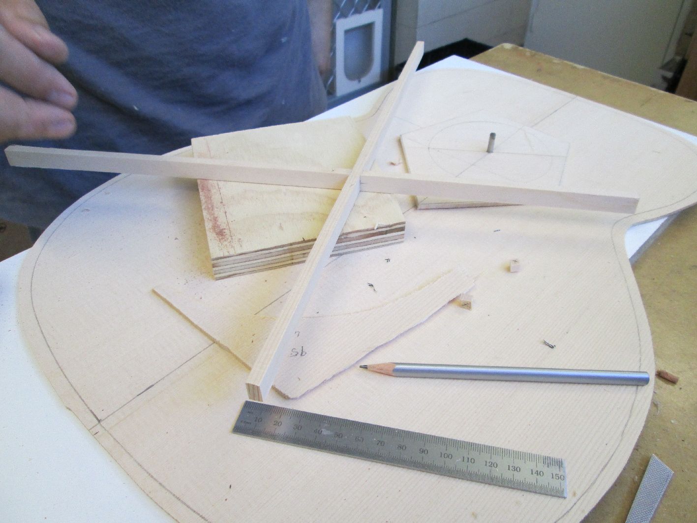

Moving along nicely with the back voiced, rims radiused and the back has been glued on. Soundhole cut out and Joel prepared the final braces for the top. He has used some Paperbark for the bridge patch which will be interesting to see what it sounds like. The Paperbarck it close grained and quite hard so it could work well. The top has been braced and ready now to close the box next week. Joel scraped the trussrod filler cover and squared the top of the neck ready for the fingerboard to be glued on next week.
Moving along nicely here are some action pictures. Thanks for your interest. Cheers Alan

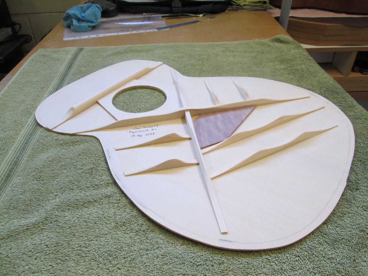

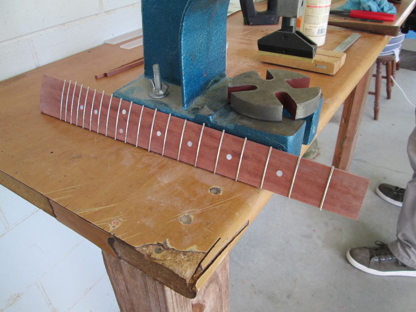

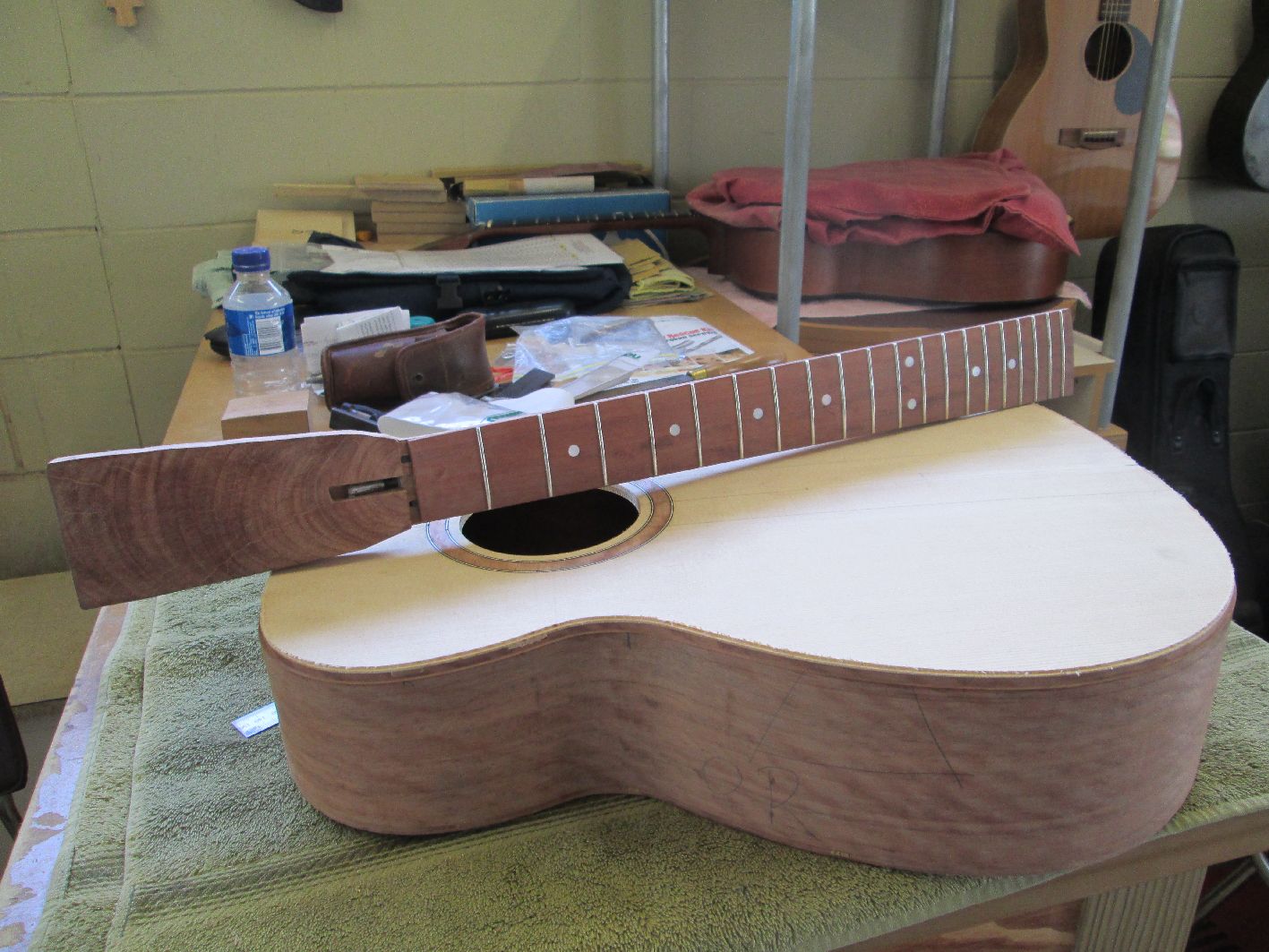

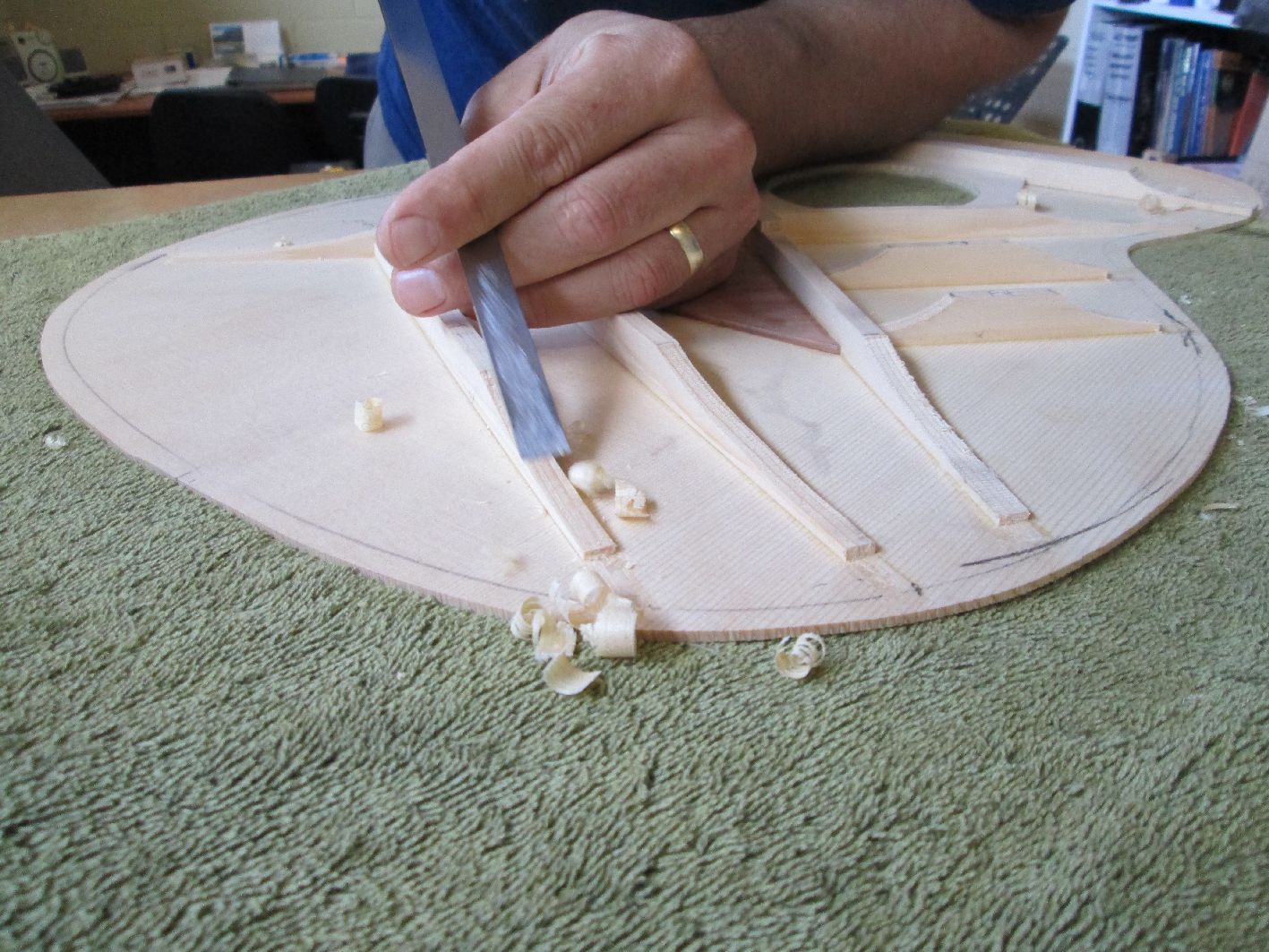

SESSION SIX
Inlet the top into the rim, voiced the top and closed the box on Monday. Joel took the neck and fingerboard with him back to his workshop to glue up the fingerboard with some epoxy, glue on the headplate and make up some binding for the body. Closing the box at my workshop took all the clamps I have. I will be going in to his workshop Friday so will take a few pics of the neck. The box is very responsive and I believe the guitar is going to sound damn good!
A few pictures and thanks for your interest:

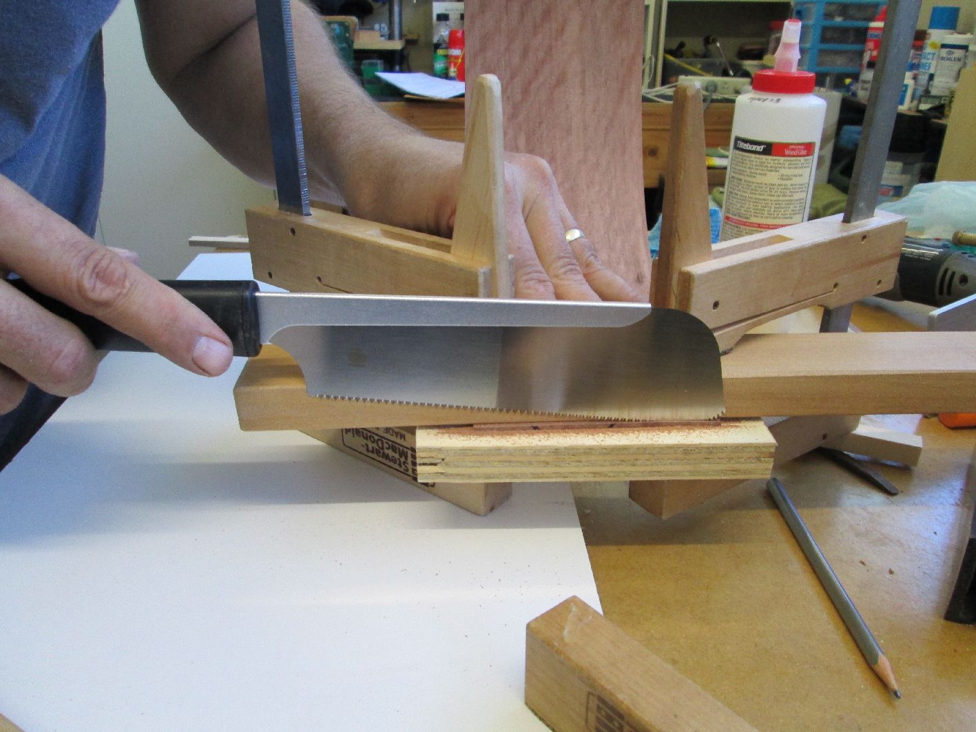

Re: Build Thread: The Paperbark Guitar
Nice work fellas, I love a nice scribe saw.

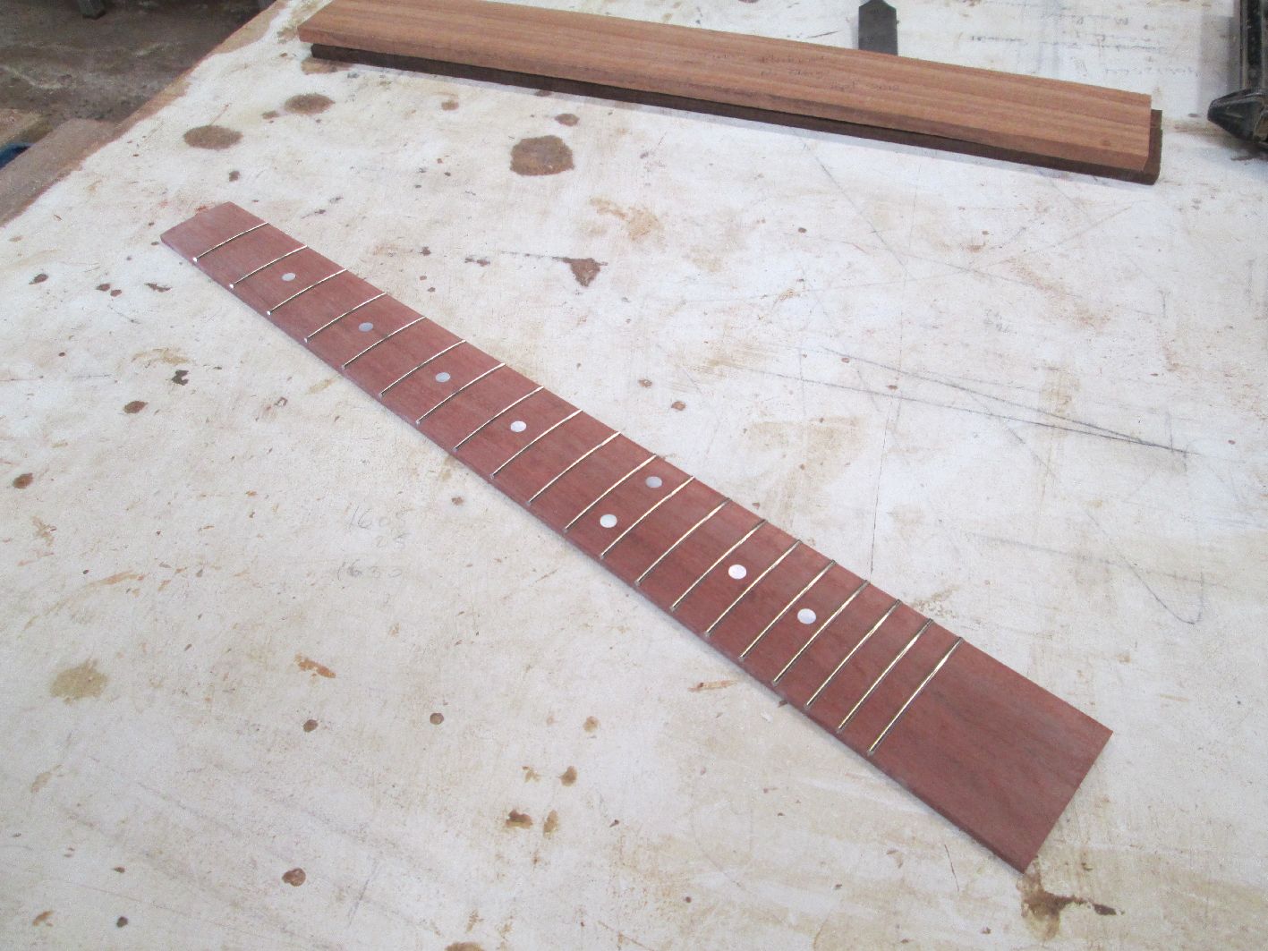

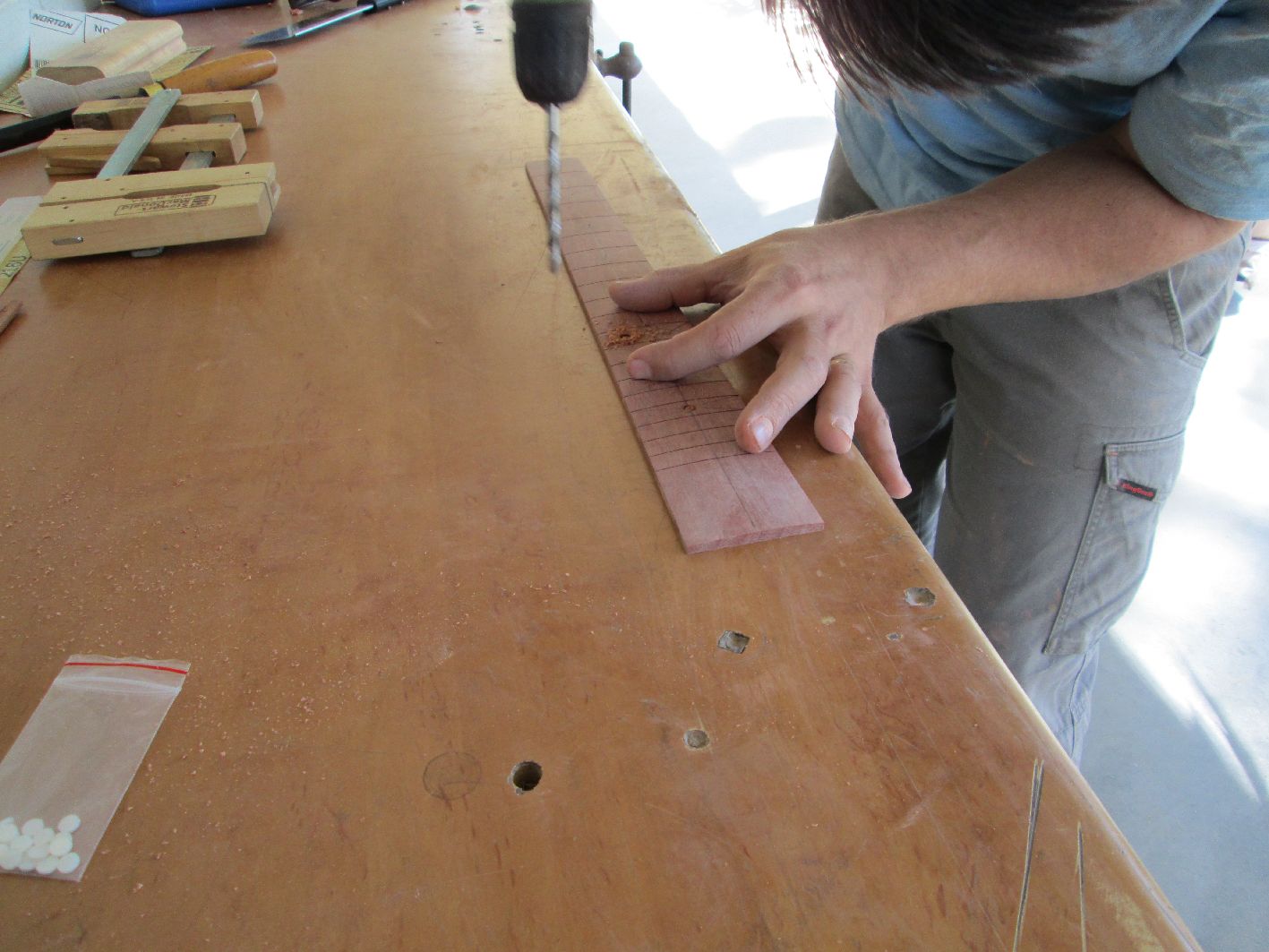

SESSION SIX
A few more pictures from session six carried out at Joel's workshop last Friday. Don't you love the head plate material.
to be continued............

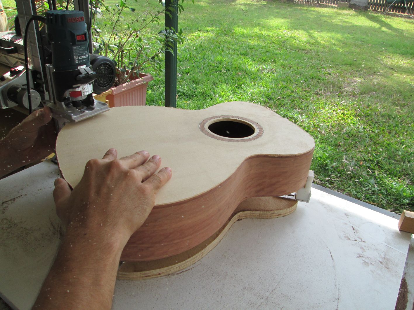

I bought a new Colt Router for the Stew Mac binding system so Joel tried it out. Worked a treat so we cut the channels on the mini maton, another OM and just the top of the Kona. Joel has been shaping the neck and the heel and we made sure the neck lined up with the centre line. The headstock shape was cut out, nut fitted and Joel has a Bloodwood bridge blank prepared with saddle slot routed out. Starting to look good!
Here are some more pictures and thanks for your interest:
