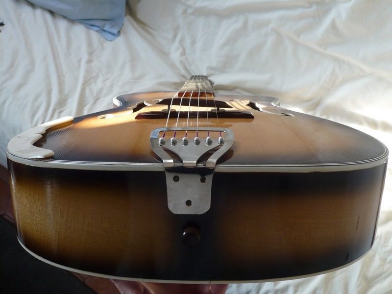

Why do you feel it might have little chance of staying put Steve? My own cylinder top Howe Orme is over 100 years old, it's had a few repairs in that time but it's still in perfect playing condition:
But my main question was chaps - what are your thoughts on the shape you put the soundboard in? Most of us have views on materials, bracing, thicknessing, but what about the actual form?

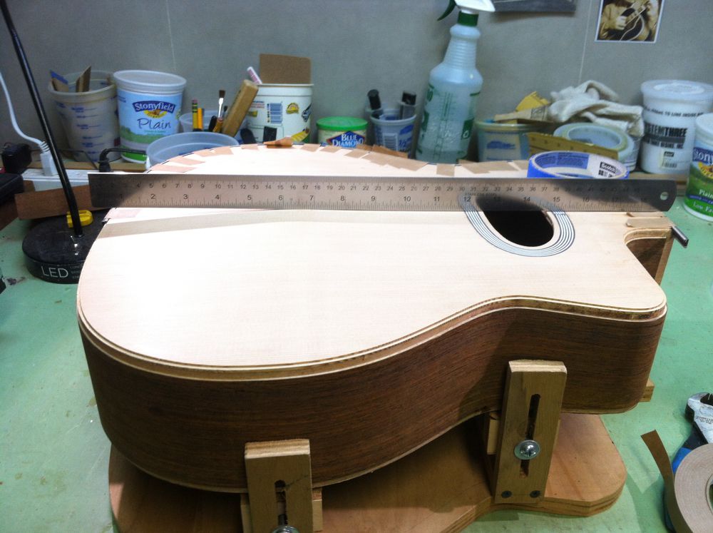

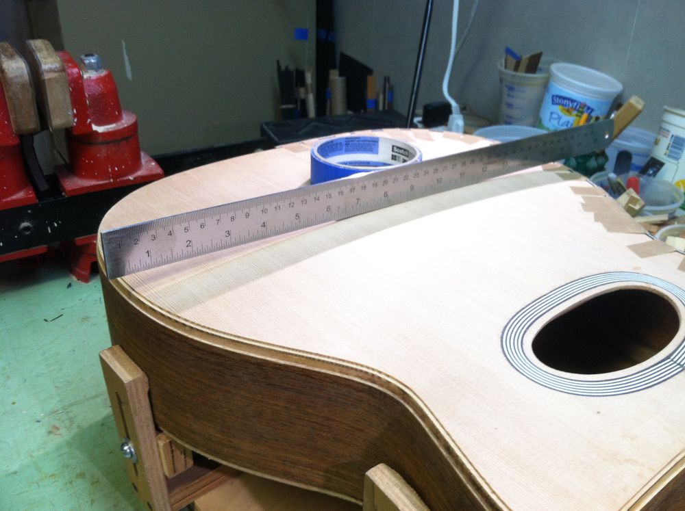

I build Selmer style guitars and one of the main characteristics is the arched top and "pliage" (fold) at the bridge area. The purpose is for the same reason other guitars use arched, domes, cylinders, etc., to provide more stiffness with less weight.
Selmer style guitars have about 7-10mm of arch across the grain, induced by ladder braces. With the grain, they are flat from the head block to the bridge and then the top is folded down to the top piece. The top edge of the sides is straight so this is how the tail of the top gets back down to the sides from the arch in the braces up from the tail. The long grain stiffness is so great that without the pliage, the grain stiffness overcomes the light bracing and much of the arch is lost. The pliage is done with heat before the two top halves are joined. A couple pictures:
Not all Selmer style guitars have a true pliage, though the originals always did. Many copies avoid this by reducing the arch or thinning up the top enough that it can bend in both directions with (beefier) braces alone. Some builders use radius dishes. The result is often an overly braced top and the high part of dome is up hill of the bridge area, not the ideal location. The pliage takes a little time and practice to make, but once figured out, it makes a world of sense. Keep in mind these guitars have floating bridges and a tail piece like a carved archtop guitar.
In fact it is hard for me to consider Selmer guitars as flat tops, there are so many differences. They are not archtops either. The are, well, Selmer style!
You might know of the DiMauro brothers who built Selmer style guitars in France from the 1940s to the 1960s. One of their guitars is the Chorus model, with a true cylinder top, ladder bracing and f holes instead of a pliage. The edges of the sides vary considerably so the cylinder shaped top can meet the sides without a pliage or otherwise much bending with the grain. These still fall in the family of gypsy guitars and has a similar sound, primarily because of the ladder bracing.
