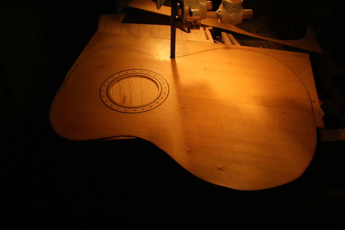

It's kind of hard to say which sort it is. I "harvested" from some sunday school pews I was given. How do I tell what sort it is?
I just made two "fundabird" basses from it. here's the body from one of them before finishing...
I've found it soft, but firmer than radiator pine.
Pete
