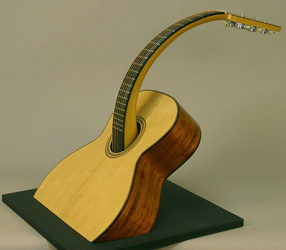

If you don't have a problem Windows will make one (or two).
Trevor Gore
Posts: 1644
Re: Mass loaded top
Post by Trevor Gore » Fri Feb 14, 2014 9:27 am
:lol:
There should be a caption competition for that picture.
I'll start clean and simple: "Ebony on a rainy day"
Bob! Get ready to pull the plug....
Re: Mass loaded top
Post by charangohabsburg » Fri Feb 14, 2014 9:38 am
Trevor Gore wrote:There should be a caption competition for that picture.
"No Action"
Posts: 10877
Re: Mass loaded top
Post by kiwigeo » Fri Feb 14, 2014 12:32 pm
The day Microsoft started making guitars.....
