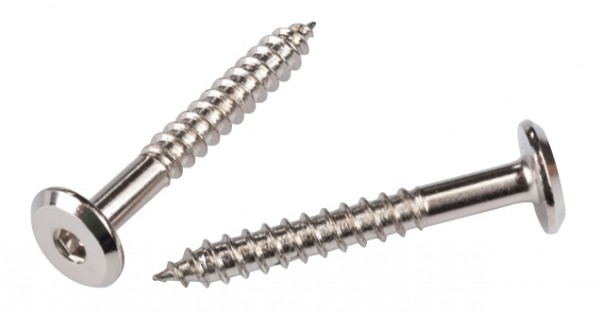

Hi Pete, if you are worried about the countersunk screw wedging the wood apart you could look for screws like this.

DarwinStrings wrote:Hi Pete, if you are worried about the countersunk screw wedging the wood apart you could look for screws like this.
Where would I find such elusive creatures?
Pete
Re: To neck plate or not to neck plate?
Post by DarwinStrings » Sat May 18, 2013 10:23 am
You would find them HERE You also might be able to get them in S.S. or gold or copper as they are a furniture type screw.
