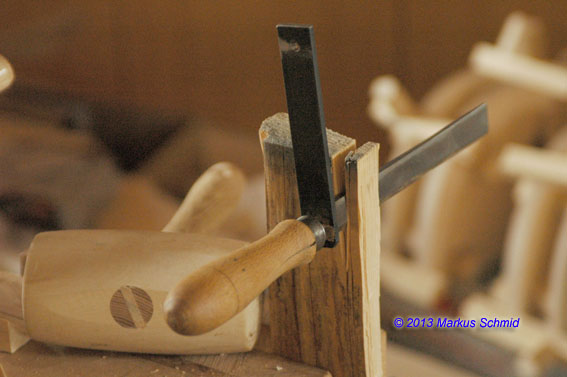

So, this is my brand new pocket froe, just about the size needed for splitting bracewood.:
The following photos depict some stages of the manufacturing process.
Maybe you remember this one - my tool steel supply I got about two years ago:
This time I picked an old, blunt and dirty file out of the tool steel pile:
Getting held agains my grinder the file lost its teeth, and with some coarse sharpening stones and a bit of patience I got the blade reasonable even, flat and sharp:
The I cut off a piece of 20x4mm flat iron and made a square, according to the file tang conical hole in it:
Image .
Image .
Image .
... and tapped this lever on to the tang:
Image .
Image .
Image .
Then I brazed the two pieces to not come lose when in use, and mounted the original handle after having filled the worn out hole with a dowel, and after pre-drilling a new hole for the tang:
Normally, pushing the lever with the thumb is enough to wiggle the pocket froe though the readily splitting wood. Like this:
That's all. Thanks for looking.
