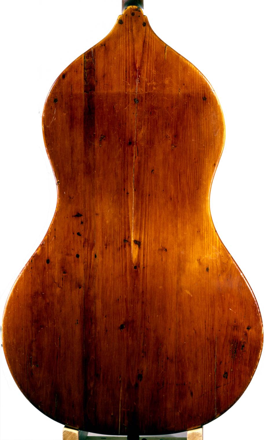

Is that what I wrote? If not, why are you getting all worked up about it?If you don't want to take the time to learn this stuff and prefer to think that it's all the builder and materials mean nothing ...
I wrote: "... I venture that a good maker probably *could* make a nice sounding instrument from radiata pine, if that's all there was available."
I have ample evidence for this, at least in the world of double basses (that counts, doesn't it??) there are MANY master-grade instruments made with what some luthiers today would class as third-rate woods; slab cut tops, plain pine & poplar backs, multi-piece backs, tops with knots etc. These are master-grade instruments, beautifully crafted, with superb tone fetching $80,000-$200,000 and upwards. They were made by luthiers from, it seems, whatever wood was available at the time. They have been expertly graduated to bring out the best and have stood the test of time.
At the other end of the scale are instruments made oin CNC machines in china from the most beautiful classic tonewoods grown in the himalayas, yet these instruments never develop their tone and often fall apart within a few years.
Becaue you are open-minded about such things, you are going to build a mandolin for the tassies with some tassie oak. This is not a classic tonewood, and many luthiers with no experience with it might diss it as a crap eucalptus wood. But you know better, don't you, because you've used it before, yeah? Or because someone else has tried it before and found that it works?
Where is your evidence that radiata pine cannot be used to make a nice instrument? Yes you have a theory based, presumably, on some experience and study of that wood. Yeah it is fast growing, full of knots, wide grain, warps like mad. But my point is, until you actually try it, you won't actually know for sure. It might have just the damping characteristics that go beautifully with that nice Lutz top.
By the way, what is a "real musical instrument"? Is that something on which you have a patent?
have a look at this crap wood held together with screws. Is this a real musical instrument?? Tell me whether you think that it will work.
