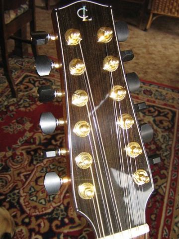

Post by Craig » Mon Mar 24, 2008 3:01 pm
G'day Martin,
I too used 25 mm. between tuners , which seems ample.
I installed Gotoh mini's. They seemed a tad on the heavy side , so swapped out the knobs for their ebony replacement knobs. B.T.W. I think from memory , the Ebony knobs cost bloody near more than the tuners !
It reduced the weight considerably !
Anyone want some Gotoh gold mini knobs ? :lol: :lol:
Here's my GROOVY picture :lol: :lol:
Cheers , Craig
Post by Kim » Mon Mar 24, 2008 3:30 pm
Beautiful work as usual Craig.

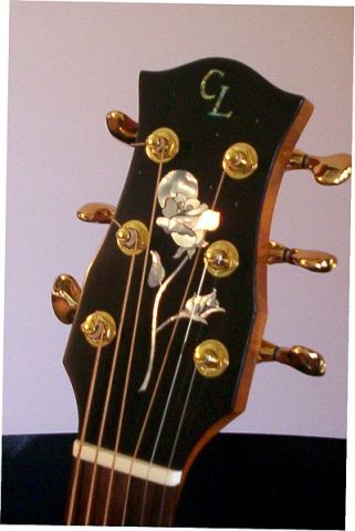

Post by Kim Strode » Mon Mar 24, 2008 4:27 pm
Great 'CL' inlay Craig. At some stage can you show a novice like me how you go about in inlay in the headstock like yours.

Post by Craig » Mon Mar 24, 2008 10:30 pm
Kim, I'll have to give the inlay thing some thought. I'm fairly busy with the adjustable neck thing at the moment . I'm sure there are others here who can help as well.
Not trying to fob you off here Kim but a search through some of the American forum archives on the subject will give you lots of information to start with. I'll help where I can, but don't really qualify myself as an experienced inlay artist to give a tutorial. Keep reading up on the subject and give it some practice runs.
Here is a picture of my very first inlay which took me a REALLY long time to finish.
Cheers Craig
