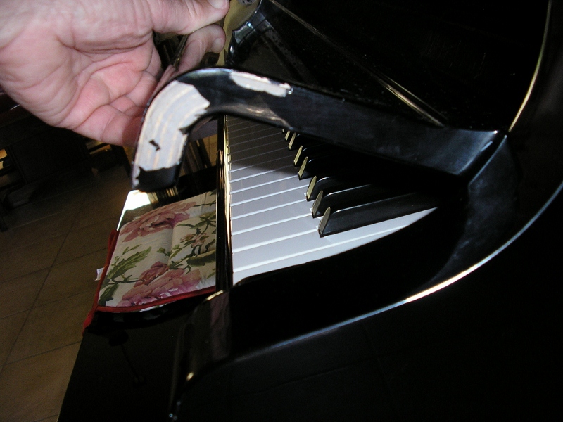

Now the problem, the dings. The picture below shows the worst ding. There are other smaller dings that someone has stained with black. I would like to make some effort at improving the appearance. The finish I have been informed is a black polyurethane paint, overcoated with clear polyester. It is real thick and rock hard so is difficult to know what to do. Any suggestions.
Peter
Finish repair problem

Hi Peter, looks like a specialist type of job. Check out http://www.ellopianoservice.com/finish_touch_up.html maybe they would give you some info.

Easy
We repair pianos, it will just be a two pack poly urethane paint, just car bog the surface prime and paint, it's that easy, all other areas sand smooth and paint, when your finished wet sand with 1500 then use a car buffing mop, they are almost a plastic buff, low speed with something like mesquires and your done
Really simple job
Really simple job

Thanks. I was told it is black polyurethane paint sprayed with clear polyester.

It looks like a classic bog and putty job to me Pete. That finish is going to be pretty much impervious to all solvents, so you shouldn't have any trouble with it wanting to boil up on you like some soft cheap coating will. It will require some careful prep if you want the finish you are applying to stick well, as it's not going to melt in like lacquer or shellac will.
I would be treating it exactly like it was a Ferrari that was in to get the dings and chips repaired. I do that every day of the week, so it's old hat.
Hard to tell from the pictures, but if the edge of the finish is very thick then you are best to feather it out so it's not so abrupt. Then apply a fine fill polyester putty if it is going to require levelling with the existing finish.
You can get them at any Automotive Refinish Specialist. In the trade they are referred to Painters Bog in Australia. They require a catalyst hardener and depending on temperature will generally be ready to sand in about 20 minutes. When sanded level you apply a primer surfacer. We use 2 pack ones. They dry overnight unless you have lots of heat. I wouldn't be doing anything like that on a wooden piece. Cars are fine. We get them cooking hot.
Fine sand the primer surfacer back and then you need to decide how much you are going to refinish. Prep the required area and mask off the rest. And away you go.
If that isn't clear, then let me know how I can help.
