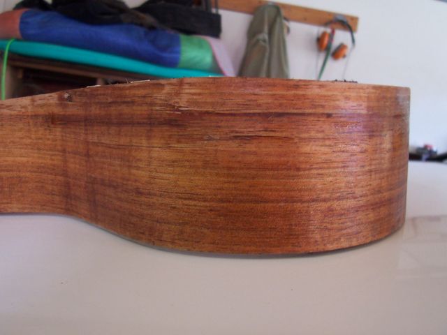

Post by jeffhigh » Sat Mar 22, 2008 4:31 pm
And Back together again.
Area moistened with turps.
Post by ozziebluesman » Sat Mar 22, 2008 4:53 pm
Brilliant Jeff. No tyre or skid marks showing either!!! :lol:
Post by Allen » Sat Mar 22, 2008 6:52 pm
That's looking great. A little more work and some purfs and you'll be hard pressed to spot it.
Post by jeffhigh » Sat Mar 22, 2008 8:23 pm
Yeah, it has come out better than I thought it would.
The camera flash actually makes the picture look worse than in person.
And the before picture was NOT how it looked initially, the whole corner above the mold was bent over horizontal with only the cloth tape holding it together
