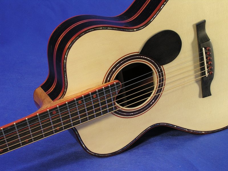

This one's got me stumped, I'm hopin' some of you could spitball some ideas and we can figure this out! http://www.vintagemartin.com/MartinCoupaSpanish.html
Join the sides before bending? They'll just come apart under heat and moisture. Join (or at least glue) them after? Gluing bent ribs to bent marquetry sounds like an impossible nightmare. You can see in this picture here that they're at least three separate pieces with some extra reinforcement in the way of hefty side braces:
Inlaying them like a back strip would probably leave the ribs too weakened for bending.
I putzed with the idea of doing it like this with a layered up sheet of veneers...
...but it would require some kind of elaborate jig or something to keep the ribs in line, and would result in lots of weird variation between end grain and quarter surfaces on the stripe, and just seems too elaborate and insane an idea to work and...i don't know!
Thoughts?

I think the easiest way would be to groove the sides before bending and inlay after closing the box. A few tests wouldn't hurt.
Alignment at the tail block gets more precise.

If the stripe is to be purely decorative then keep it simple and do it as an inlay. Id do the inlay the same way I'd do an inlay along a back join. The channel would be routed and inlay glued in while the side is flat and then bent with the side. If heat from bending was a potential problem I'd bend the side after cutting the channel and then glue in the inlay.....same process as doing a purfling glue in.

My first thought is to rout it out and inlay it with HHG as a flat. Then bend it.
I bend bindings with purflings glued on with HHG all the time. Never had a worry doing this.

Looking at the picture, it definetly looks like two different pieces of rosewood, you could cheat by routing and inlaying the centre and then simply egg white the bottom rosewood and z-poxy the top this will give the appearance of two different pieces of rosewood being utilised, the egg white will give a very light natural colour and the z-poxy will give the darker almost indian rosewood colour
Or just bend up the sides and put a couple of veneers over the top, wouldnt surprise me if thats actually what they had done at manufacture
All tricks to the eye

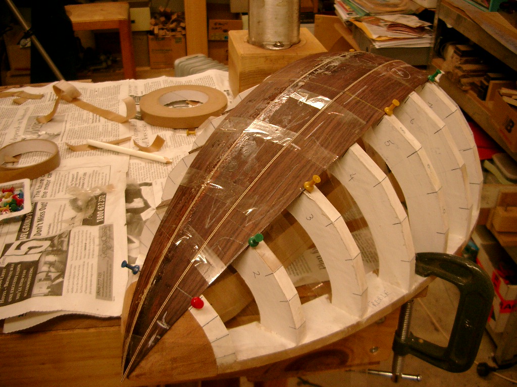

Both the construction picture and the first shiny picture clearly show two sets of wood being used. Most likely the whole idea is a case of need being the mother of invention. The need for deep sides with narrow boards. The construction image shows a large number of particularly solid side reinforcements no doubt to ensure the whole thing holds together.
I imagine that if you use a full outside mould, and a fox type bender, it shouldn't be too difficult to build this up piece by piece.

This is all assuming that the sides have to be made from solid; would it not be simpler to make a male/female mould and build the ribs from (2 or 3) veneers, inlaying the stripe between the external veneers as you go? The 3 external pieces can be held in place with veneer tape.
I've built a few resonators by laminating the ribs. I suppose it depends on whether you are looking primarily for the appearance of the stripe or for the tone of the instrument?

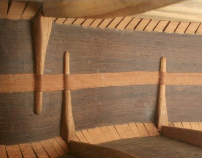

The sides are in TWO pieces, the purfling is not inlaid into the side. The sides are sometimes book matched so there can be little doubt that the sides are in two pieces. The joint is supported by a silk "gimp" strip glued over the joint. As well there are a number of elegant "wishbone" braces around the inside periphery of the guitar that tie into either the top or back (but not both) braces and keep the sides in place.
I have some interior photos if someone can explain how I can download them.
The two-piece side Martin & Coupa guitars seem to be from the 1842 to 1846 period. I have no idea how Martin assembled them. It would seem, however, that the back or top was used as a template to build up the sides (otherwise I can't see how Martin could have installed the "wishbone" braces).

Attached is a photo of the interior of a Renaissance-shaped Martin & Coupa period guitar sold by Gryphon Guitar in the last couple of years.
The shot of the interior (also by Gryphon) is the best I have encountered (mine are not nearly as good) so I thought I would use it as an example.
This guitar has a 5-strut fan brace that probably places it in the 1842-1843 period. It does not have a Martin & Coupa label (only those
Martin guitars sold in New York received the M & C label).
You may notice that the kerfing is made of individual blocks, not a strip of kerfing. I understand this is a typical feature of Spanish guitar construction from the period. Other Martin guitars have quite crude-looking kerfing blocks (widely spaced and of irregular size and shape).
