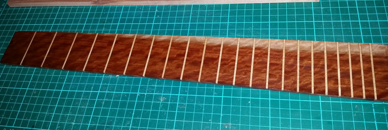

_MG_0053 (Custom).jpg (52.92 KiB) Viewed 14271 times
What's in a name? red ironbark isn't always red! :shock: :shock: :shock:

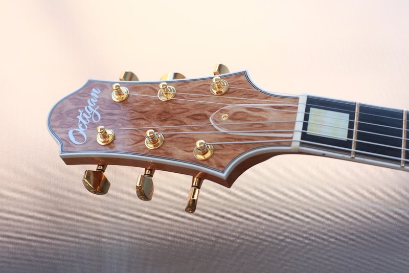

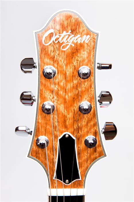

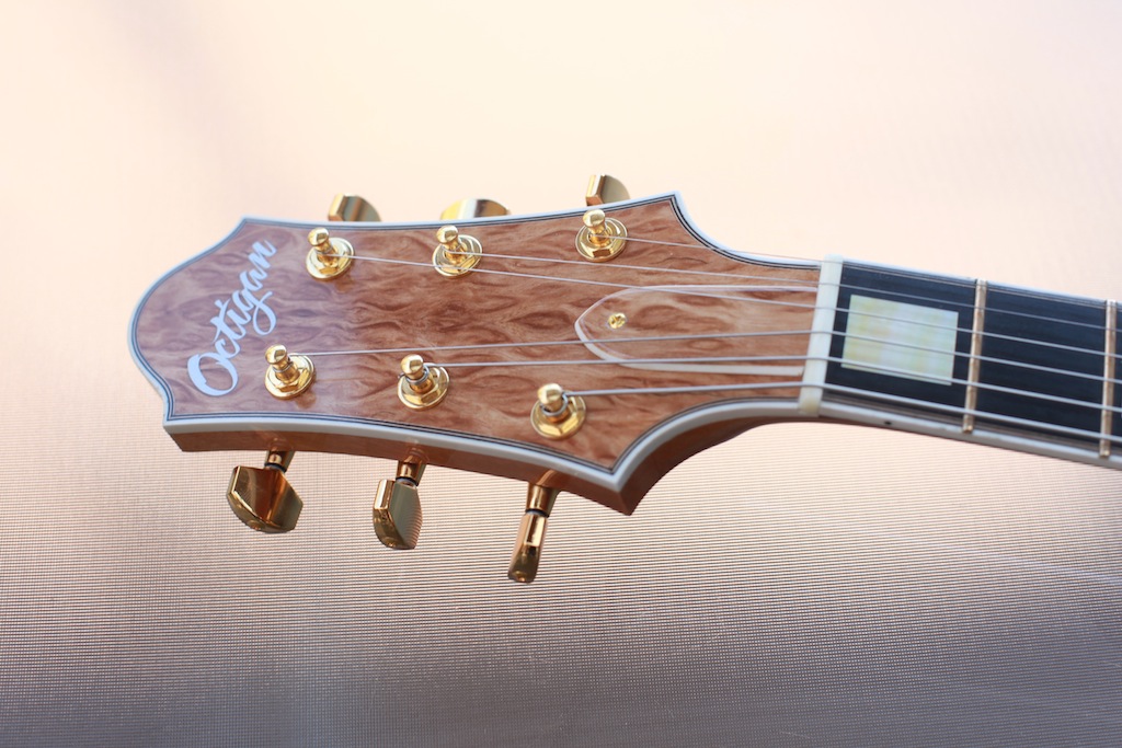

Post by rocket » Fri Jan 04, 2013 5:01 pm
Not only but also,, black butt isn't very black either :-? :-? :-?
Although some timbers like red gum and red ironbark are difficult to work and as a stand alone component pretty unstable, they can still be used as an ornate feature on an instrument such as a veneer.
