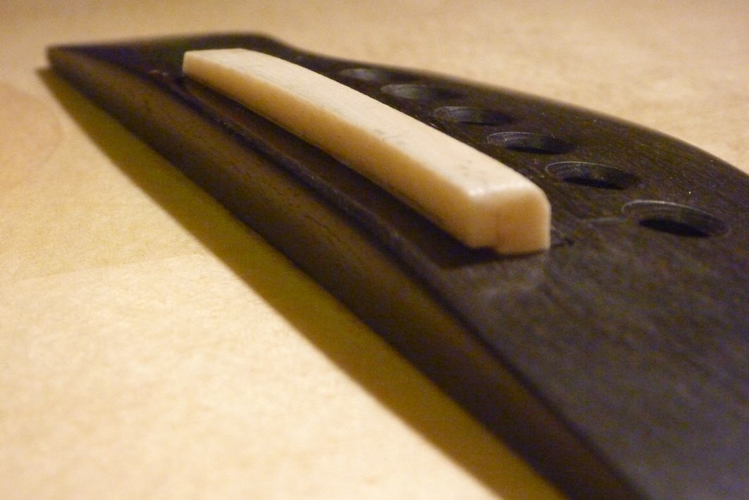

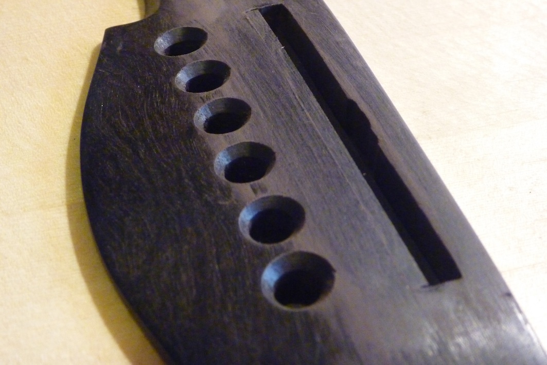

I had used a 5.5mm bridge so had room to reduce the width of the saddle slot using a piece of ebony binding cut to fit, glued in place and sanded.

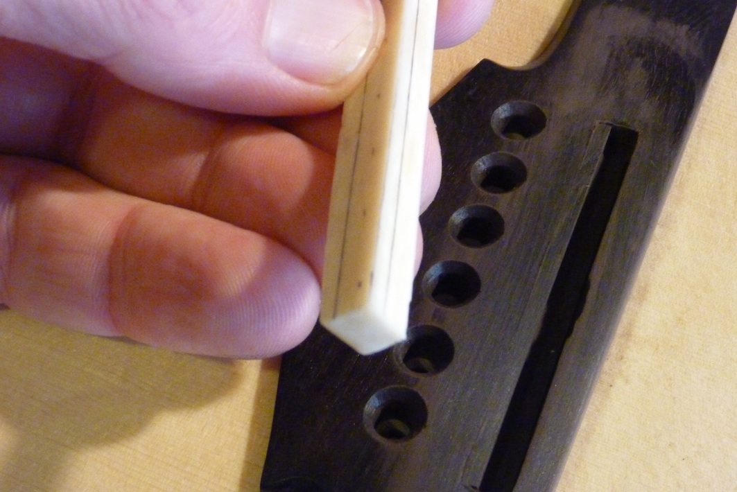

I then removed some of the saddle so that the bridge was shifted forward by 2.2mm.

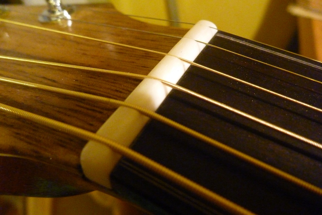

I also removed the 1.4mm compensation I had built into the nut by filing a ramp into it so that the bottom of the string slots was in the correct place.

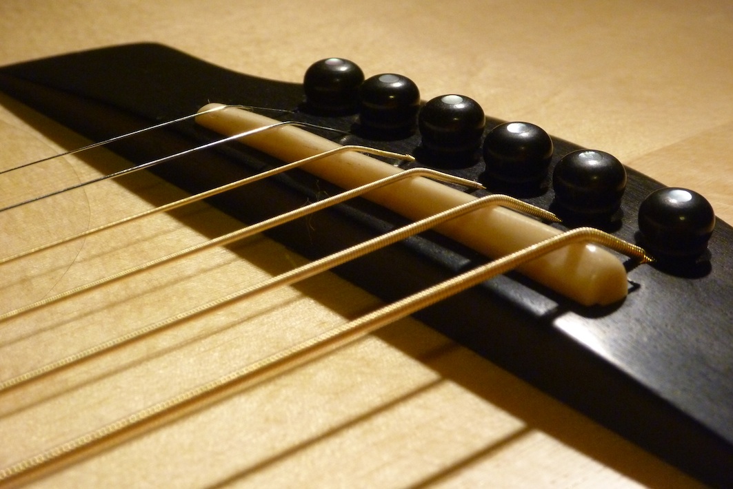

The two actions combined allowed me to file the saddle such that the fretted 12th fret notes were exactly where they should be!
