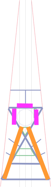

So to my actual problem: I think I might be "over-building" that thing. I checked the bracing system of my Martin Backpacker and it has no kerfing and only two braces that are not crossing for the part below the soundhole.

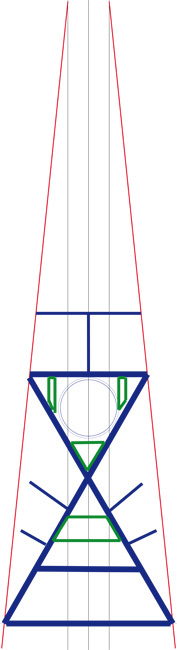

To my rough plan (the one on paper is more acurate of course):
-The blue lines are my braces and the green lines are the outlines of my patches (bridge patch and the patches round the soundhole)
-I was thinking to use the X-braces, but leave out the fingerbraces to the sides to enhance the resonance ability of the top.
-My build has no fingerboard, thus the whole neck can vibrate (like Nick from http://www.wildwoodinstruments.com.au/s ... ments.html does it). The fretmarks will be lasered. I don't know yet, if and how I should brace the neck. It's pretty narrow up the neck and the headblock reaching in 7cm will support it anyway. Do you have any ideas?

- A rough sketch of what the backpacker bracing looks like
- backpacker.jpg (64.77 KiB) Viewed 7351 times
- That's the rough plan for my bracing based on the traditional Weissenborn X-Brace system
- Lapsteel-patches-klein.jpg (62.04 KiB) Viewed 7351 times

Without designing your bracing for you, I would suggest that in such a small package, with the triangular shape, the traditional weissenborn bracing will not work well.
Two main objectives to keep in mind are
Resisting bridge rotation
Transferring force around the soundhole

Hey Jeff, thanks for the reply. Yeh, I kinda figured it would be over-built with it, that´s why I am here. It's my first "real" build, so I am all like "safety first", but that probably won't get me anywhere. I might stick with the X-Braces, leave the transverse brace on the bottom and two of the finger braces.

For starters, use solid linings not kerfed linings since you have no curves, this will give you plenty of gluing area and a rigid box.
If you want to use X bracing , I would probably just use the X and the crossbar above the soundhole, forget the rest.
Make sure that your layout of the bracing allows the outer bridgepins not to interfere with the legs of the X

You are heading into uncharted territory here and it will be almost impossible to predict what your instrument will sound like from plans.
I think you should plan to build at least two of these instruments - the first as a prototype and the second in maybe 12 months time after you have assessed the sound and durability of the first.
My gut feeliing would be to have quite a deep bridge plate (to counter bridge rotation) and lighter bracing.
Because your design is so narrow there will be very little cross dipole movement of the top because of the narrowness of the span (from one side to the other)
What sort of wood are you using for the top? For something that will start out reasonably warm and open I'd suggest Western Red Cedar and would certainly steer away from hardwoods on something so small.
Food for thought anyway.
