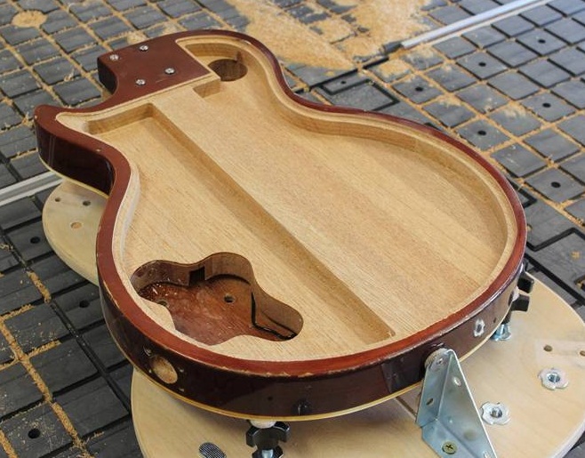

For those that might be interested.
A recent request to lighten the body, The surprising result was, with the new pickups it had a really nice tone, which I think being chambered has contributed to.

Nice job. What kind of new pickups were installed?

Post by simso » Sat Oct 13, 2012 11:11 pm
Seymours / hot rod set

Nice job Steve, CNC'd?

Post by simso » Sun Oct 14, 2012 12:35 pm
Of course, the hardest is drawing the existing guitar into the computer and making sure it machines / cuts in the right areas
