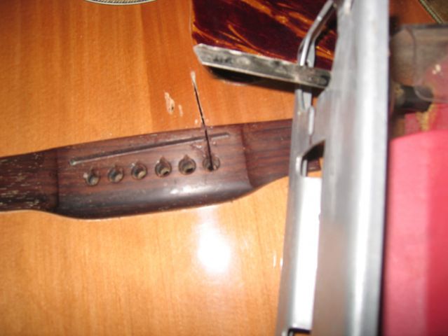

Speak for yourself Kim! Is 60mm too deep for a string slot in a bridgepin hole?? :shock:
Post by kiwigeo » Fri Feb 29, 2008 12:57 pm
Whoa....!!!! Now THAT's something to get at least a little bit concerned about.
Thanks for that Kim.

Kim, Where'd you get that picture? That is not your work. No way, no how.
Another damn Yank!
Post by Hesh1956 » Fri Feb 29, 2008 1:50 pm
When i ream a pin hole slightly to large and the pin bottoms out I put some medium CA on a scrap and paint it on the pin. Let dry and Bob's your uncle. It works great and it works over time too.
Just don't stick the pin in for at least 20 minutes so the glue is completely dry.
Paul B
Post by Paul B » Fri Feb 29, 2008 2:00 pm
I think that pic came from Grumpy
Post by Kim » Fri Feb 29, 2008 4:45 pm
Dennis Leahy wrote:Kim, Where'd you get that picture? That is not your work. No way, no how.
Hey Dennis,
I got the image from the OLF, it was a joke posted by James Burkett. James was replacing the top on this guitar and did not want to save the generic bridge. His sense of humour insisted that he remove the top as shown so he could take an image and post it in a "Slotting the bridge for slotless pins" thread. If it was my work, no way could I post such an image :oops:
