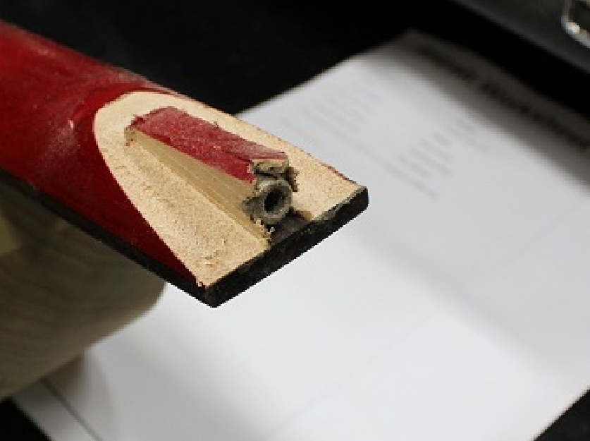

It still amazes me the shit that is used to manufacture guitars and necks, this neck snapped off real easy on the customer, the break was super ugly, so Ive done a scarf cut to insert a joiner piece and the wood is pretty pathetic, fibrous, no real grain structure.

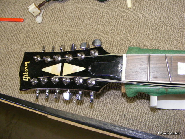

I've seen it many times, mainly from the same good customer of mine. Over recent years I must have worked on 12 of this customers guitars of varied makes for various reasons, in the last year he has brought 4-5 of these Chinese knock offs to me.
All look the real deal but do not feel right or play right.
Some of the jobs have been: correct fret work, all needed setting up [whats new?] one I fitted with two new necks to get it to play [no adjustment in the originals] another I fitted new pickups. The last one I did for him was a "Gibson" 335 style 12 string. It cost him close to $200 for me to get playable. This guitar had a very narrow 6 string fingerboard with frets beveled excessively so that the playing area was even less.

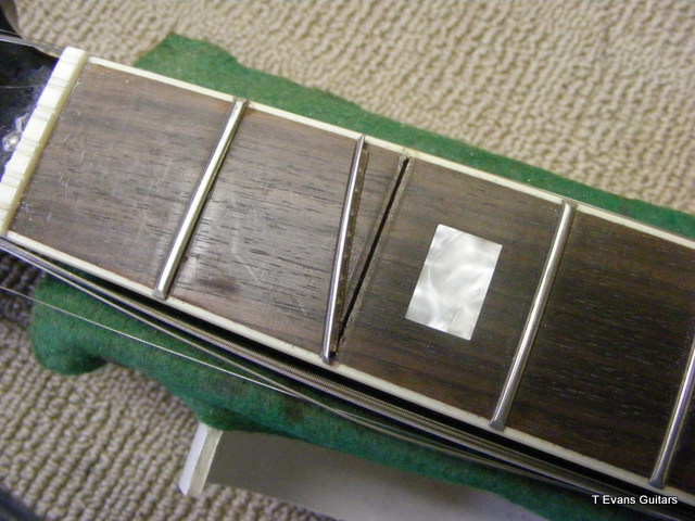

I had to make a new bone nut to widen the spacing of the strings then level the frets to get more playing area on the tops by moving the bevel out a bit. In the photo below you can see a fret laying on the fingerboard, why?... it just popped out and that where it landed. I couldn't believe it and took the photo. He also bought a heap of strings that were well known branded but crap, yep he bought those cheep also.
I told the customer he may have to capo the 3rd fret so he can finger the strings. What do I thing of Chinese instruments

If its never been refretted, lack of the fret side nubs is the first give away
Re: How cheap can manufacturers really be.
The best Chinese frets come from the Tang Dynasty......the frets on this guitar are obviously from the Tangless Dynasty
