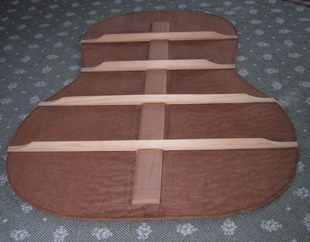

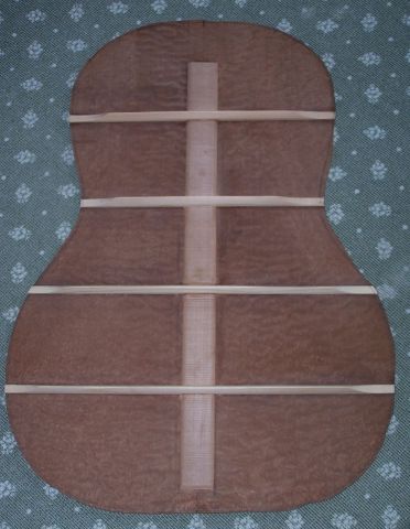

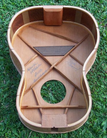

Post by Allen » Sun May 04, 2008 5:43 pm
Well, I've made some progress on the size 5 that is worth posting some pictures of, so here it is so far.
The back and sides are Brain Sapele, The top is Western Red Cedar.
Braces on back are Engelman Spruce. 1/4" x 1/2".
Braces on top are Western Red Cedar and started out at 1/4" x 1/2".
I managed to get the back on today and hope to get the binding well under way tomorrow, but I gave myself a really good slice on my finger with a chisel, so it might slow me down some. It probably needs stitches, but if I go to Cairns Base I'm more likely to have an arm amputated. :roll: Sure makes typing difficult.

Post by James Mc » Sun May 04, 2008 6:02 pm

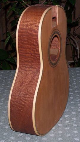

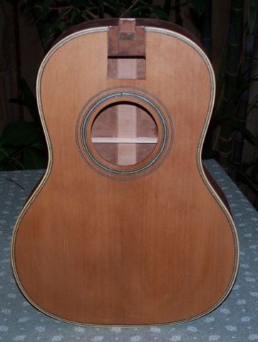

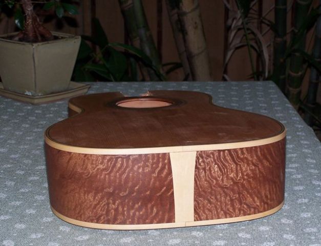

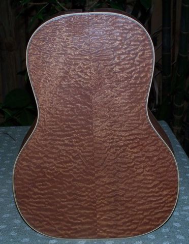

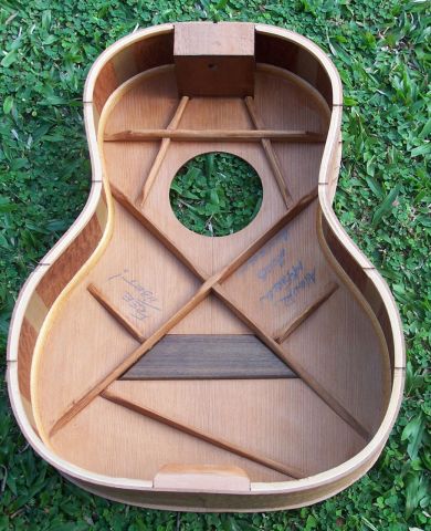

Post by Allen » Sun May 11, 2008 5:42 pm
More progress pictures of this little beauty. The more that I work on it, the more I'm falling in love with it. Just a wash coat of shellac on it to bring out the grain. It's going to be spectacular under a finish. :D
Post by Bob Connor » Sun May 11, 2008 6:13 pm
Looks sensational Allen.
That Sapele is really going to jump under a finish.
