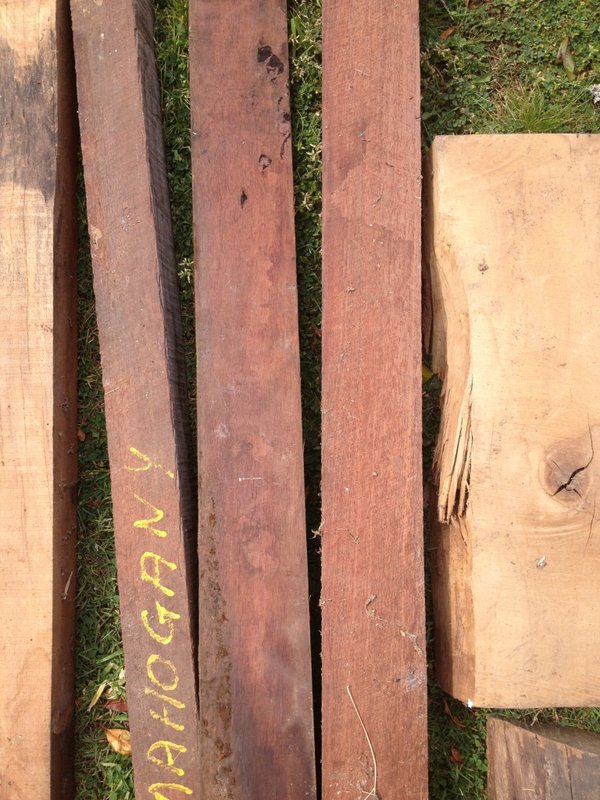

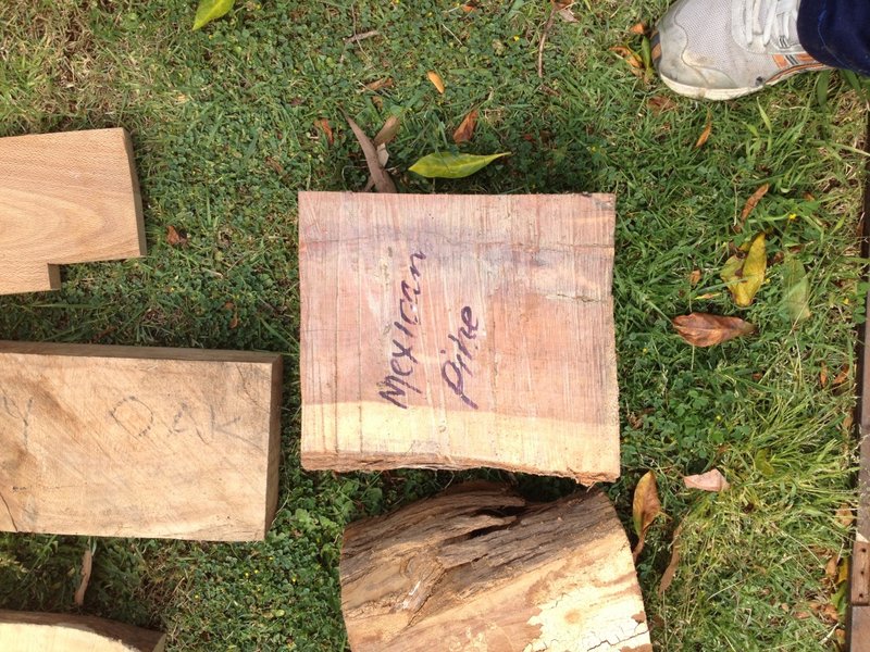

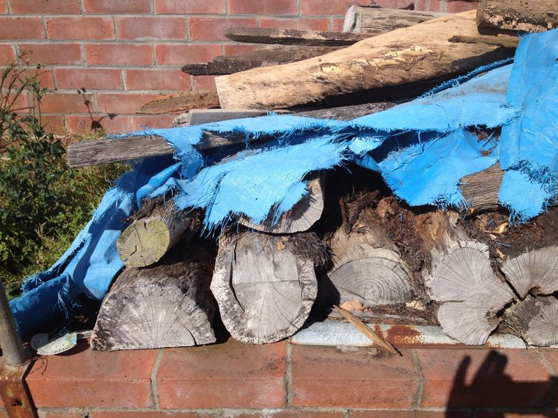

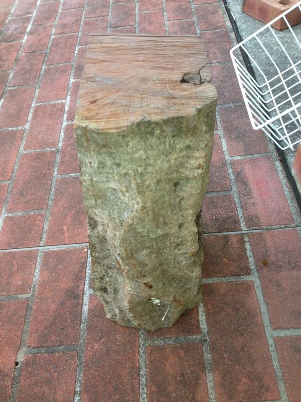

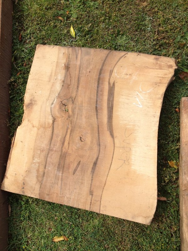

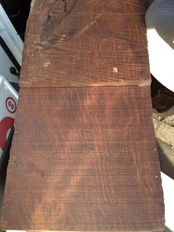

Post by geoffrod » Fri Sep 21, 2012 5:36 pm
ok here are some pics
there is-
hairy oak
mexican pine
osage orange
silky oak
red mahogany
blackheart sassafras

Post by J.F. Custom » Fri Sep 21, 2012 5:44 pm
Hi Geoff.
Most timber can find a use somewhere... Even as inlay or veneers.
Electric guitars are a lot less constrained than acoustic timber choices. Most of your mentioned species could be used with care, but that is going by species rather than by "piece in hand" which is what you would need to assess.
As mentioned already, Gidgee is a great fretboard material for any instrument. Camphor has been used for solid bodies as well as acoustic back and side material - you have the smell to consider there though. If the "light coloured cedar" is Western Red Cedar, than the right piece could be used for soundboards. Hairy oak is quite decorative and could certainly be used for electric body caps. Blackheart sass is used by many for solid and acoustic instruments - I think you get the idea.
Nice score and good luck with your building.

Re: Aussie woods
Post by Bob Connor » Fri Sep 21, 2012 9:57 pm
Geoff
The Osage Orange will make fantastic bridge plates. It's very similar to Brazilian Rosewood tonally.

Re: Aussie woods
Post by TimS » Sat Dec 15, 2012 1:20 am
Hi Geoff,
I think you are looking at a sheoak (lace figure) allocasuarina. From the end you can see the typical dominant medullary rays.
regards
Tim
