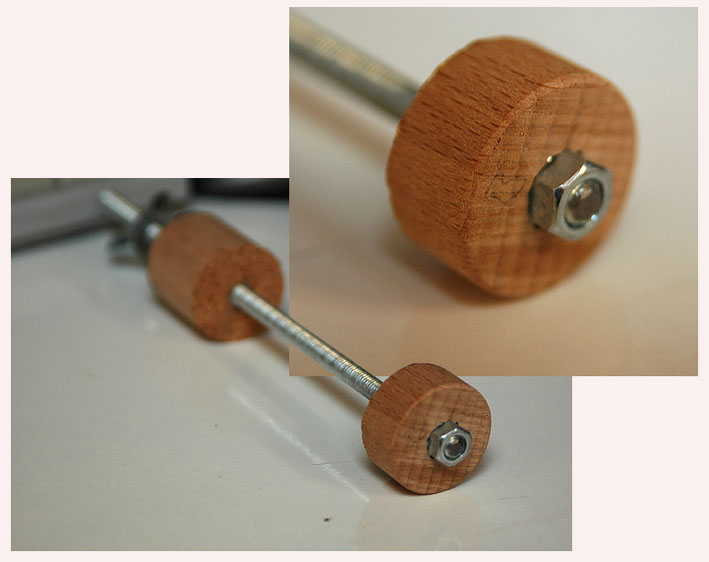

This was my approach to the non-wingnut end of tmy spool clamps: two countered nuts, one of them pulled into a 10mm diameter recess (= "small outer diameter" of a the M6 nuts I used). I had 30mm diameter beech dowel lengths readily available, otherwise I maybe would have used even rectangular plywood disks.
Here my whole spool clamp story (too many pictures, text in Spanish - don't worry about the text, I think my explanations were not very clear, and not necessary either, the pictures above show pretty everything of this high-tech project).

Sure, these spool clamps are some of my nicer shop made tools. I wish I had the patience and dedication to do all the jigs and tools like this.
When I made my first batch of spool clamps I also was worried about tilting of the top piece, this is why I made it taller, which is total overkill. In the next batch of spool clamps (for ukuleles) I made this top piece much shorter, it tilts a little bit (but really not much at all) and it is still overkill!
The nice thing with the shorter clamps was that I could use M6 screws with a hex head which now lies flat with the bottom of the bottom spool. The screws cost a bit more than threaded rod but besides of ending up with an even nicer spool clamp it saved me much work for not having to cut the rod lengths and for not having to tighten the countered hex nuts! This may sound like a minor issue, but remember, when using spool clamps you don't need only one or two of them!

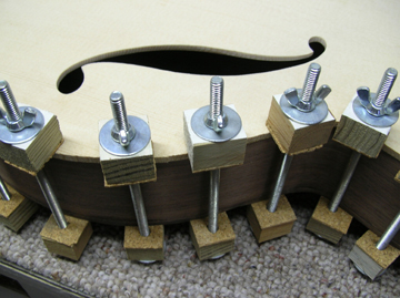

And, honestly, I've never been convinced that they need to be round spools. Certainly, they are much prettier tools if they are round. But that's not necessary. Mine happen to be 1" squares, faced with cork and center drilled and then with long carriage bolts threaded through them. They work perfectly well, whether using a corner to clamp, or a straight side.
- spool clamp885.jpg (118.54 KiB) Viewed 19948 times
