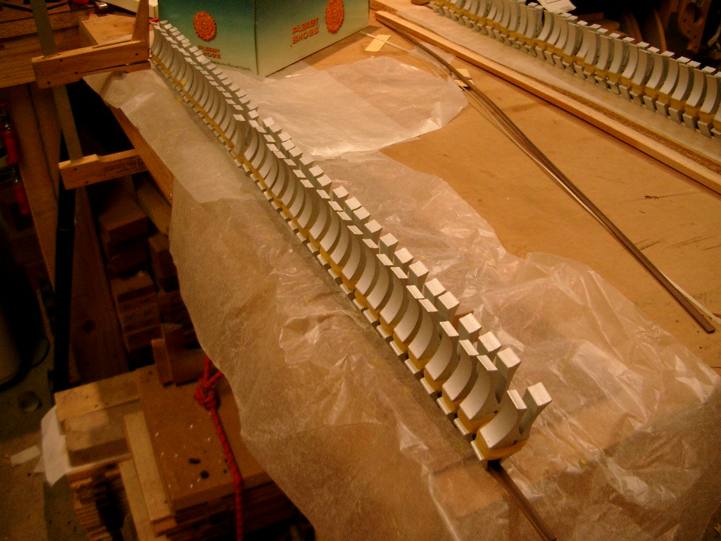

Photo shows Blues Creek Guitars binding clamps being used. I bought a bunch of these a few years ago but have found them a bit lacking in clamping strength. They can be beefed up by slipping on an extra surgical rubber ring but even then I find spring clamps do a better job for gluing binding on a guitar. For gluing purfs to binding they do the job fine.
