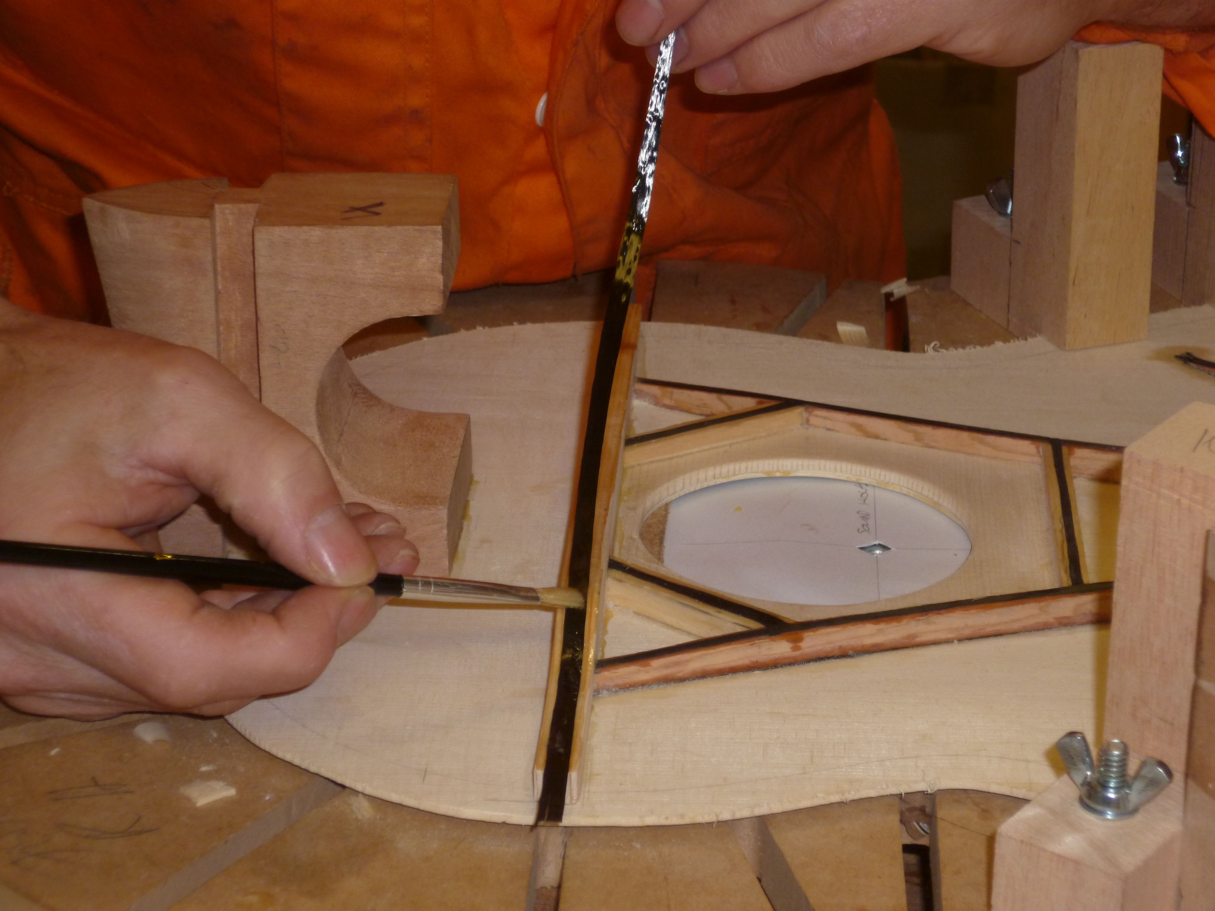

Yeah its a pain in the arse but Ive managed to tame the stuff. I use this tow which you can split into narrower lengths if you do it carefully and the stuff stays together: http://www.carbonfiber.com.au/prod44.htm In the photo Im applying a full width length of the stuff thats come straight off the roll. For the main braces Id use about 3/4 of the full width tow.Clancy wrote:Can anyone give me (us) some hints on how to keep CF Weave from fraying & falling apart once you've cut it to shape and before you can get it glued down.
The only way I managed was to put masking tape on it first, cut it to shape, glue it down and then tediously remove the masking tape after 12 hrs when the epoxy was still only semi-solid.
When Im applying the stuff I guide it on gently using a small paint brush. If a few fibres start seperating I gently push them back with the brush. If you start getting heavy with the fibres and spend too much time getting one stray fibre under control youll end up pulling off more fibres.
