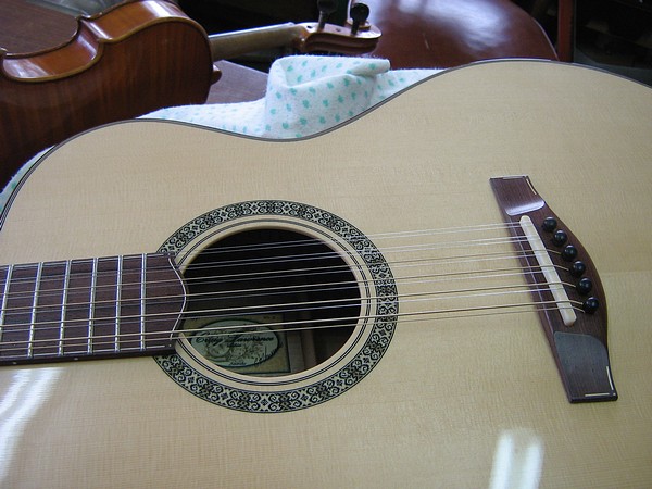

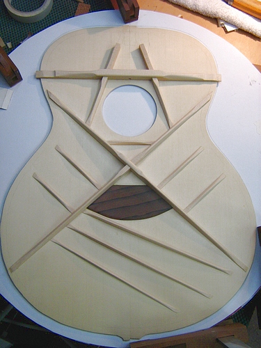

I don't have a plan for a 12 Alan , but my thread here will hopefully be of some help :
viewtopic.php?f=25&t=60
As you can see , my design included a 24.9 scale with a 13 fret neck. Not only makes it good to play but also saves a little stress on the neck.

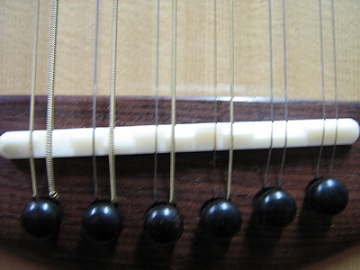

I'd also recommend making the neck plenty wide enough at the nut so as not to have all those 12 strings too close together . 1 15/16 " in my case and I think that should be minimum.
Include a wide saddle (5 mm.) so that you can compensate every string. This in itself, will make it head and shoulders above other 12's you may have played .
A shared 6 pin bridge not only means a smaller footprint , but also less weight . It's a tidy set-up too without strings nudging neighbouring pins.Here's a link to a tute I did on making such a bridge:
viewtopic.php?f=5&t=354
My first link will show you the bracing I've used . Note the A Frame bracing supporting the headblock. Again , to help handle the extra stress of a 12 string. The first lower face brace is positioned fairly close in to the bridge area

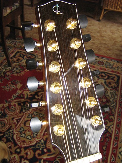

Be careful when designing your peghead . Draw it out to scale so as to not have strings running into other tuner posts :
