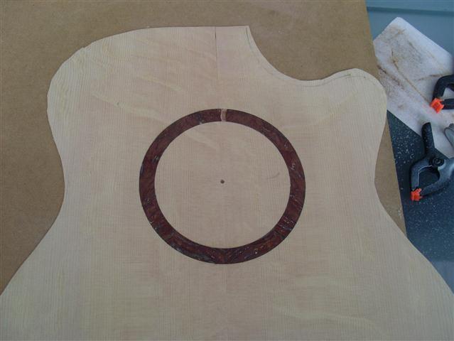

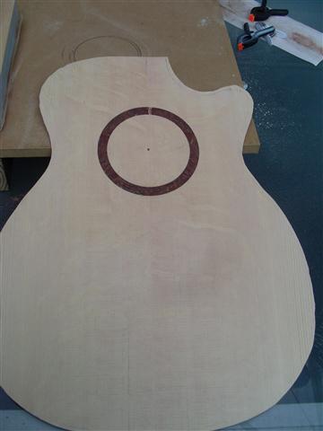

On a happier note, I made my first rosette for this one out of some jarrah burl, and am very pleased with the result of that, at least.....
