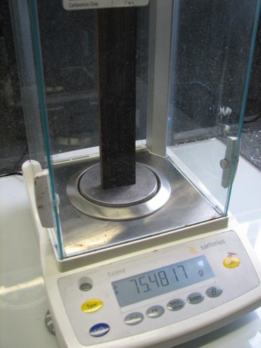

OK so I dug out one of my IRW bridge blanks that I've had in a climate controlled room for around 2 years now. Size of the blank is 38mm wide x 220mm long x 10mm thick. Next I weighed it using a 4 decimal place balance scale.
Bridge on scales.jpg (51.69 KiB) Viewed 19099 times
The weight, as you can see, came in at 75.4817g . I had to stand the sample on it's end, you couldn't get it inside the scale's doors laying down, the scales are so sensitive that even a breeze can change the numbers so they put doors on to eliminate the possibility of this error.

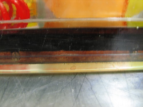

Next I put the bridge blank into a glass "Sandon" Chromatank that has a nice flat lid so as to slow down the rate of solvent evaporation. I also sat the blank on two round pins to reduce the amount of surface shielding of the wood to the solvent. Poured in just enough Acetone to cover the blank (500mls), heres a shot taken side on
Not very clear but then the Chromatank never was an optically clear bit of glassware to begin with!

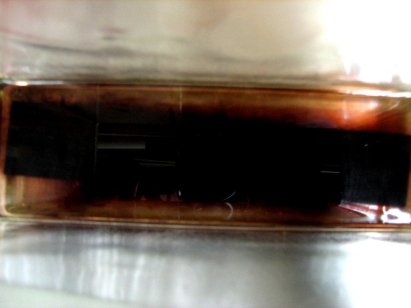

I was amazed at how quickly the colour started coming off the wood, here's a shot taken after the blank had been immersed for less than 30 seconds.

Also interestingly enough I was talking to the academic who's balance scales I used & he reckoned that unless the wood is 'just right' the Acetone will only absorb moisture & dissolve the oil from the capillaries of the timber, it's not very good solvent for diffusing across the walls & getting into the cells. He suggested that if you wanted to eliminate resins & oils completely then a short soak in Acetone for a day then swap out to Hexane which can diffuse across the cell walls far easier.
