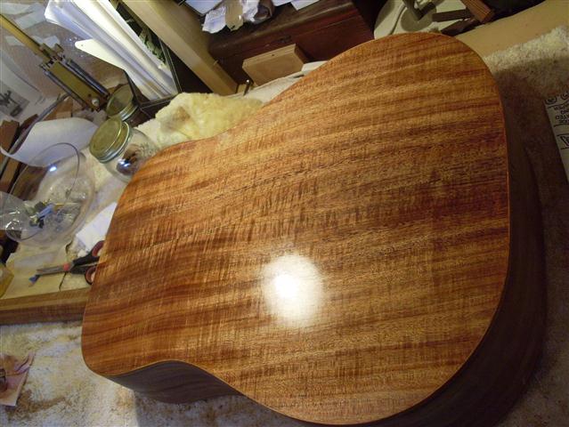

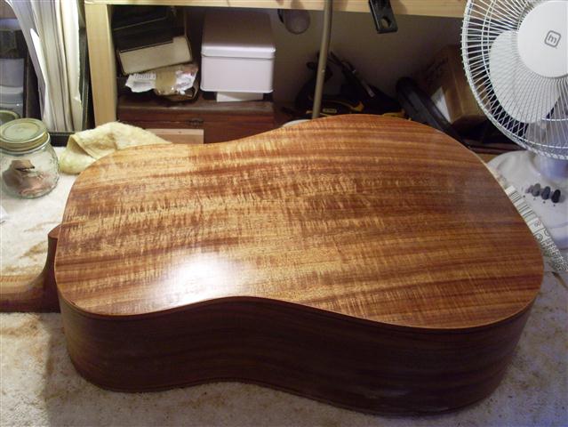

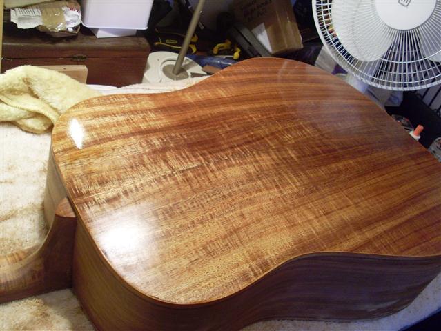

#2, after one pore fill session, and wet with a coat of shellac for the next go.....I hope that will see her done. Close now, but not perfect, and I'm spraying this one with Mirotone3220 High Gloss, so I thought I'd make her look, as Christian says "like a licked lollypop"

Nice Job Nick, make no secret of the fact that I luuurv Blackwood & your schmick axe just proves that!

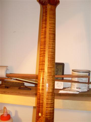

Nice one Nick . Slick looking neck.

Looks fantastic Nick. Nice blackwood.
Re: So, what do you all think?
Thanks for the blackwood Steve. I couldn't be happier with it.....

Looking Good Nick, And I'm with Rob here " Slick looking neck "

I think she looks great Nick and some nice fine figure in that blackwood.

I think it looks great, Nick. I just love the neck, that figure is fabulous!

looks great Nick a licked lollipop indeed!!! you gotta love the Mirotone 3220.!!
look forward to seeing the final pics !!
