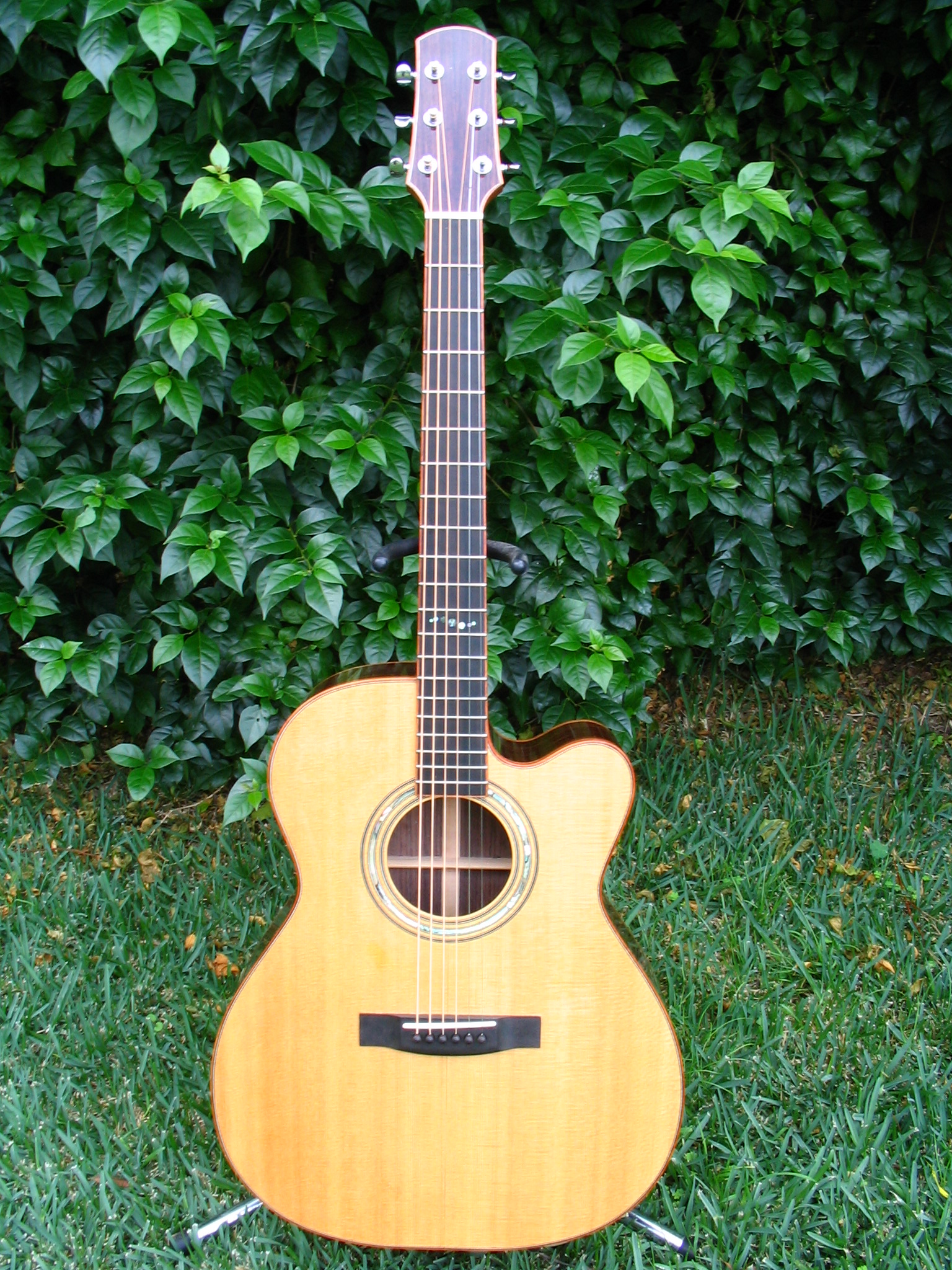

I had the same idea when I started my first. I built a neck out of crap timber and did such a good job on it that I ditched it and started again with good materials. I'm glad I did. I'd regret it every time I looked at the guitar these days if I'd gone the cheap option. Now every time I look at the guitar I'm still happy with it and the cost of materials is no issue at all anymore.
You only ever build your first guitar once, why not max out your chances of making a good one by starting with good materials? You can get decent materials without spending a ton of money - Sapele back and sides, Western Red Cedar top, etc.
Here's a pic of my first:
