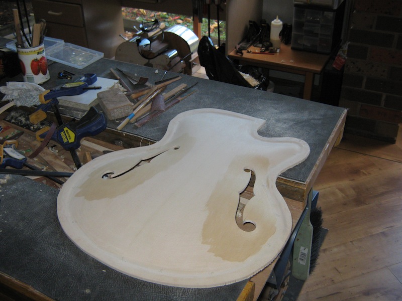

Just got this one out of the cnc room, rush job, cut the "f" holes and arched it simultaneously, just got to clean it up by hand now don't know where i'll get the time for that, never mind i'll save time on no bracing, that'll boost my bottom line! :roll: :roll: :roll:
