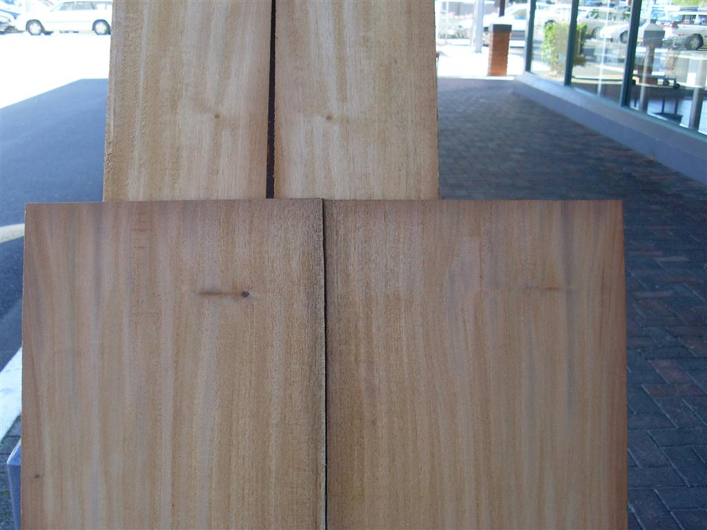

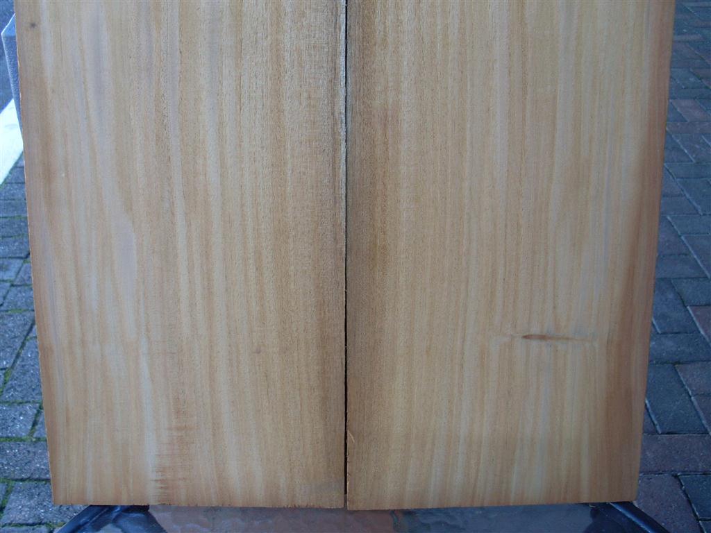

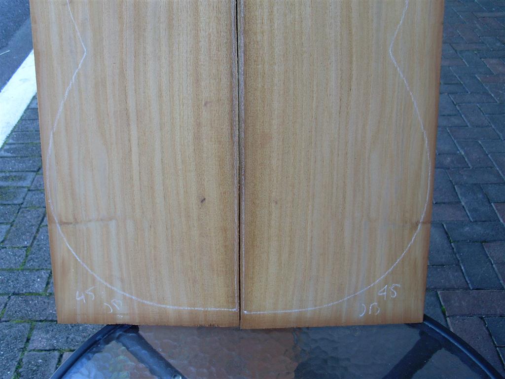

Got this mahogany pretty cheap, but the sample pictures I saw had no knots. I'm wondering if this is suitable for using as back and sides...
My first thought is no, but I wanted to ask....If the consesus is "no," I'll seek to have it replaced.. Sorry for all the pix, but you can clearly see the knots in these boards, and I'd be worried that at 2-3mm, and with vibration, there may be a tendency for the knots to fall out????
Re: Would you build with this?
You could always wick in a little thin CA glue Nick as added insurance on them knots but apart from that, it's amazing just what you can build with with modern glues/techniques. I'd say go for it, is it genuine mahogany (Swietenia Macrophylla) or Sapele (Entandrophragma cylindricum)? (Gawd you gotta love those Latin names
They sound soooo much cooler than the 'english' name) If it's genuine mahogany and it's cheap, it's always worth having in your stash! Even if it turns out no good for a full sized guitar then a ukelele or two will always fit the bill.

If the knots are tight, I'd build with it. But that's just me.

I'm with Lillian, especially if it is the real stuff (Swietenia Macrophylla). If it is the real stuff, go for it, it is CITES listed so you can't legally import any more of it as raw guitar sets. Small knots are unlikely to cause any problems, and as already suggested, a bit of superglue can do wonders.

Sapele, I reckon. It's definitely not from the americas....
I might give it a go, but will see if the seller will refund me something, or send me a set without the knots, as that's what I saw advertised....

It looks to me like it could be genuine Mahogany and probably as Bruce said plantation grown. A lot of it is coming on line now....from Fiji as well as indonesia....but it could be African Khaya as well....it is a bit hard to tell....I would say khaya before I said Sapele....
....would I build with it....yes...the knots look tight and wicking CA into them can only help to consolidate them.....

Thanks for all the input...
I've reached a deal with the guy I bought it off, and he'll send me another set--knot free-- and I'll give him a few bucks.
Then, I'll have a nice set for what I wanted to do, and another set for something else...
FWIW, I wasn't too worried about the sides, but the top has two long knots that have a void on one side of the upper and lower bouts, even on an OM, and they'd protrude through the edges...
Ande, it is plantation stuff from SE Asia, but I guess we'd all better get used to that....
