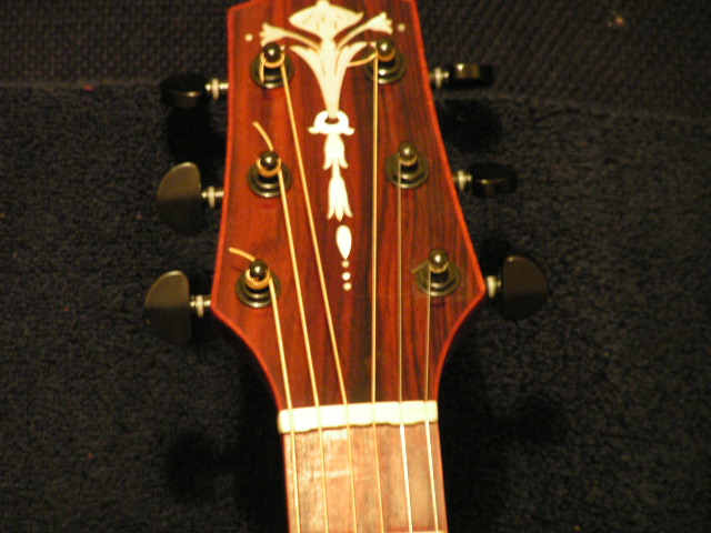

I have done two 6 string guitars and one 12 string using Trevor's numbers, he was kind enough to send me the numbers for a 24.9 scale..
I leave the fretboard at the normal length and add a shim to the front of the nut then carefully measure and file...the results have been very good with just a few cents difference up the scale..I use a 5/32 inch saddle which give me room to compensate ..
