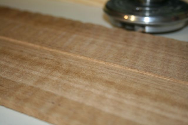

Here's the top glued together. It's King Billy that I got off Tim Spittle. I think that's a nice amount of squeeze out. It hasn't fallen apart yet, so I think my joint is a good one.

How did you find planing the King Billy top? Did it plane ok in both directions or is there a bit of runout?

I found that planing against the grain produced a bit of tearout. With the grain and diagonally produced some truly lovely shavings.

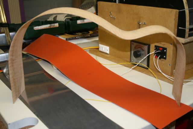

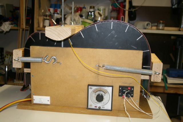

Once down to 2mm, I used my bending jig for the first time! Originally it was going to be heated using light globes. But, following some tests I switched to the heating blanket as the globes couldn't reach anythig more than 70 degrees. I put in a temp controller I got cheap off ebay, a K type thermocoupl from Dick Smiths and wired everything up. It works great, just dial in the desired temp and the internal relay switches power on and off to the heating blanket with less than a 2 degree hysteresis. For the bending I made a 'sandwich' of 20 thou aircraft aluminium - wet side wrapped in paper and aluminium foil - heating blanket - 20 thou aluminium.
Unfortunately I put the thermocouple under the waist clamp. :oops:
Here's the bent side. If you look closely you can see the ding where the thermocouple was pressed into the hot side. I was able to steam it mostly out with the wet rag and soldering iron trick, but it'll always be visible unless I fill it with some Apline Ash dust and some sort of glue. Other than that the bending went perfectly. I learnt my lesson from the first side and positioned the thermocouple at the end - in a spot that'll be cut away later.

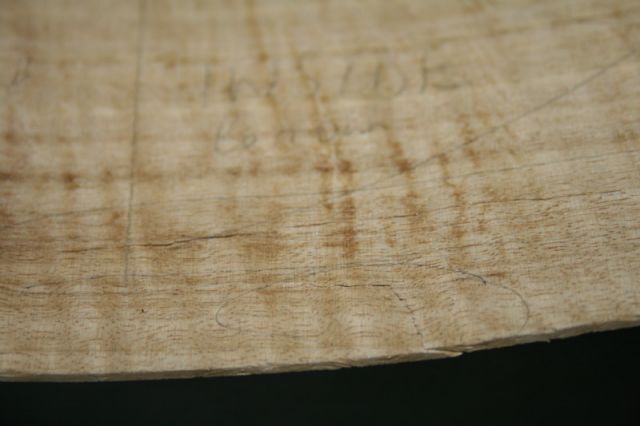

Another :oops: . Don't press too hard on unsupported sides! Here I get to learn how to repair a couple of cracks. I was so angry at myself that I had to leave the garage for a few days before I could bring myself to attempt the repair. The repair went OK.

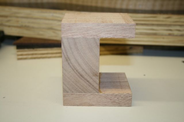

Here's my pseudo spanish heel blank. Pseudo spanish because I'll be bolting on the neck, rather than having the neck and heel block all in one.

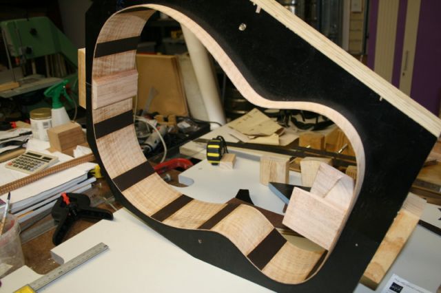

Sides with heel and tail blocks glued in.
Some side tape straight from Hesh's tute. Thought I'd give it a go seeing I'd already cracked the side :roll:
It's starting to take shape. A bit of a battered shape, but a shape none the less. I must admit to my impatience sometimes causing me to try and rush the process a bit... with the inevitable (and obvious in hindsight) results. Next up will be a little cleaning up, gluing in the kerfing and thicknessing the back.

I'm really liking your bending set up. Did you get the temp controller in Australia, or overseas? I've got a thermocouple on my blanket, but have just been using the blanket by turning it on and off manually.
