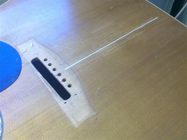

Found myself having to install a splint on an old maton top. (no Kim, the crack did stay glued but split along a new grain line 2 days later :evil: )
The splint went well but I'm wondering how to blend the new wood in.
I have limited resources here at the moment.
The owner doesn't care how the guitar looks, but I do.
Thanks

Re: Old top colour matching
Post by Kim » Wed Feb 08, 2012 6:04 pm
If you have limited resources Craig perhaps you could try staining the spruce to get it close with tea??? Work on a scrap to get dilution about right..I would normally recommend Tetleys or Amgoori but that light colour most definitely calls for a Twinnings Earl Grey I reckon. 8)

Post by Clancy » Wed Feb 08, 2012 6:42 pm
Good idea Kim.
I was gonna raid the kid's textas, but I'll raid the pantry instead.
Let's see...
Billy - no, way to dark. That stuff's like diesel oil.
Chai - uh uh, smell of cinnamon might distract player & listeners
Dilmah - hmmm, not upmarket but not 'bushels smoko room' stuff either. Might just be the go.
Will run some tests & let you'se know.
Will be sealing it with a few swipes of Hard Shellac which, unfortunately in this case, doesn't add any colour.

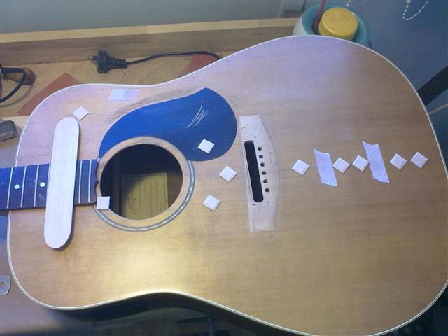

Post by Clancy » Wed Feb 08, 2012 6:47 pm
Just to add to this.
Here's where all the cleats & stuff went to re-enforce the repaired cracks.
(The masking tape marks where the braces are, which had also popped off, & were located using magnets)
Post by simso » Wed Feb 08, 2012 8:52 pm
Why did you terminate the splint in the body top area and not take it all the way to the edge.
Lot harder to hide a splint that stops part way.
Clancy
Posts: 620
Post by Clancy » Wed Feb 08, 2012 9:53 pm
That's where the crack stopped.
In hindsight I probably should have extended to the binding. :roll:
Next time.
Post by simso » Wed Feb 08, 2012 11:28 pm
Yep extend to the edge, it makes colour matching easier

Post by Clancy » Thu Feb 09, 2012 9:05 am
Thanks Steve, this is how we learn :D
Post by auscab » Fri Feb 10, 2012 12:06 am
Sealing it first for a touch up with the right colour should do,shellac, or a glue size can be good too.
Another thing to try on a test bit is Caustic soda, I know it turns a bright new white Baltic pine to a greyish almost green look . just the right strength could be a start. Looks like a spruce top? is it ? And it would just be a clear finish with the oxidised wood ?
