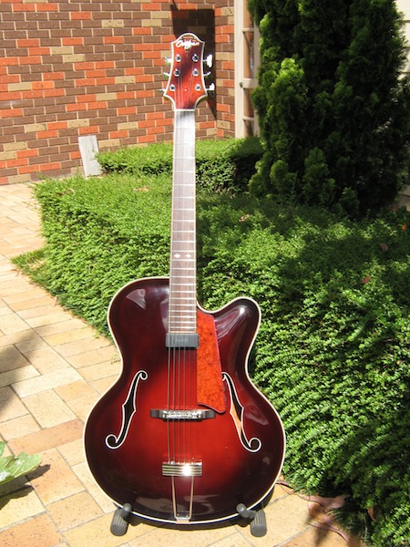

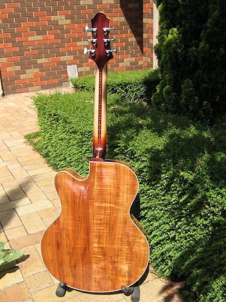

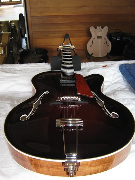

started this in 2010 and put it aside to work on another project and finally i've managed to finish it.
Blackwood b/s from Tim.
Engleman spruce top.
Maple and purple heart neck.
Indian rosewood fretboard.
Euca. burl veneers to headstock and finger rest.
Duncan Seymore suspended humbucker.
X bracing
25" scale ,22 frets

It's just gorgeous and that stripe up the neck has me envious.... but what I really what to know is how that Blackwood was to carve? The smaller bits I've done where no walk in the park

Allen, carving the blackwood wasn't a problem at all the only thing i don't like about it is the massive pores i have to fill, i think the issue of pores is exaggerated with arch tops because of the contours cutting through the pores on a very sharp angle ,but as far as carving!!! not a problem!

It's a beautiful archtop, Rod. I love archtops. Would you consider letting us know your formula for that nice top color? If my screen is not deceiving me, I'm seeing a very nice purple-ish, reddish brown in the sunburst shading and I love the color.

Gorgeous guitar Rod, another vote for that wine red burst, she's a class act head to toe.

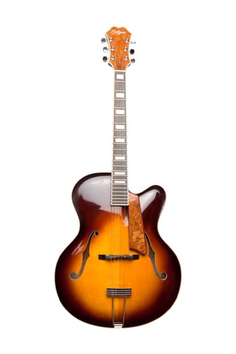

Thanks for the thumbs up you lot, yeah arch tops do have an allure don't they!. The s6 by Duncan Seymore does in comparison to the Kent Armstrong sound warmer, maybe a more contemporary arch top jazz sound i think. But i'm only comparing my builds with each other, most of my builds so far, differ in some way. This one has the Engleman and Blackwood timbers and a wide X brace with the S.D. pup. a previous build had curly maple and sitka timbers and a narrow Xbrace with a Kent Armstrong pup , the two instruments are as different as black and white, although they both have that hallmark sound you expect to hear from a nice jazz box, the curly maple build has a much more brighter tone, very immediate and responsive. Obviously when played plugged in, different pickups are going to have a varying effect on an instrument, but as acoustic instruments these two have shown me the difference that tone wood selection and bracing can have on basically the same design of guitar.
Patrick, no special formula to the burst, i used Colortone red mahogany stain on the burst after i sprayed the belly with a couple of coats of vintage amber to try to brighten that centre a bit.
