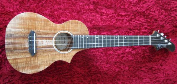

Here's a pic of a uke I was asked to make a couple of years ago. From memory, I just used lightweight Gotoh Telecaster tuners, of the quick loading variety with a slot in the tuner post where a hole shoud be. (Never did work out why they call them quick loaders!)
Cheers, David.
Cheers, David.

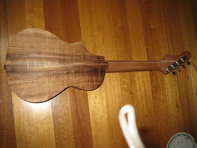

Sorry, I shouldn't write twice in a row. But I just found a picture of the back of that uke, which was also commissioned with a Fender-esque headstock. And yes, I've used four of the six Gotoh tele heads (or maybe they're Grovers) Either way, they fit alright but I think the peghead was made a little thicker so they didn't stick through too much.
Cheers, David.

- IMG_0262.jpg (53.01 KiB) Viewed 9574 times
