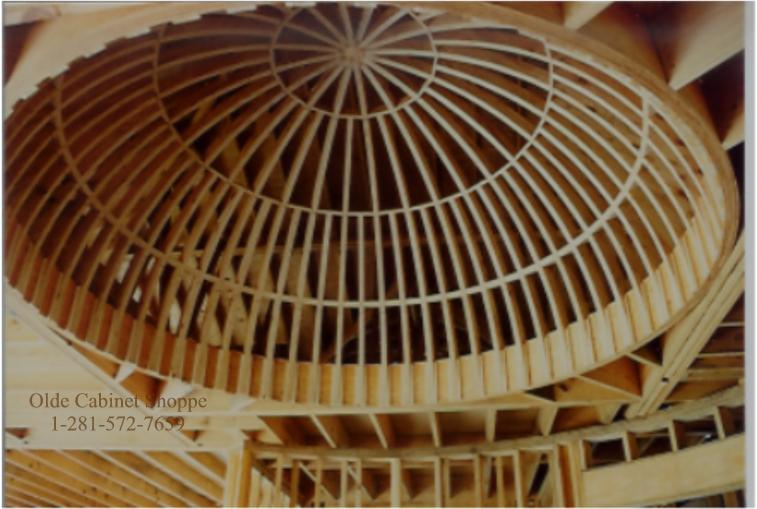

Here's how most people seem to approach framing on a dome....multiple cross braces??
- framing1.jpg (59.54 KiB) Viewed 15095 times
Re: Back Strip
Going with a Trevor Gore style back bracing on the current Pair
ie one brace across the centre of the lower bout with diagonal braces stiffening the surrounding areas
Plus transverse braces across upper bout and waist
