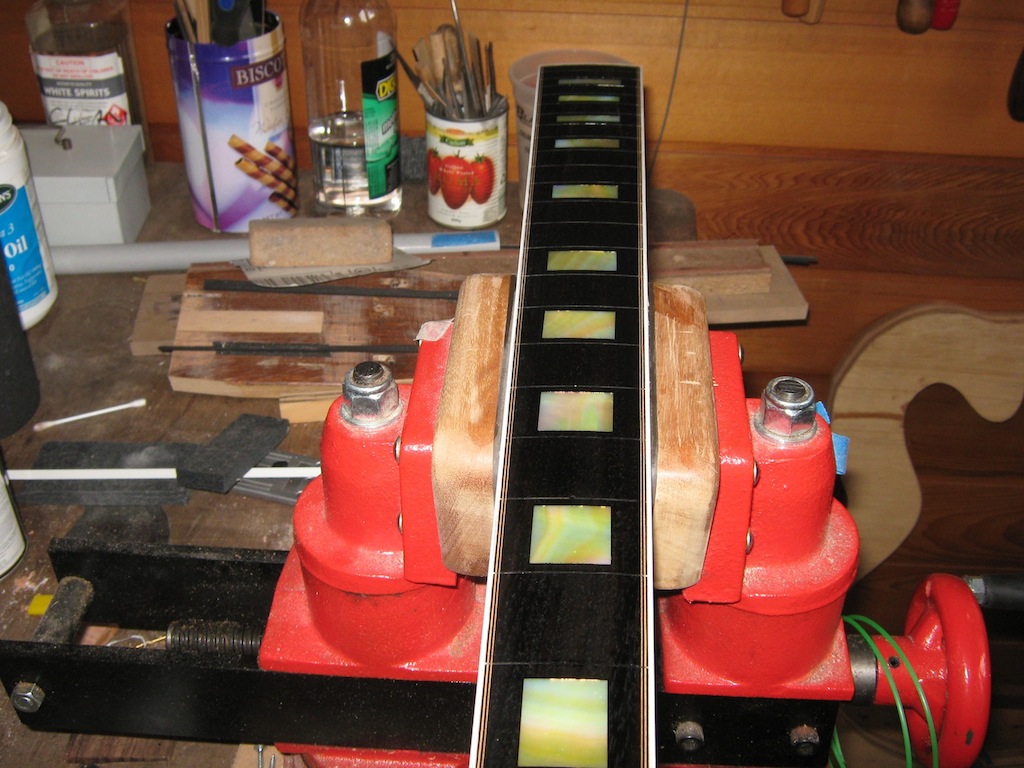

I finally worked out how to resize pics on my new puter, anyways here's some pics of the gold mop. inlay as proof for my mate Nick :D :D

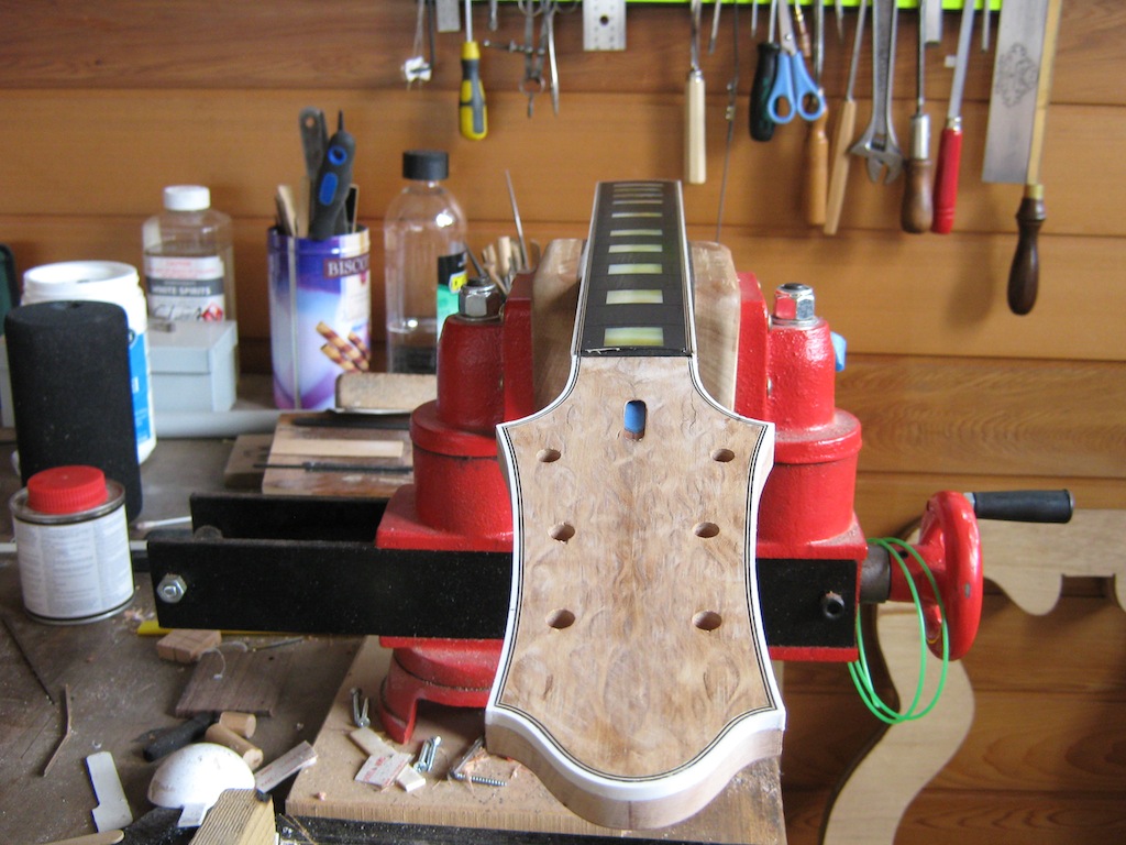

Post by rocket » Sun Jan 15, 2012 9:47 am
Another

Post by Nick » Sun Jan 15, 2012 9:49 am
Thanks Rod, you're a star! :wink: :D :D Nicely bound board by the way, they always look good when the headstock purf runs into the fingerboard I think, just adds that 'extra' touch.
