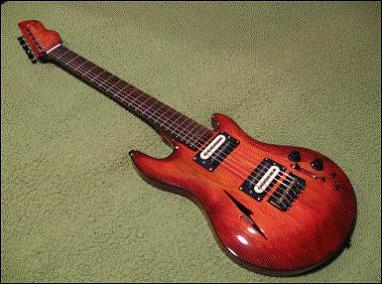

Hi Bruce, one of my earlier Telecasters was 'hand' burst using water based stain & a rag
As you can see you don't get a definite line at the change of colour but on this particular guitar it really suited the look I was after. I really overdid did the wet, let dry then sand trick to make sure there wasn't going to be any chance of grain raising once I'd started laying on colour, think I did about 4 days worth of wet/dry/sand cycle, I really didn't want to have to sand grain nibs off once the colour went on! I laid the base colour down first by wiping an even coat of the yellow warmed up with a bit of amber mixed in, I then wiped the tobacco brown on around the edge, this did give a definite line where the rag had been but I wasn't to concerned at this stage. I did a couple more coats of the brown (letting it dry in between) to build up a good deep dark brown (almost black) because my next step was going to remove some of the brown. The next step I just soaked a rag in water and 'washed' the delineation line that was there, this had the effect of removing some of the brown but it also merged the brown into the yellow amber base. I basically kept ringing the colour out of the rag & kept wiping plain water over the stain until it had gotten to the burst I was looking for. I tried to stay away from my dark edge as much as possible, it gave a really nice graduated burst & being water based really showed the curly maple top off which is the beauty of stain in the wood rather than over it.
That's pretty much how I remember doing that one anyway, it was a few years ago I did that!

That's a classy piece of work there Nick.

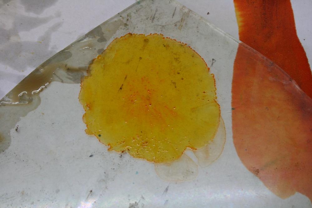

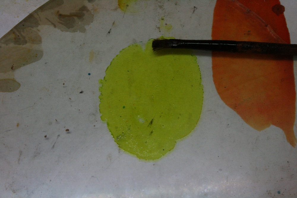

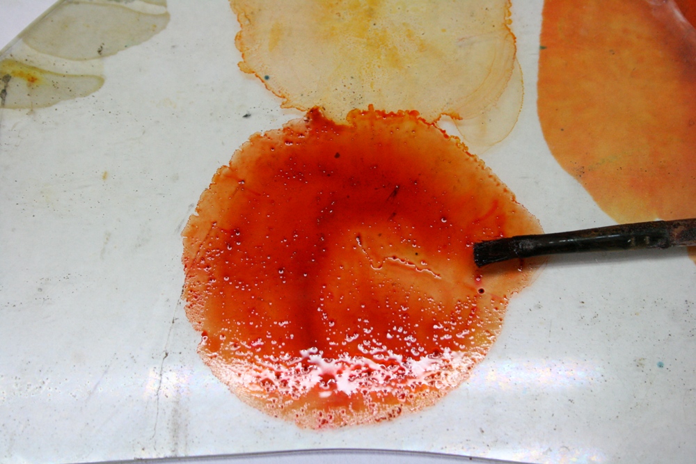

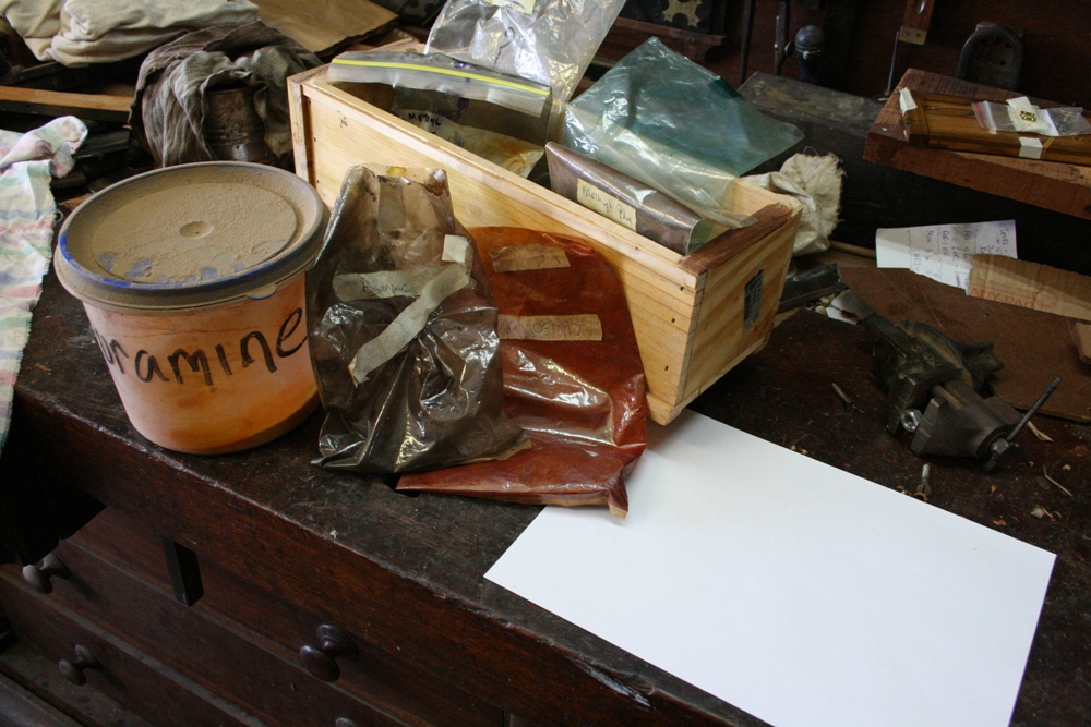

Hi Bruce,
I want to do a sunburst one day by hand, and seal the colours in between poly and FP or just FP.
With furniture I use Vandyke and oxide colours like yellow ocher or Brown oxide or Black oxide to get good strong water based colour low down in a polish job , and also in between coats of shellac,
And to send colours red or yellow in subtle directions ,or to make stronger colours or even stains I use these spirit stains in the pictures, they come as a powder , mixed in with just metho or different strengths of shellac, they can be made as weak or strong as you like.
One way of slowly and accurately applying these colours is with a french polishing rubber,
Another colour I did not take a photo of is spirit black, and we also have blues and greens some of those may be water based I would have to check.
I think they will work for a sunburst by hand, I just have not seen it done yet.if you need to see more just let me know.

Re: Sunburst finish.
The colours I pictured are on glass over white paper.
the top is Auramine
then Bismark Brown
then Chrisodine
the top is Auramine
then Bismark Brown
then Chrisodine
