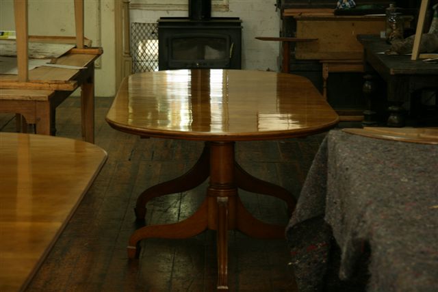

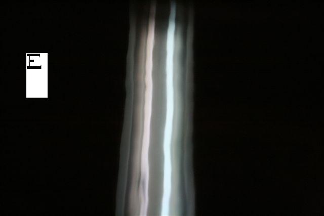

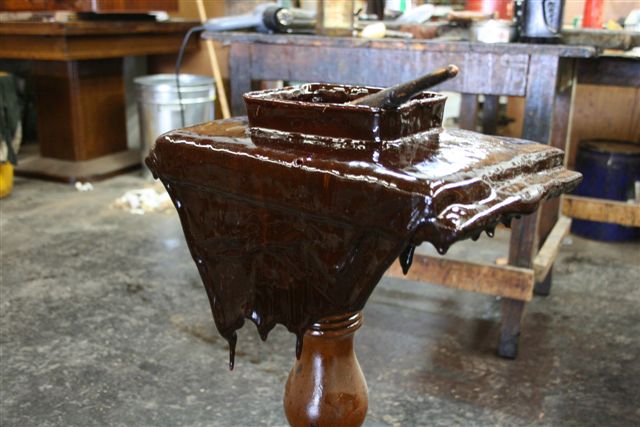

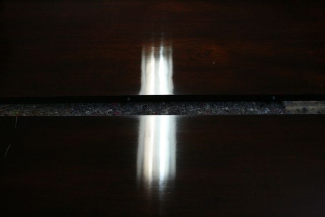

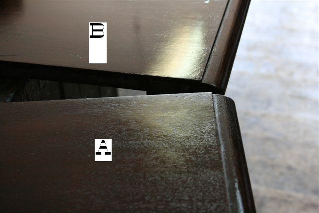

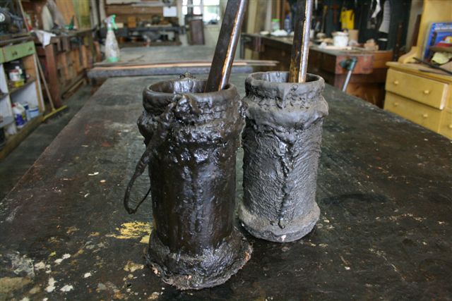

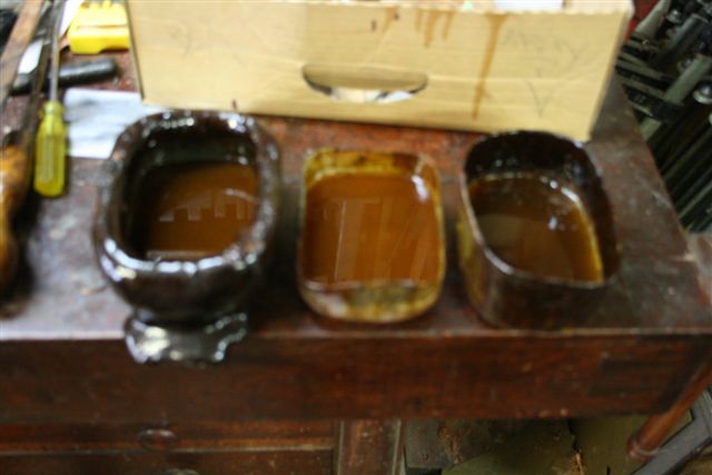

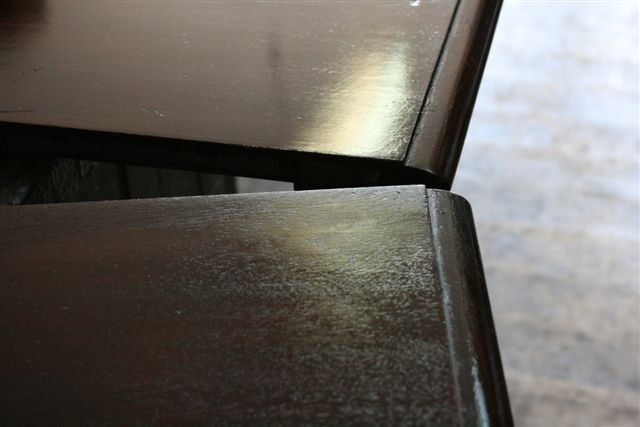

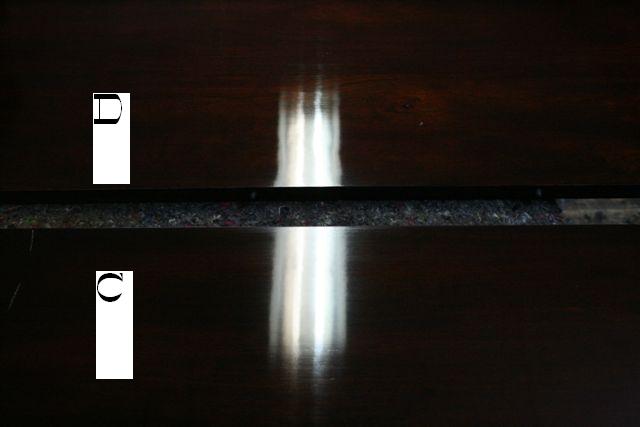

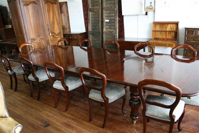

Re: My source for Walnut Oil
Some pictres
- IMG_7945.JPG (64.5 KiB) Viewed 23668 times
- IMG_7946.JPG (68.71 KiB) Viewed 23668 times
- IMG_7940.JPG (60.19 KiB) Viewed 23668 times
- IMG_7917.JPG (41.84 KiB) Viewed 23668 times
- IMG_7916.JPG (14.72 KiB) Viewed 23668 times
- IMG_7918.JPG (21.21 KiB) Viewed 23668 times
- IMG_7696.jpg (22.63 KiB) Viewed 23668 times
- IMG_7682.JPG (37.3 KiB) Viewed 23668 times
- IMG_7143.JPG (43.93 KiB) Viewed 23668 times
Good job Rob. Good explanation, tech writing is a chore. How long has the pedestal been colecting polish?

The pedestal belongs to my Brother , it gets a fair bit of interest from people as they walk past it, he probably started it 15 years back, and it’s just the spillage from fast work, I asked him the other day if any of it was intentional ,” No “was his answer. One guy walked up to it once and snapped off the curtain of shellac, Brother was furious at him and glued it back on with super glue.
The two jars are what gets left on coffee jars from the linseed oil and turps mix.
And the three tubs of polish are all the same thing , the bottom cut off a 2 liter orange juice bottle . the one on the left the oldest and the two on the right new

I labeled these pictures [not very well ] A to E in the order the work proceeded, the way the light reflects off the polished surface shows it off well , the more the grain fills and surface becomes more reflective the better you can see the 40 watt fluro globes that are reflecting off the ceiling .
The wobbly effect in E is the flatness of the timber ,this table was all over the place and we had to copy that into the three new leaves, one of the nice things about hand planned and scraped furniture.
A is the first body session
B is after the first cut back and second body
C was a thin body session without oil ? I think
D was same as ABC plus one finish session with oil
E Was same as ABCD with either one oil finish job or two
Some parts of this job came up good with one oil finish some needed two , two of the leaves I cut back so hard that I showed up witness marks of previous layers, these two needed two oil finish jobs

OK....what part in the whole process does Tweety Bird play??? I suspect this is the key to FP the Auscab way.....
Tweety was just a way of seeing the reflection that I was trying out.
the lights were better.
