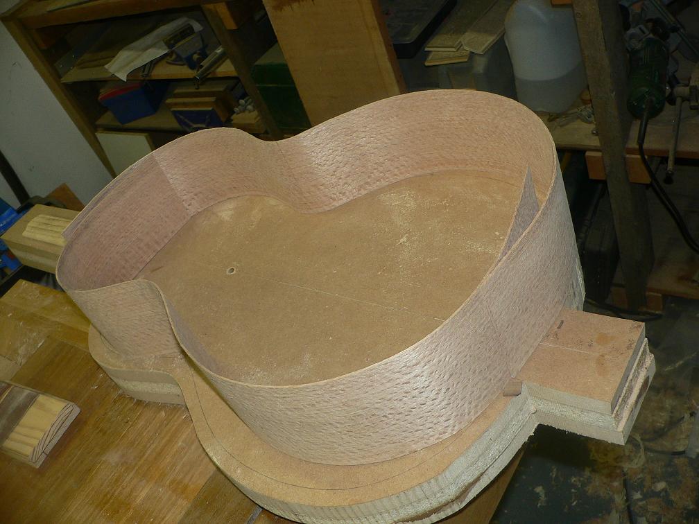

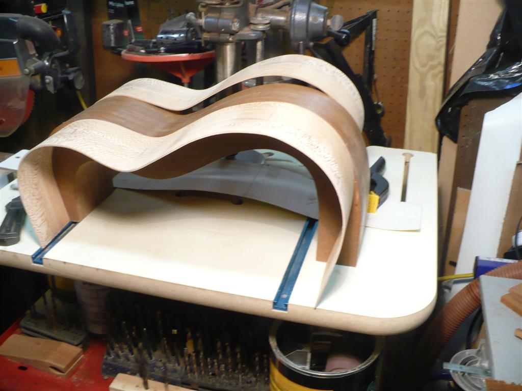

Here are the sides after drying:
Off the pipe, the ends of the lower bout were at 45deg to the centreline

Re: Side bending question
Looks like lower bout on side nearest to camera has a sharp bend in it.....or maybe thats just the camera angle. You could try reworking it on the bender. The sides will often not quite cross the centre line at 90 degrees but dont forget you'll have a tail block in there to anchor the butt end of the sides to and then youll have supports on outside of the sides...Im assuming youre building spanish method here.
In summary I wouldnt worry about the butt ends of the sides but id probably work on the sharp bend in the side nearest camera....bearing in mind that Im completely anal when it comes to things like this.

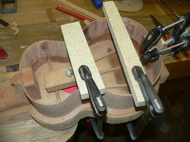

Building Spanish method, but without an outside mould. I'll get the sides close, and then clamp down like this:
but with more bars for the guitar, and tweak the sides to the template line. Using tentellones, so no glueing rush.

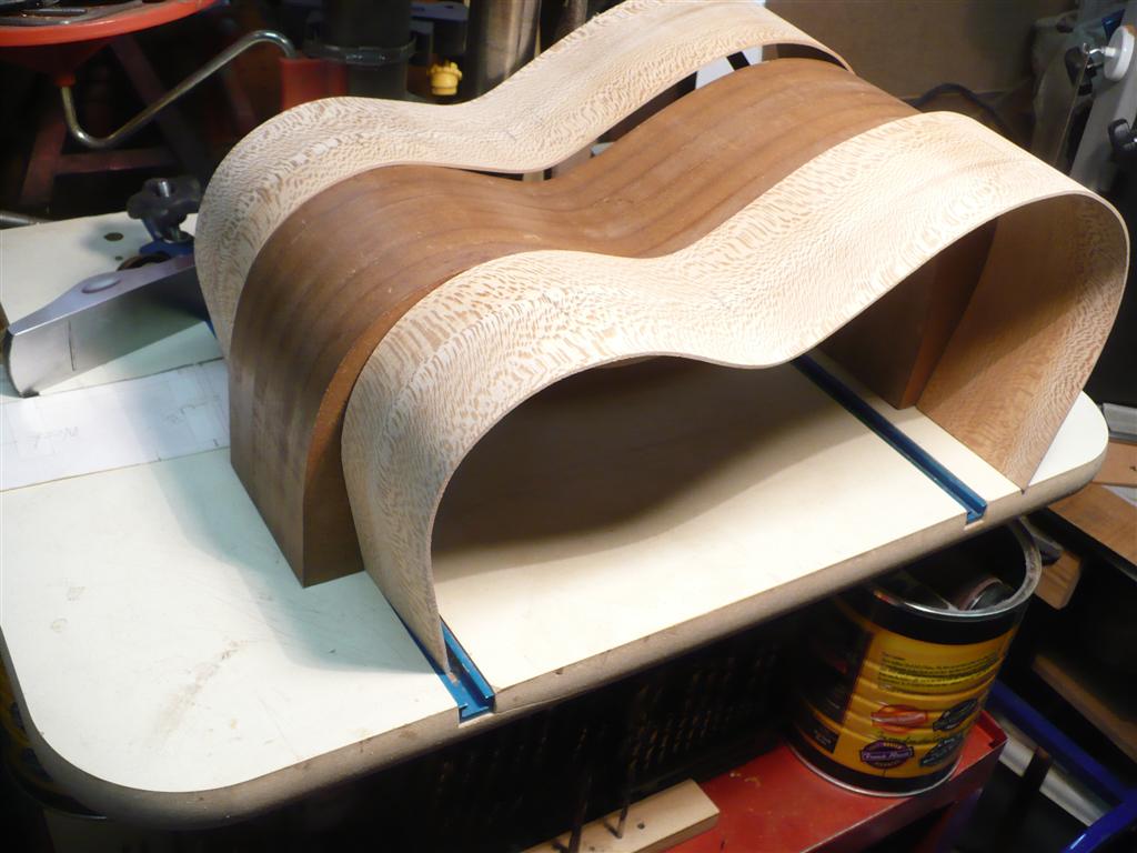

Interesting! I had a similar experience with my Sycamore bending. I did not soak the sides, but I did use a damp/wet paper towel over the iron to reduce scorching of the light colored wood. Bent them, set them on a form for a brief while, then set them off the form on my drill press table. Here are the results.Alastair wrote: Lo and behold, when I came into my sun-warmed shed next morning, they had NOT sprung back; they had in fact increased the bend as they dried, even to the extent I’ll have to do a bit of straightening to get back to the template.
