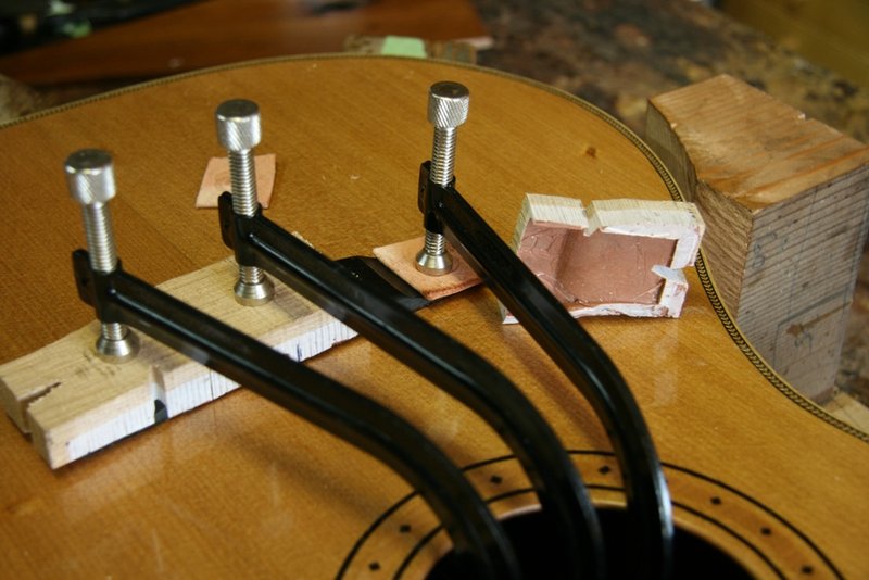

Reading about bridge clamping made me think I would show the way I did my first one.
Its more involved than some of the ways that I have read about , but I thought it gave best pressure through the top to the bridge plate and braces on the inside ,and to the bridge on top.

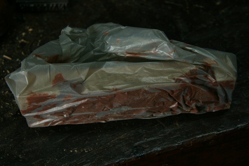

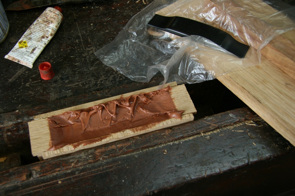

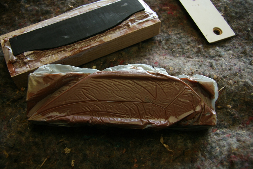

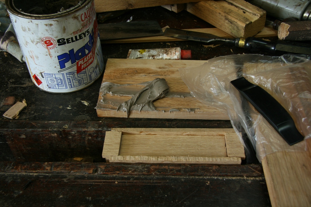

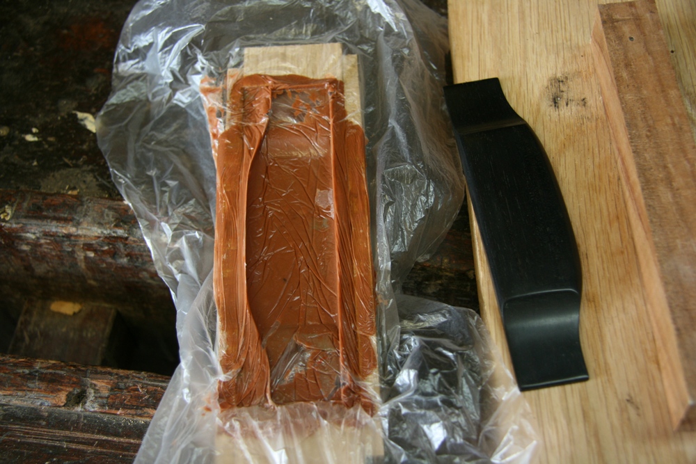

I made up an inner and outer caul by using Plasti bond on a block.

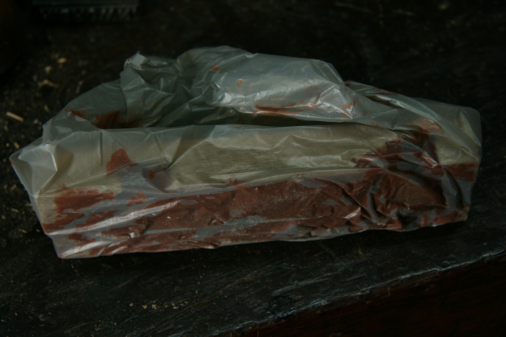

The inside one had notches for the braces, I put the Plasti bond on the block , put it in a bag and pressed it in till it set.This gave a perfect fit across the bridge plate and braces at the same time

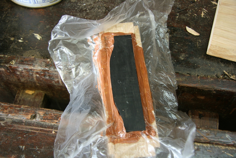

I scribed a line around the bridge and took the top back to bare wood
The inner caul was fitted ,double sided tape held it up.
The top caul was trimmed down and cut in three,

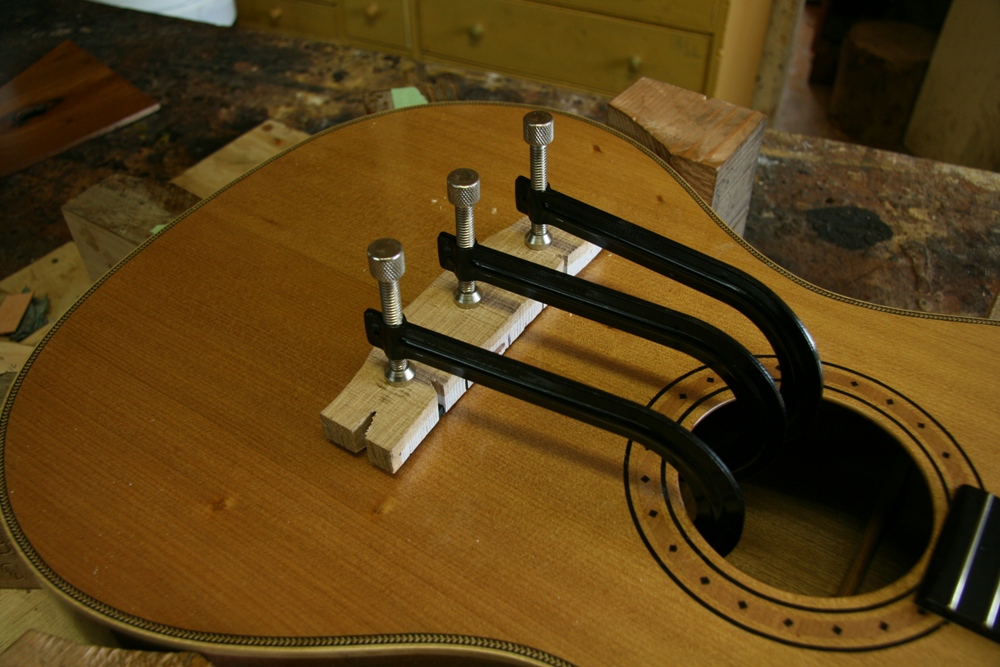

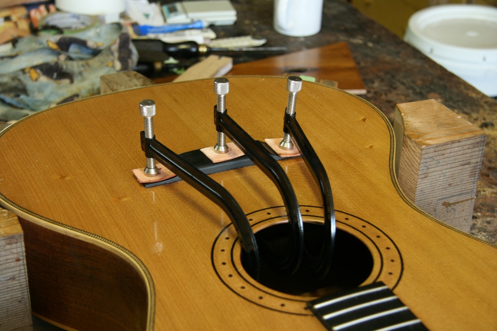

I Glued the bridge down with hide glue and three leather pads so I could line it up,
[bridge in the micro wave for 25 seconds]
When I was happy with the position I took of the middle leather pad and put the Middle top timber caul down first, then the left caul ,then the right
It worked well , though next time I do this I will shave back some of the plasti bond from the middle of the top caul so the outer 5mm gets the best pressure,
I would keep the plastic lining on the top caul as well,
I didn't take a picture ,but when the top caul was first made it took two goes to get rid of the air pockets from the first cast, I drilled a fine hole from inside the air pocket to the out side ,filled it with to much plasti bond put the plastic back and then pressed the bridge back down, excess plasti bond leaves through the drill hole to the out side.

Three go on to get position and glue squeeze out , that's 15 to 20 seconds then one at a time they are replaced, within a minute its over and there is always 2 clamps on

Or if it stepped over the brace its not putting pressure on the brace, unless you make it before the top goes down, so thats a curved solid caul with two steps that match brace height that you have to make , a bit more tricky than plasti bond [ PB ] in a bag in which the solid block is a loose fit by 3 to 4 mm all around and the PB molds to the lot.

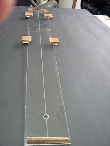

Two steel 1/16 " locating pins through the saddle slot which I remove after the glue is dry. This way I can take my time and make sure of bridge placement prior to glue -up. I made this jig for accurate placement of the location pin holes.
NECKBRIDGE JIG 31.jpg (46.25 KiB) Viewed 7537 times
More on how to make (and USE )this jig here" viewtopic.php?f=24&t=2001
As far as the inside caul is concerned , I radius the glue side of the bridge plate/patch and therefore only require a simple flat caul for the inside .
Radius the bottom of the bridge and be fussy about it!! . I have my top caul ( similar to the Stewmac one ) a hair smaller than the bridge footprint so I can easily clean the glue squeeze-out
