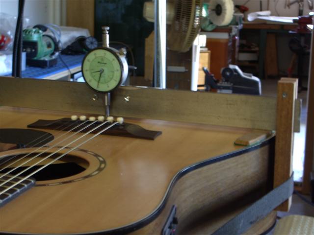

Heres one of the gauges I have used for the past few years, I have another without the dial. workshop made.
IMGP3238 (Small).JPG (42 KiB) Viewed 14648 times

I do lots of work [repairs] on guitars with high actions , the problem is often traced to the top radius increasing or the top bellying up. I like to measure the difference between strung and unstrung, the difference can be up to 1mm or more in some cases. After the corrective surgery I can properly assess the success of my work with known facts not estimates. The customer can be advised properly of the amount of correction that was needed and not squint between my fingers as I try to show the difference in before and after. I record this on the job sheet for future reference.
Also when setting up my new guitars if I know how much the top raises under string tension it aids in the set up process when the strings are of.
As to cost and waste, not I, I use the same dial gauge on many different jigs as it uses the same method on fitting.
