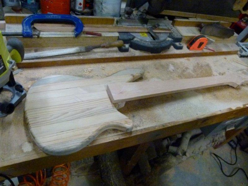

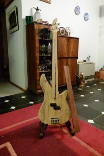

Post by Presto » Mon Aug 01, 2011 10:59 pm
I thought I should upload some photos of our work so far!
Much fun and dust has been made!
