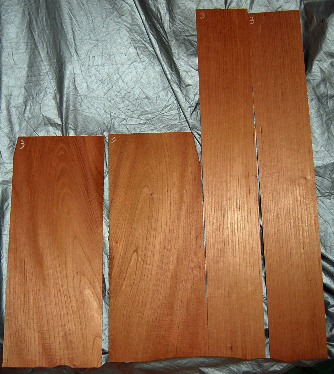

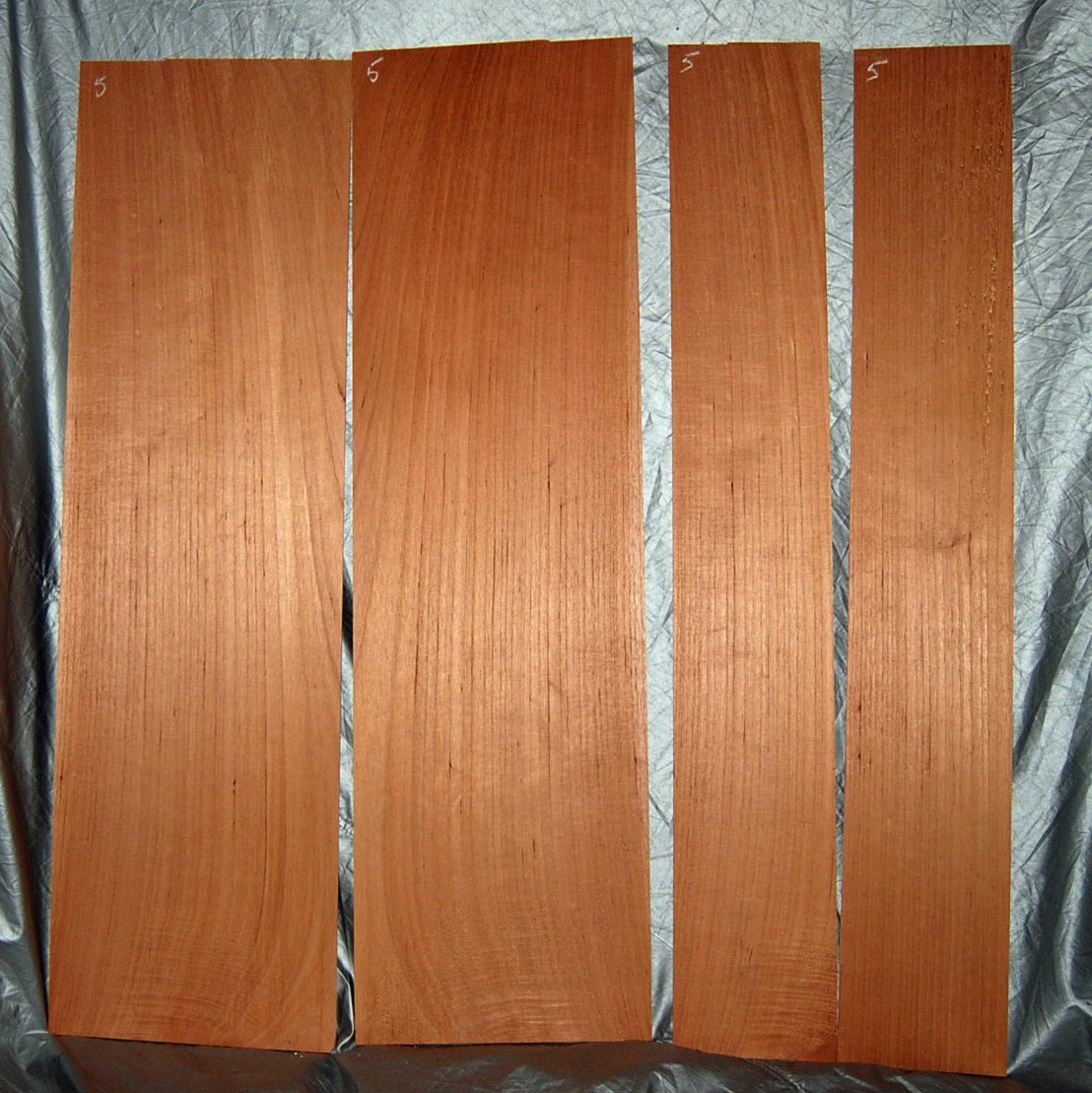

I cut some red cedar sets a year ago and found they weren't that popular. I suspect the large poors and softer timber might not be as good as other timbers acoustically. Red Cedar that has closer grain and greater density might perform better. Pictured are a quartersawn set and a back sawn set. Really only experimental quality.
steve
steve
