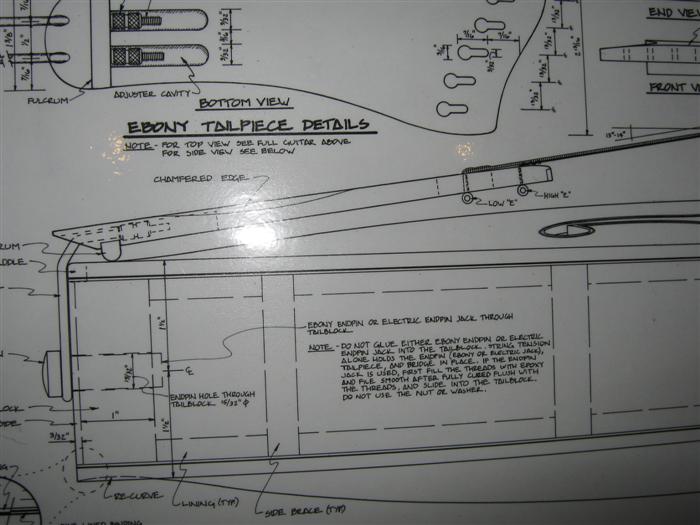

Rod: Thanks for your information and the pic of the tailpiece on the plan. Very helpful.
Mike: Thanks for your dimensions too.
