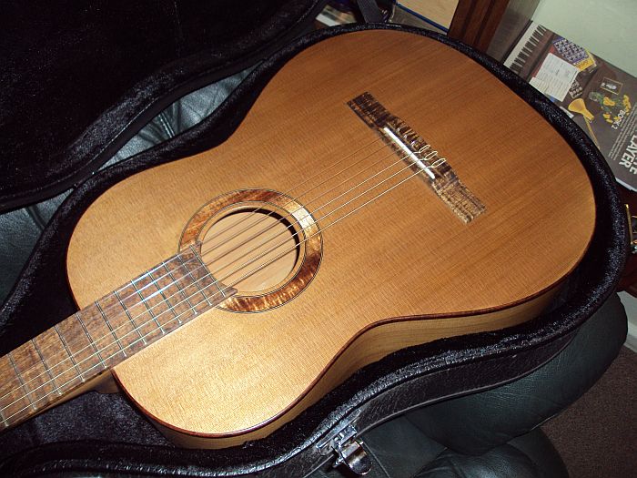

Hello all ..
Long time since I posted anything .... no excuse other than being a ludite with IT. However, the inimitable forum member John Maddison has tuned me in. So ... here we go.
I made a classical guitar and several players played it one afternoon.
They all had a different attack. One made it sing, one made it rattle, one was lost, one moved his right hand up and down and found the "sweet spot". All good players.
Question is .... if you are commissioned to build a guitar (instrument) for someone, how do you evaluate the right hand or attack and relate it to the build. In other words hard or soft strummers and / or hard or soft pickers and styles of music ???

Must also add that the top on that guitar has so much silk it should be illegal...were'd ya get it?? (EDIT: Sorry Pete, have just noticed that your image note advises that this amazing cedar top has come from our very own Tim Spittle....must give him a call, its been too long)

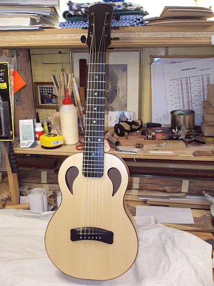

Thanks Kim and Allen .... will post some more guitar pics soon, but in the mean time ..... I built a small guitar based on a Tacoma Papoose.Kim wrote:...and don't be so bloody stingy with your images...we 'demand' more!.![]()
Scale length 19" ... tuned to A (equals full size with capo on 5th fret) Baritone uke body shape and size.
regards Pete

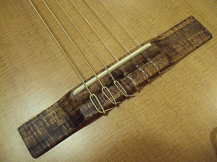

Did the bridge come from Tim too? I have been thinking about ordering a couple of those - your picture just made my mind up.

Peter...It looks a very elegant guitar indeed
I really like the bridge...it is different from the bog standard rosewood that most use (myself included) ...it is the the thing that I noticed first...

BTW....have you used a satin finish on your guitar or is it a trick of the light? If it is satin what did you put on it, Thanks.

Regarding the guitar in the first picture I agree with Kim: it is one of those MASE - Guitars! (Maximum Amount of Silk Exceeded). And the figured bridge really takes the bisquit!
The combination of this super silky top and the chosen bridge wood is a real eye-catcher!
The small one has that kind of soundholes I really like but have cause me quite a bit trouble because I had pushed it to the brink.

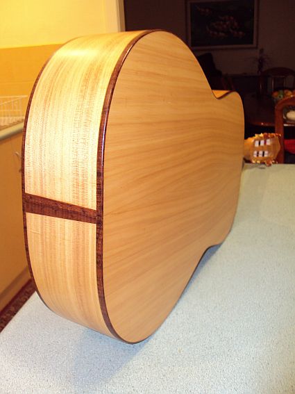

Hello again
Thanks to all for the comments, thoughts and greetings.
John ... the finish is Mirror tone 3220 30% gloss. My mate and mentor Maurice applied the finish so I can not claim that aspect of the build.
Richard ... the bridge and head stock came from an offcut from Tim. I was after a theme and he found (who knows how) a finger board match.

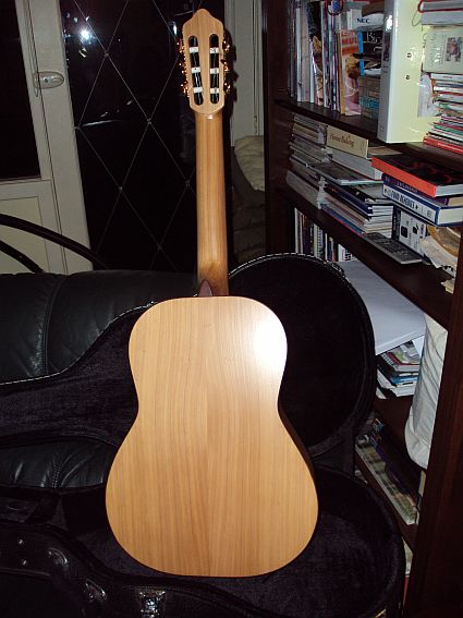

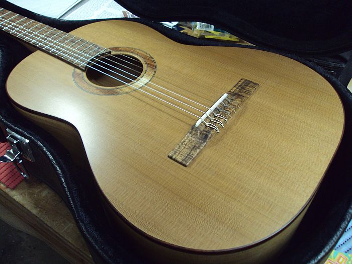

These are some more photos (as requested) out of the box.
Thanks again everyone for your thoughts and greetings.
Regards Peter
Regards Peter

No pictures of the matching headstock? but that bridge gives me goosebumps everytime I see it
Rest of it's not too shabby either
Nice job Peter.

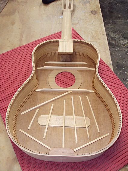

Your work is always inspiring Pete. You should show it off more often. I really like that bracing pattern. May use something like that on a Baritone Uke.
