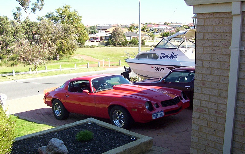

This is the paint from 6 years ago, its gone faded now "metallics got to love them"" - not...
Probably paint her again this year maybe, if I get the chance. And just becuase I own one does not mean Im a red neck...Well maybe I should put some down south mississipi colours on it... ye ha

My first thought was you must work in the mines.simso wrote:This is the paint from 6 years ago, its gone faded now "metallics got to love them"" - not...
