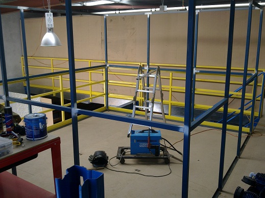

Original layout boxed into a frame, no roof / doors / filter boxes or anything yet.
- Booth 2 shop.jpg (105.98 KiB) Viewed 24164 times

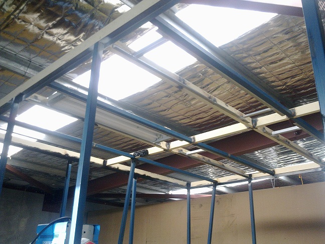

Next photo, the roof.
Theres also recess's in the frame work for 4 fluoro lights to sit external to the booth, you can see one of them sitting up in there at the moment,
Once the sheeting is up, just have to have glass fitted to the light openings and silastic them in place, then the lights simply sit on top of the glass, this complies with the safety requirement we mentioned in the earlier post
- Paint booth shot 3.jpg (162.37 KiB) Viewed 24150 times

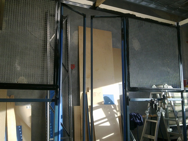

Only a couple more to take me up to where I actually am.
This one is now the entrance side of the booth, the mesh area is for locking inlet filters into place, below that is simply going to be sheet steel. The filters being high allow fresh air to be drawn in, not air from the floor, I went and had a look at a few commercial paint booths and there filters are above the booth and come in the front through the roof, I didnt go this option becuase we do a fair bit of woodwork and I could just imagine within a month how much dust would realistically be sitting on the roof.
- Paint Booth shot 4.jpg (157.92 KiB) Viewed 24148 times

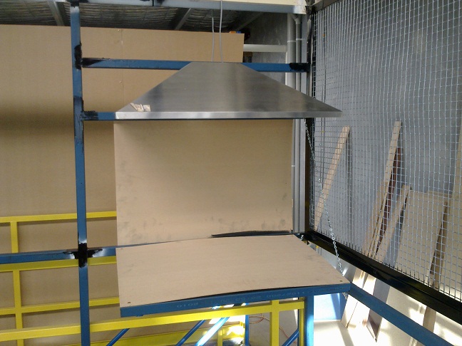

Now Im working on the extraction area of the booth, making filter cartridge holders, ran out of steel, so its not going to be done this weekend, have to wait for next weekend to finish that one, at least I get a break from welding.
Man this is a bigger job than I thought to start with.
