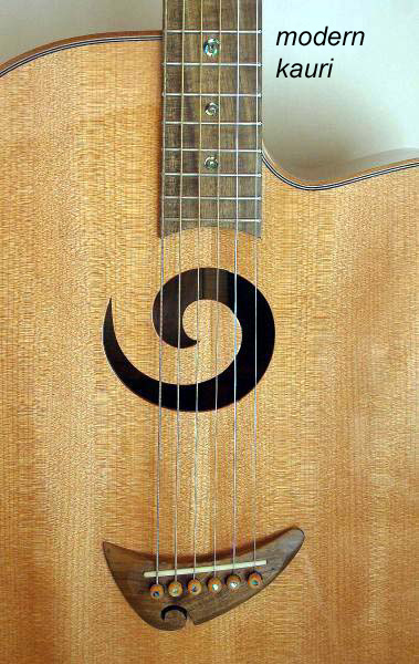

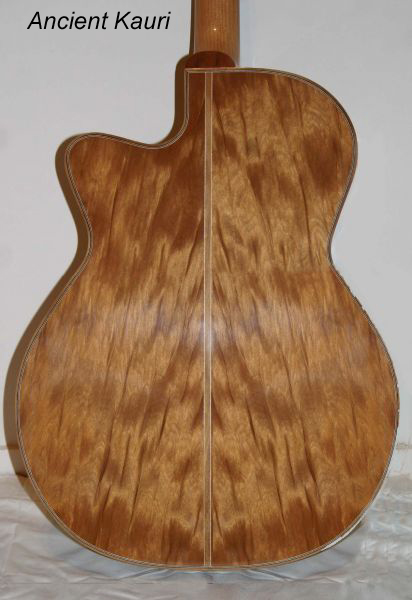

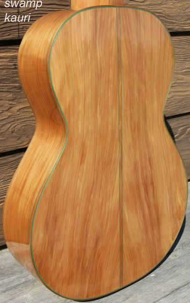

Re: Benefits of age?
Just in addition to my rambling above,
ive attached some pics that may be of interest it illustrates clearly the grain and colour differences of the three types of kauri i use.
one of these days i'll get around to documenting and recording the tap tones of some of our native timbers, would be great to hear side by side comparisons, you guys could add your own timbers could be a great resource, and open up loads of discussions on potential new couplings of instrument timbers.
Christian
Christian
- ancient kauri.jpg (115.65 KiB) Viewed 8508 times
- swamp kauri.jpg (97.28 KiB) Viewed 8508 times
- modern kauri.jpg (141.45 KiB) Viewed 8508 times
