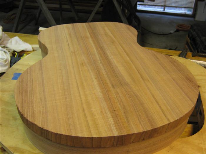

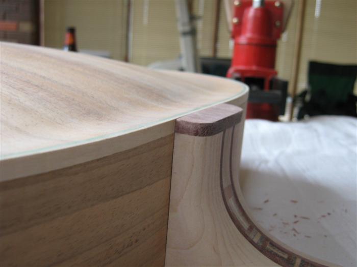

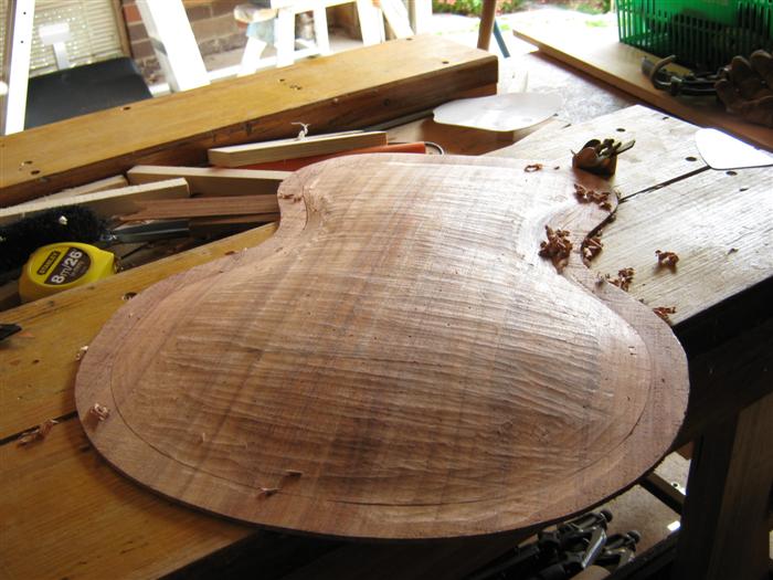

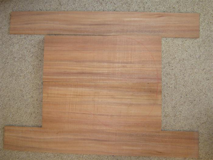

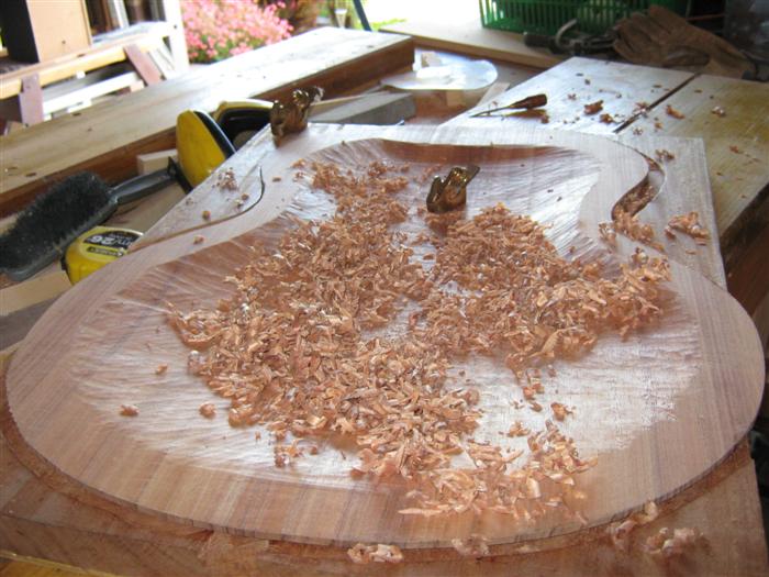

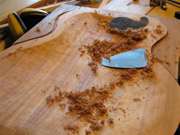

Post by rocket » Thu Jun 09, 2011 7:06 pm

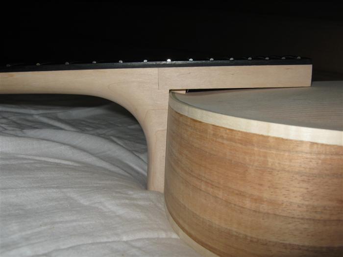

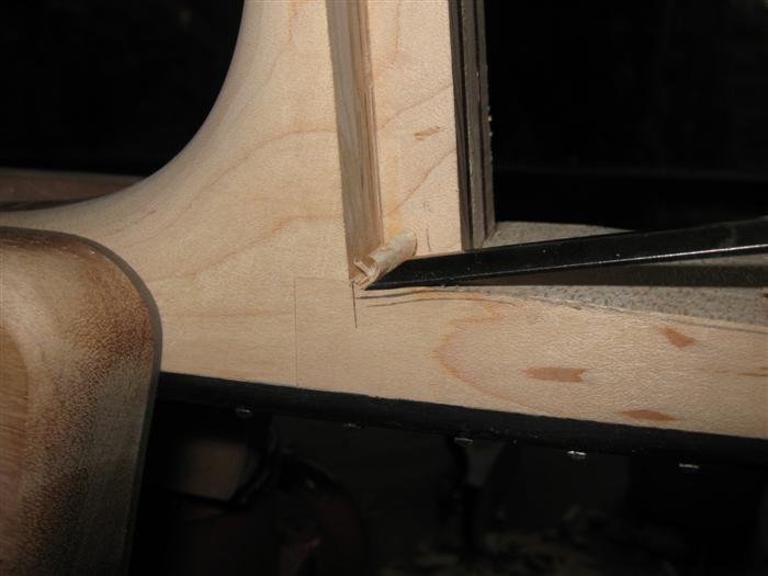

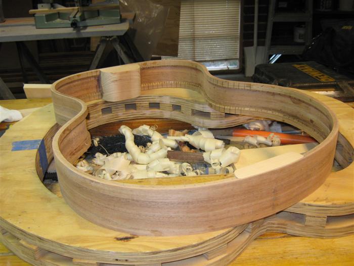

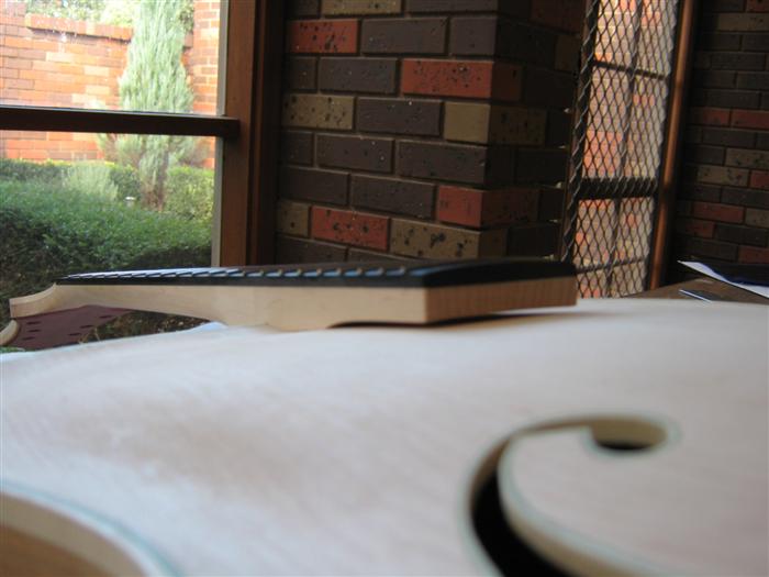

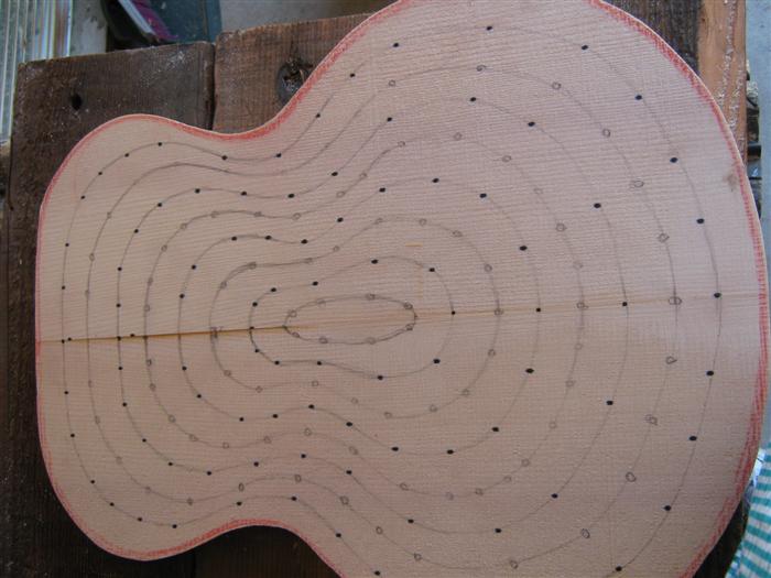

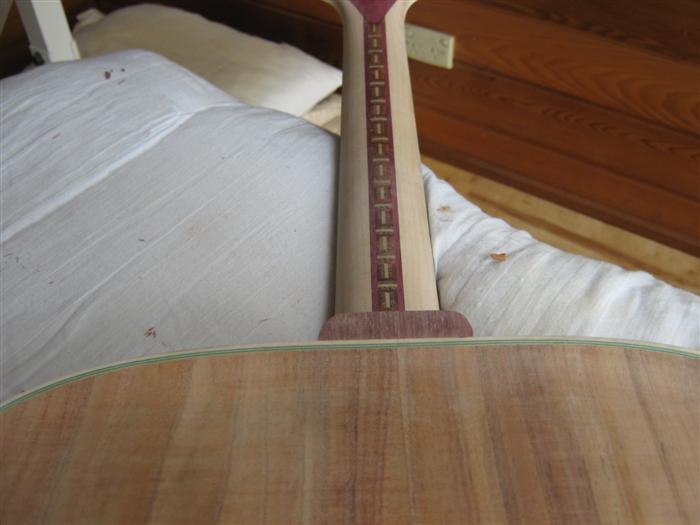

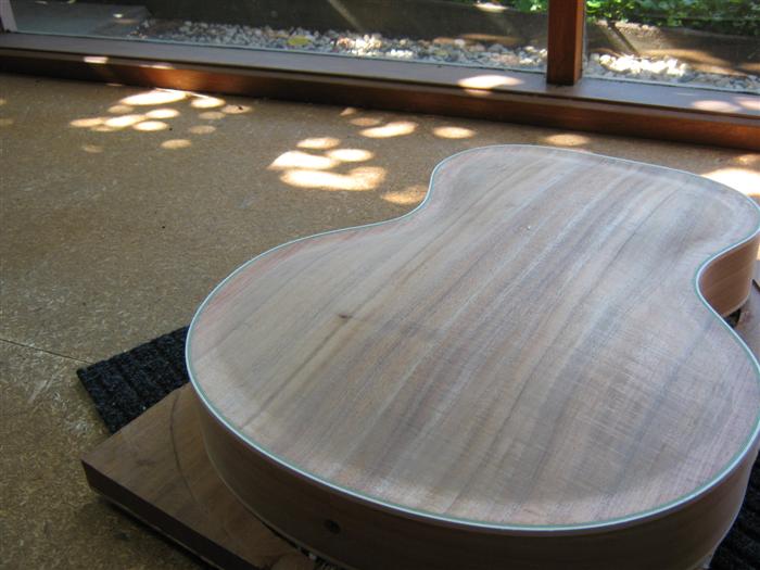

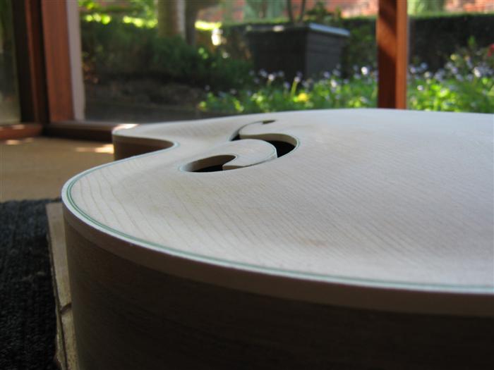

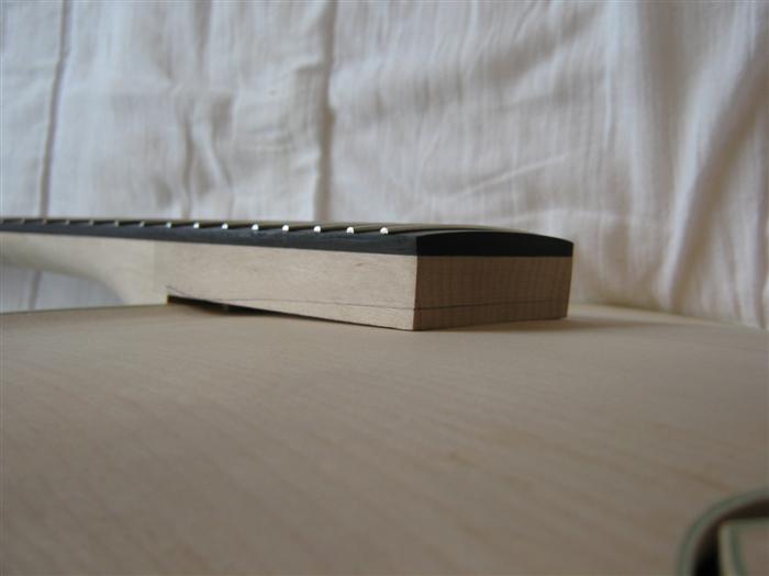

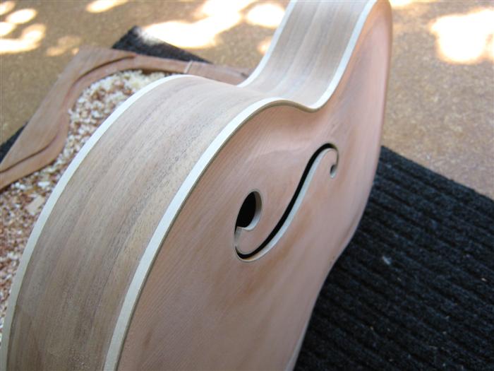

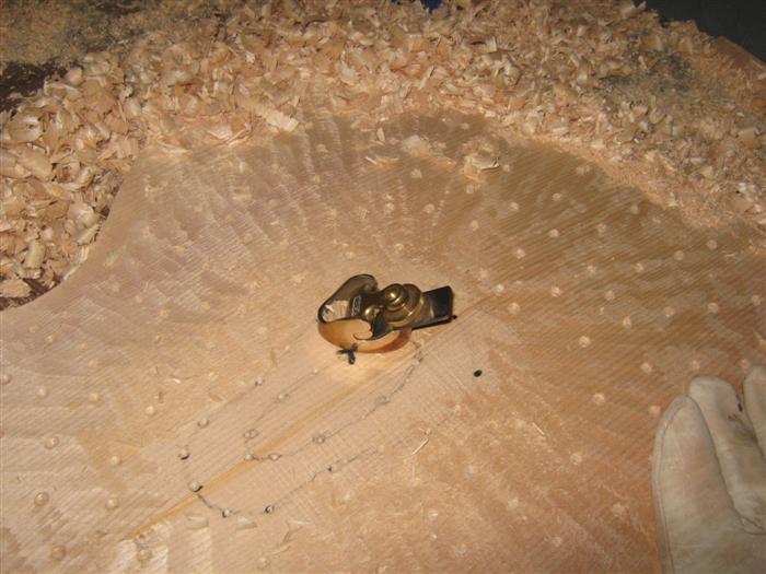

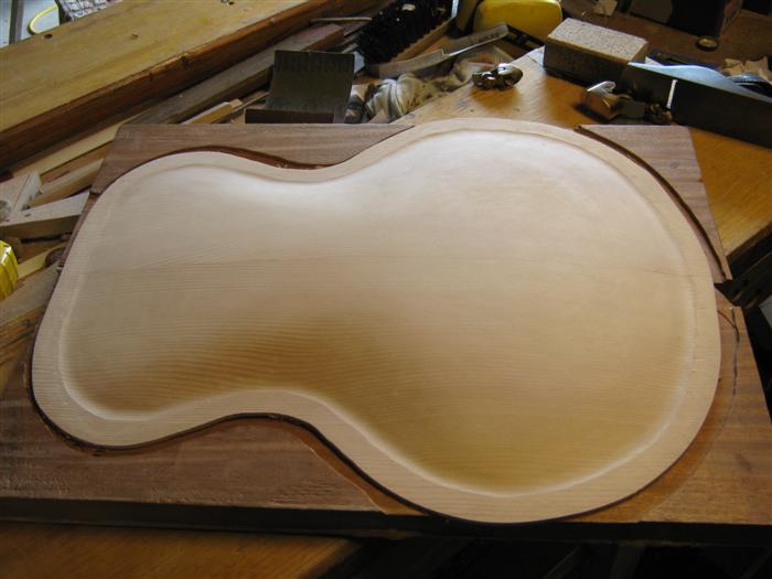

Here's a unit i've been toiling away on for the past six months.
Full bodied symetrical 17" archtop
Spittle blackwood B/S
Sitka top X braced
Curly maple binding
Rock maple neck with purple heart and eucalyptus burl veneers
Getting ready for finish soon.

Such a lot of pics to upload i got them a bit out of order, still i tink you lot will get the idea.
Next time you see this axe it will be in the gallery, and not too long off, weather permitting!!! :roll: :roll: :roll:
Cheers!!

Absolutely beautiful Rocket. I wish I could get my neck to fit a well as your guitar. How did you find the blackwood to carve? Is this guitar having a pickup installed if so, what brand do you have in mind?

Actually i don't have a problem with carving blackwood, the only drawback i find with it is the massive pores you are left with to fill. The guitar will be fitted with a" Kent Armstrong handmade adjustable PAF," mounted via a side tab to the finger rest, volume control will be a thumbwheel arangement that just protrudes from the edge of the fingerest, i think a knob mounted on top is too obtrusive so i'm trying the thumbwheel this time.

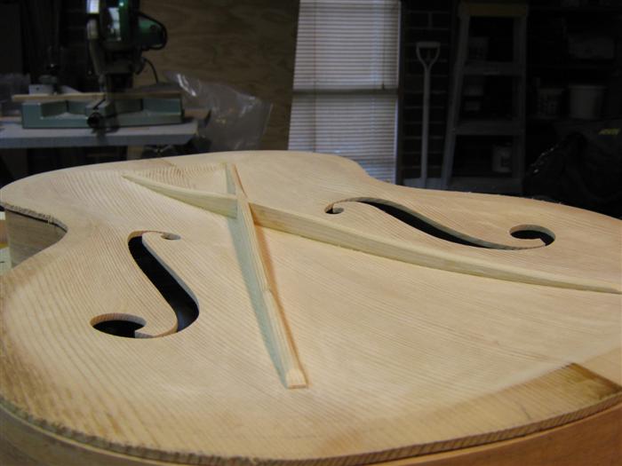

Not following Bob all the way with this one, deleted the side bracing in favour of a laminated side, still 2.5 mm thick but a smooth contour inside the instrument and very stiff sides.
Cheers,,,,

Very nice Rod, the violin ff's are a nice touch.

Real nice carving you don did there Rod...real nice.
blessings
duh Padma

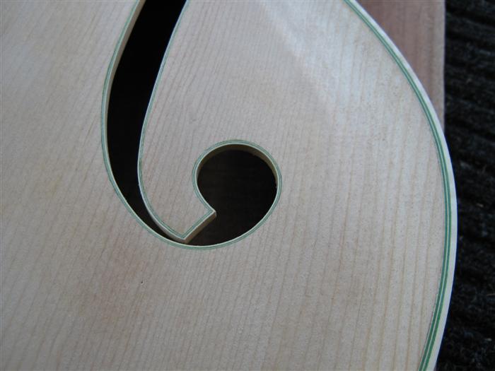

Is that your normal F hole pattern/size? Just looks slightly bigger than normal so I'm interested to hear how it sounds, I so far haven't strayed from the "standard" F hole with mine, according to Bob B the surface area has an affect on volume so I'm keen to hear your findings. Also think I like the sweep look you have rather than the traditional 'pointed' look.
Re: Another aussie built archtop
Post by rocket » Fri Jun 10, 2011 2:05 pm
Pad,, I'll take that as areal compliment coming from an old school carver like yourself!!
Nick, those F holes are a different to the ones Bob uses, i have a couple of different shapes i like to use .
As far as size goes this particular one is a little bit greater in area than Bobs design but i designed it that way to compensate for the slightly larger volume in the full body box.
I've built this style before, you can see it here. http://www.youtube.com/watch?v=wdvJX-4g_bU
Cheers,,,,

A really nice shape. Yes, maybe the f-holes do part of the trick. These here are just like big beautiful eyes. But of course also everything on this build is so neat and smooth - flawless, at least to my eye. I really like this one.
